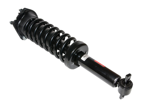

You're going to save a lot in labor cost by finding a shop that will install a loaded shock/coil spring assemblies.
I replaced my suspension last winter using Gabriel Ultra assemblies from RockAuto. If you're going for an OEM replacement, that's something to look into.

If you're looking to keep your original coil springs I can see it becoming more labor intensive but you can buy replacements which already have the coil springs installed. Removing the strut mount from the strut is where it can get problematic but if the mount isn't rusted and pitted all to hell then it's not too bad of a job if you have the tools or be able to rent them from the local parts store. I ended up replacing the factory strut mounts on the 99 Camaro with some made by MOOG and went with Viking coil overs and a 300 lb rated spring. Glad I went this way too beacuse you can adjust the ride height.

Are you going back with OE replacement parts? Prebuilt front struts? Anyone with a jack and a few standard tools can do the install for that.
