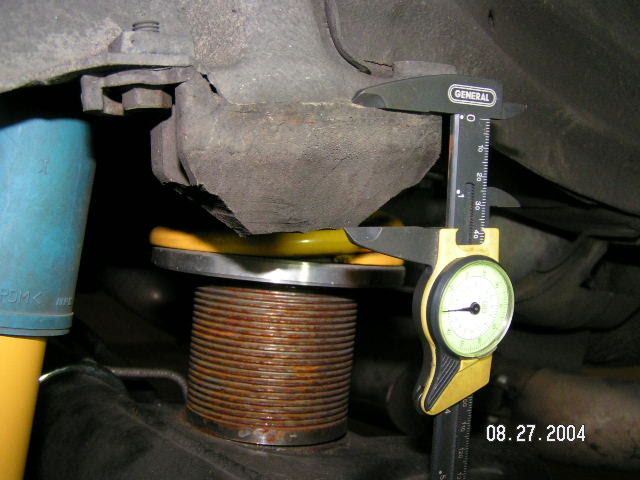

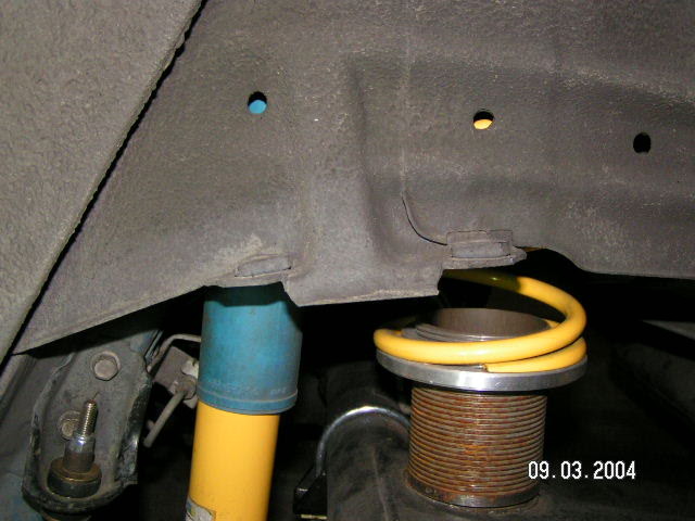

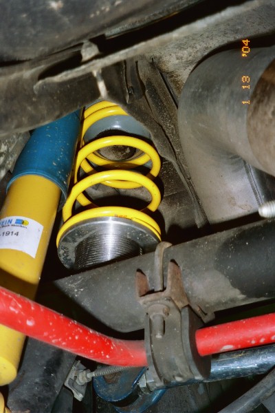

Hmm, no pics, but I'm currently using Afcoil 5x8x300 (bling!) yellow race springs in the rear, sitting on Allstar 56119 weight-jackers. Effectively it looks like the pictures in these links (courtesy of Jon Aadland), except I left the upper spring mount installed. The first pic is comparing his used Ground Control setup to the new setup.
http://www.jonaadland.com/NewPics3/Allstargc.JPG
http://www.jonaadland.com/NewPics3/Allstar1.JPG
http://www.jonaadland.com/NewPics3/Allstar2.JPG
http://www.jonaadland.com/NewPics4/StockCutStop.JPG
http://www.jonaadland.com/NewPics4/S...topRemoved.JPG
http://www.jonaadland.com/NewPics4/StopOnCar.JPG
http://www.jonaadland.com/Z28/Mods/LCA/LeftLCAOutbd.JPG
http://www.jonaadland.com/Z28/Mods/LCA/LCAPHBL.JPG
Springs are a bit stiffer in the rear because we've both lowered our PHB. What condition are you trying to solve by using coilovers? I would say they're not worth the coin or time unless you know you'll need to use the adjustability, setting corner weights, etc.
