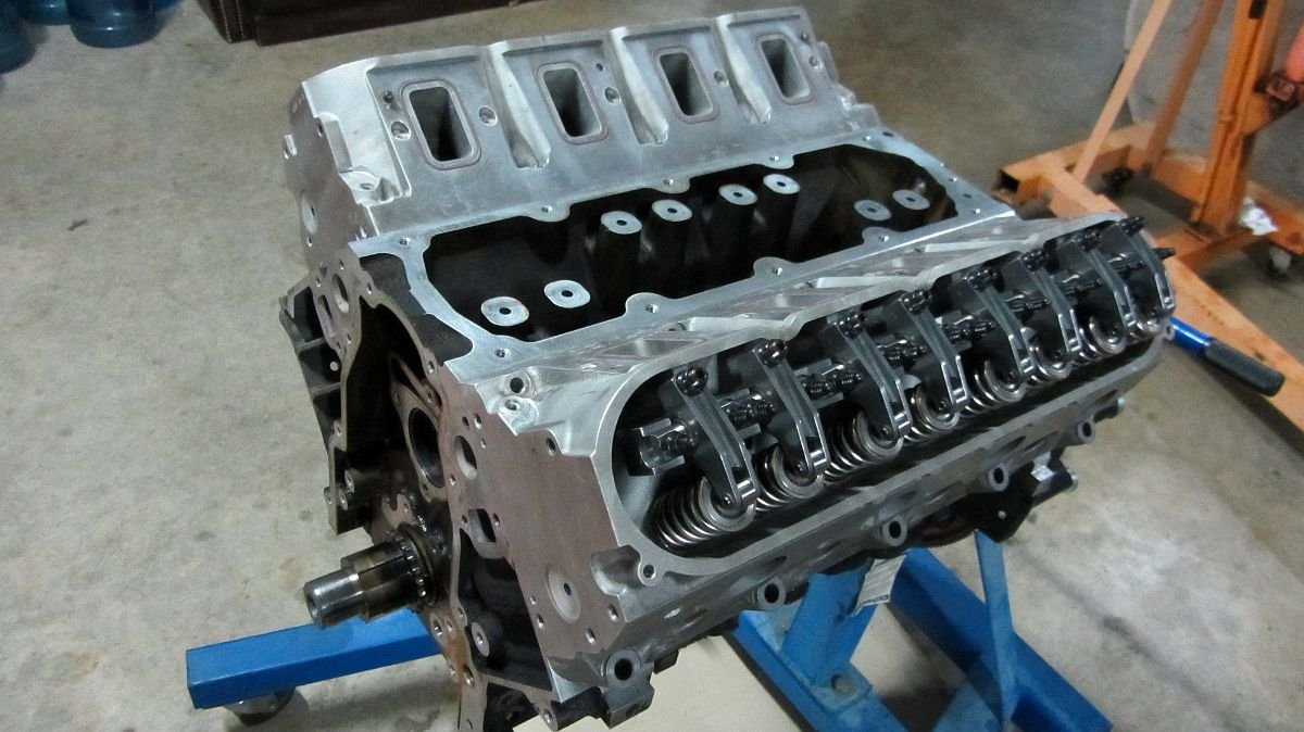

Putting together an aluminum block LS2 short motor (58x) for my Camaro right now. All the little things definitely add up plus I decided I will pull the crank and swap reluctor to 24x so I will be adding new bearings etc to the list. And i still haven't decided how far to go with the short motor after the crank is back in, whether I buy forged rods or reuse the stock rods/pistons for now. I ordered .927 pin forged dish pistons but might put them on hold for later on when add boost, and keep it SBE for now with my smaller 224/232 cam so no valve reliefs needed.
Also when I remove the current ls1 from the car I will use as many parts off it as I can, oil pan, windage tray, ATI balancer, SFI flexplate/arp bolts, etc and swap them over to the LS2 before it goes in.
Just some expenses so far related to the swap and I have a lot to go because I'm putting my small bore LS7 heads on it. This is what I've bought so far related to just the swap over to LS2 (in aussie dollars) some parts cost a heap over here lately because our currency has dropped plus shipping/taxes.
Good used LS2 short motor (58x) - $1100
New GM 04+ head bolts + new GM 6.0 head gaskets - $205
New Rollmaster LS2 1x trigger double timing chain - $175
New ARP Ls7 extended length balancer bolt - $64 (for my ATI non-a/c ls1 balancer which uses a weird long bolt, I don't trust the old bolt ATI supplied as ive used it twice already)
New Cam & MAP sensor extension harnesses (ls1 to ls3) - $100
New improved racing Crank scraper (old style new old stock) - $213.10
New Felpro rear main seal - $51
New checking pushrods - $60
New GM Valley Gasket - $59
New ARP cam bolts - $25
After arrival and cleaning it up some..
Cam, lifters, chain and balancer removed.... and first test fitting my LS7 heads rockers and intake. I will be happy with a low 10 second pass from this as is with the little cam. I think it should do it

Are those like aftermarket LS7 heads designed for a small bore? I know you can bolt LS7 heads onto an LS2 but they are for the larger 4.125 bore block.
Old Jul 19, 2019 | 10:35 PM
Launch's Avatar
Joined: Jan 2003
Posts: 1,000
Likes: 134
Yeah they only have 2.10 /1.55 valves. They ran them on Daytona prototype cars first with 3.900 bore and then 4.075 bore, with the same heads/ valves. All they did was rework the chamber a little for the bigger bore when they moved to the larger 4.075 bore blocks. I could have fitted and used them on an ls1 block at 3.905 bore but because they opened up the chambers a little on these for the 4.075 bore engine they were used on, and the valves are so close to stock ls1 bore (barely no clearance when I measured) I though f*ck it and bought an LS2 to use them on instead. These won't be a problem at 4.00 standard bore and I don't have to hone the block. I like the factory machine work, this one is low miles I don't have to mess with it. If I had used an ls1, I had to hone it to 3.905 and buy pistons then it'd still have the chambers over hanging the bore. With the 4.00 bore it's good enough as is plus I get a few more CI's. 364ci not a stroker, just have to spin it and I have a 8" 5500 converter for it.
