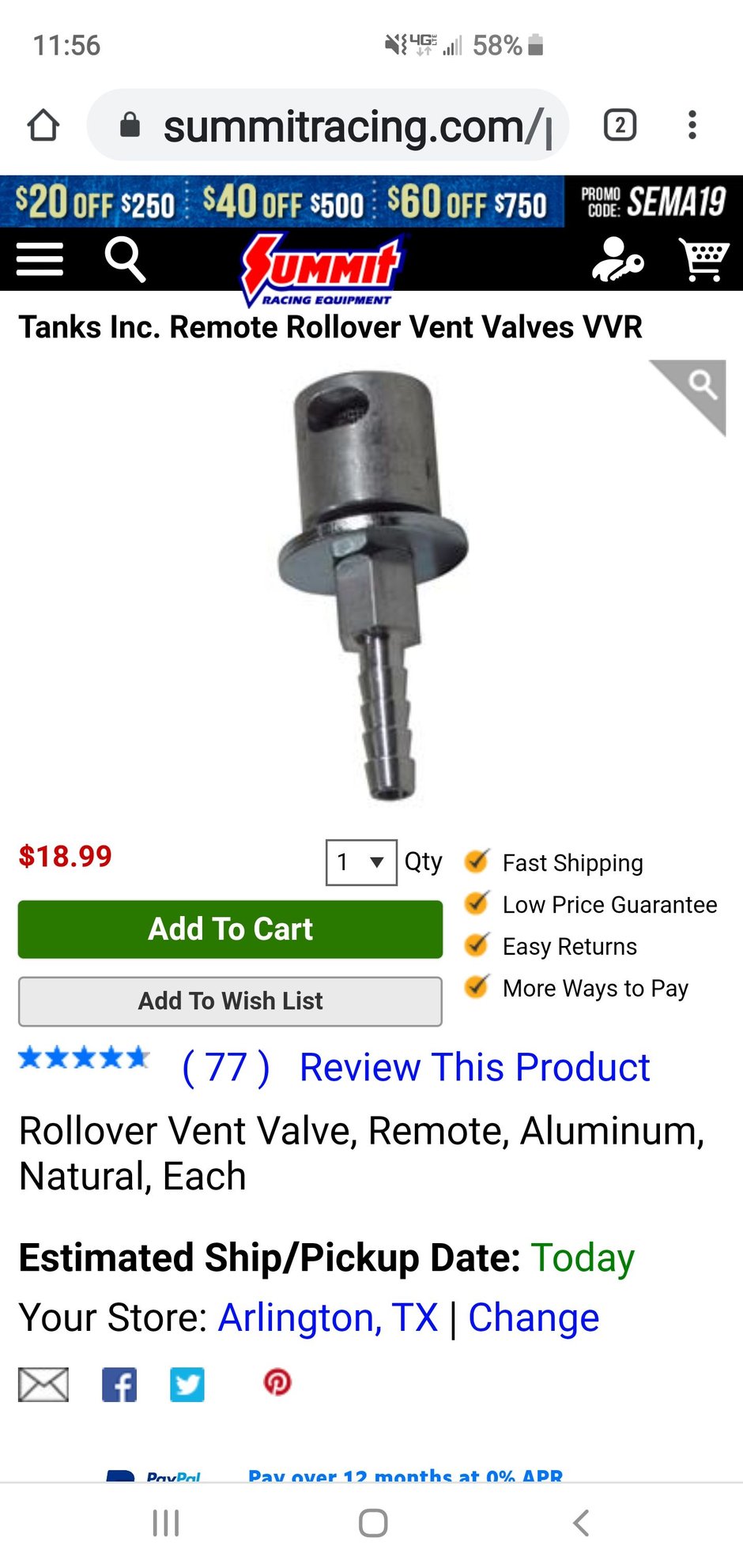

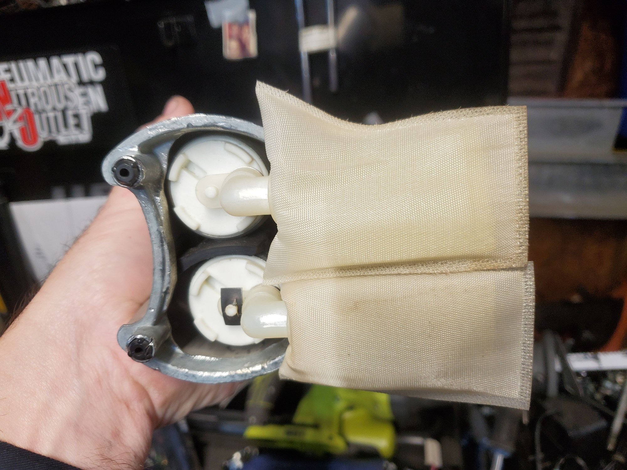

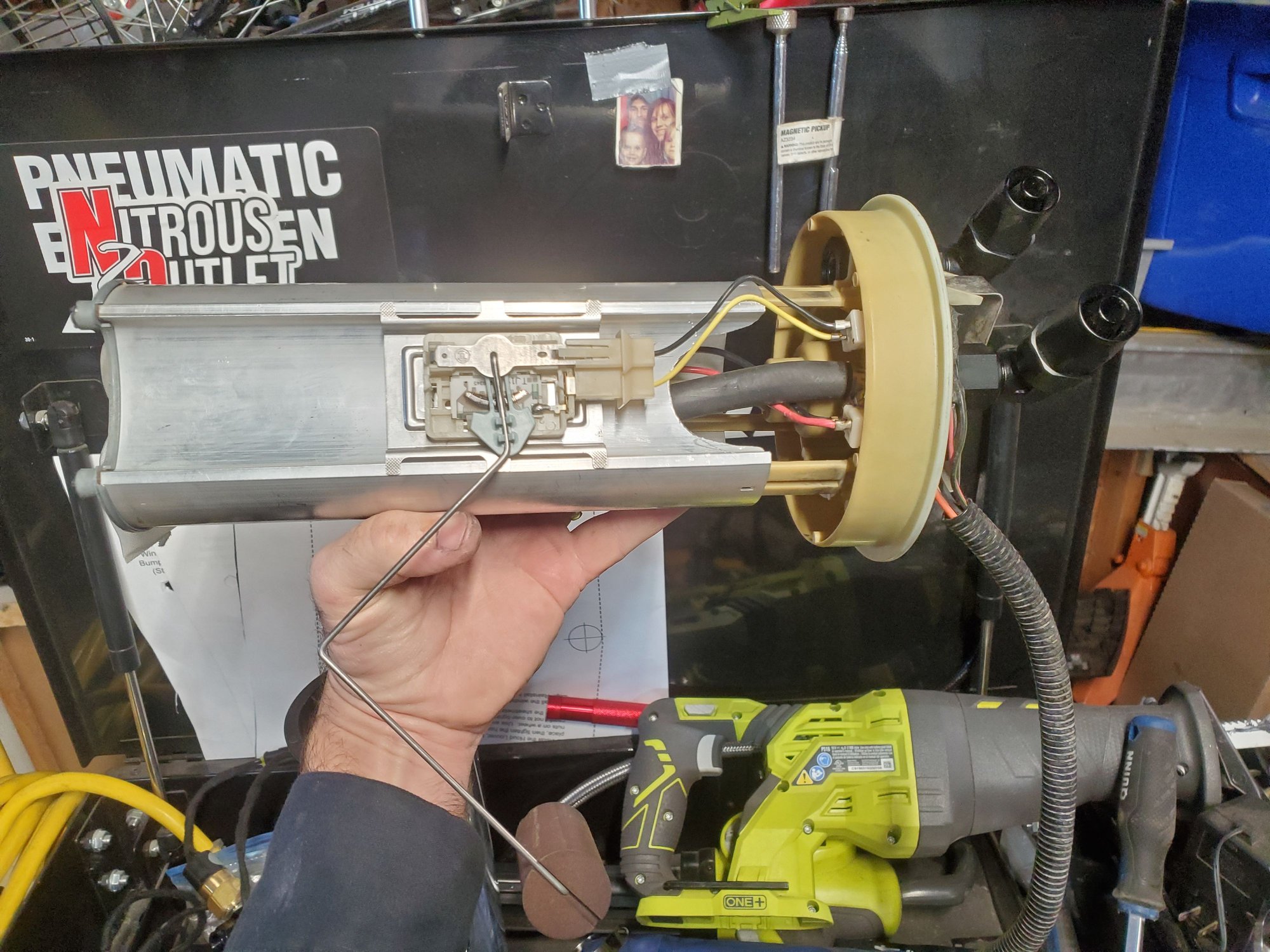

Working on the TJ a little today. Put together a twin walbro for the tank (mightymouse style) and ran -8 feed and return with inline filter, new regulator and digital pressure gauge. For the vent I used the old fuel line barb and a roll over vent inline.
Question: has anyone had any issues with these vents?
Tanks Inc. Remote Rollover Vent Valves VVR

Tanks Inc, where I get all my fuel injection gas tanks provide that fitting with all the tanks, no issues from them
