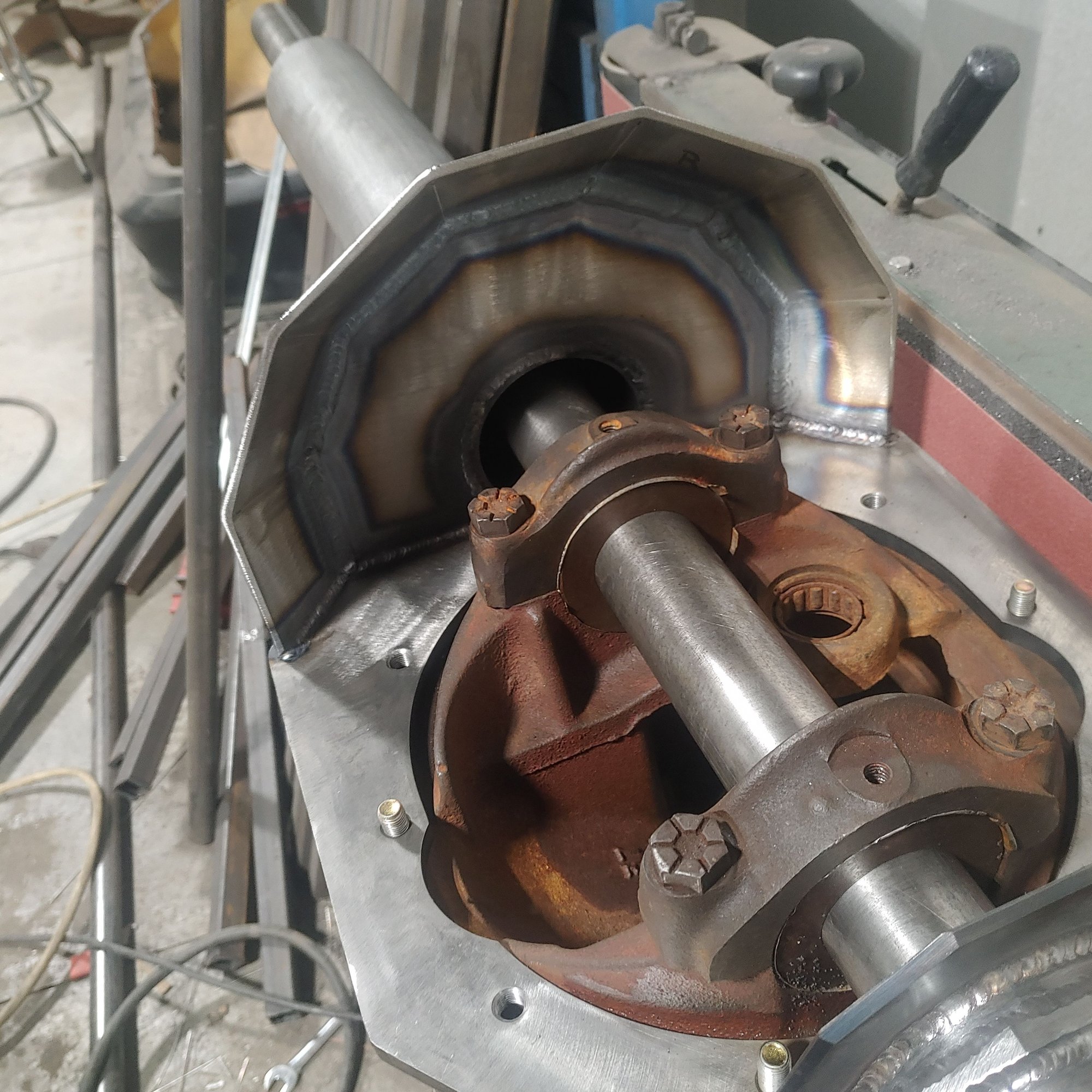

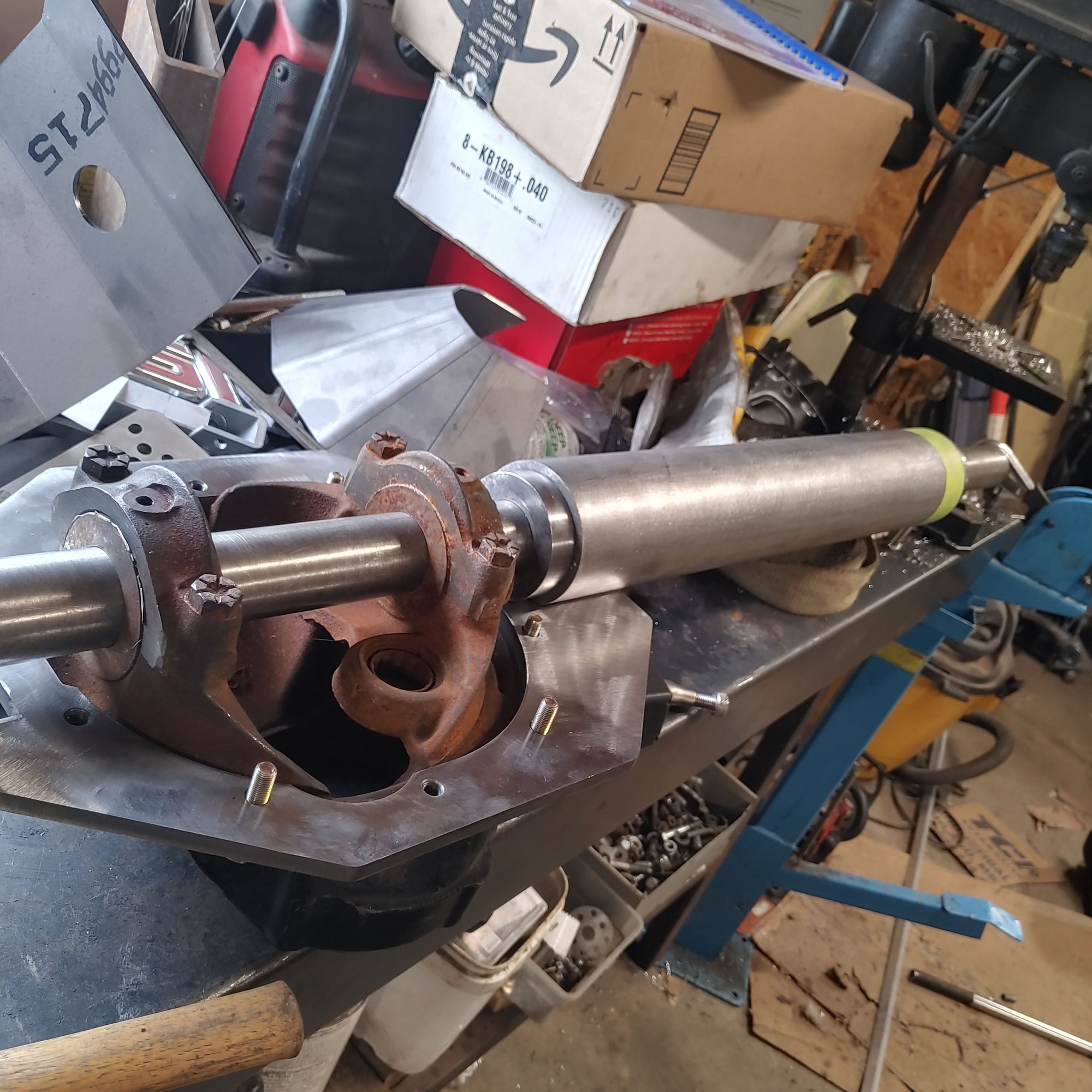

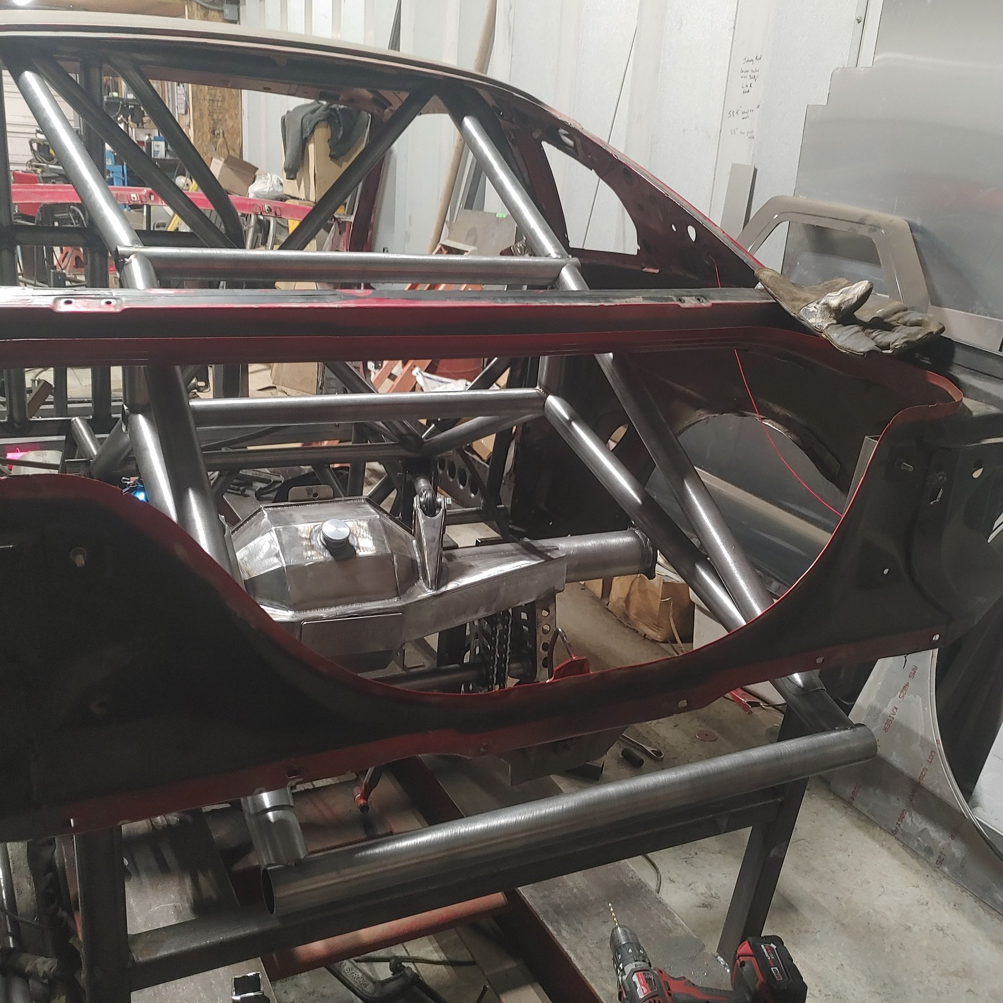

Ive had the pleasure of being resident fabricator on this mustang for a few years as it has went through it's transformation.
This time it's in the shop for a major update. I built a sheetmetal stock suspension 9" housing for it and am in the process of building an SFI 25.2D chassis that will certify to allow for 6.0 second 1/4 mile passes
Ill keep the pics coming as progress permits

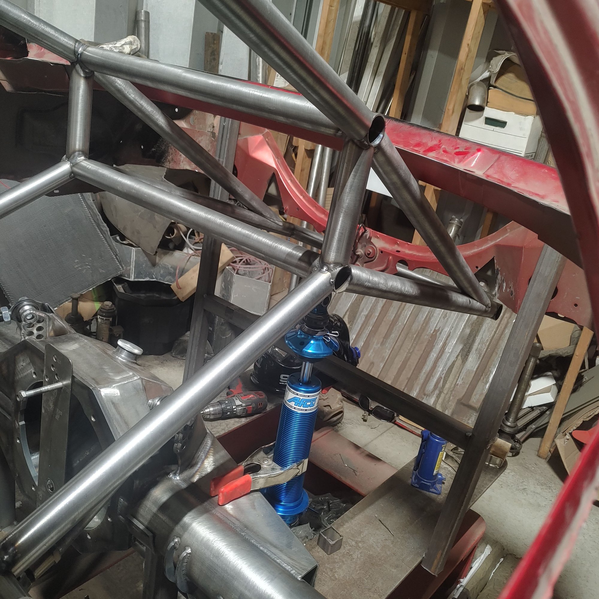

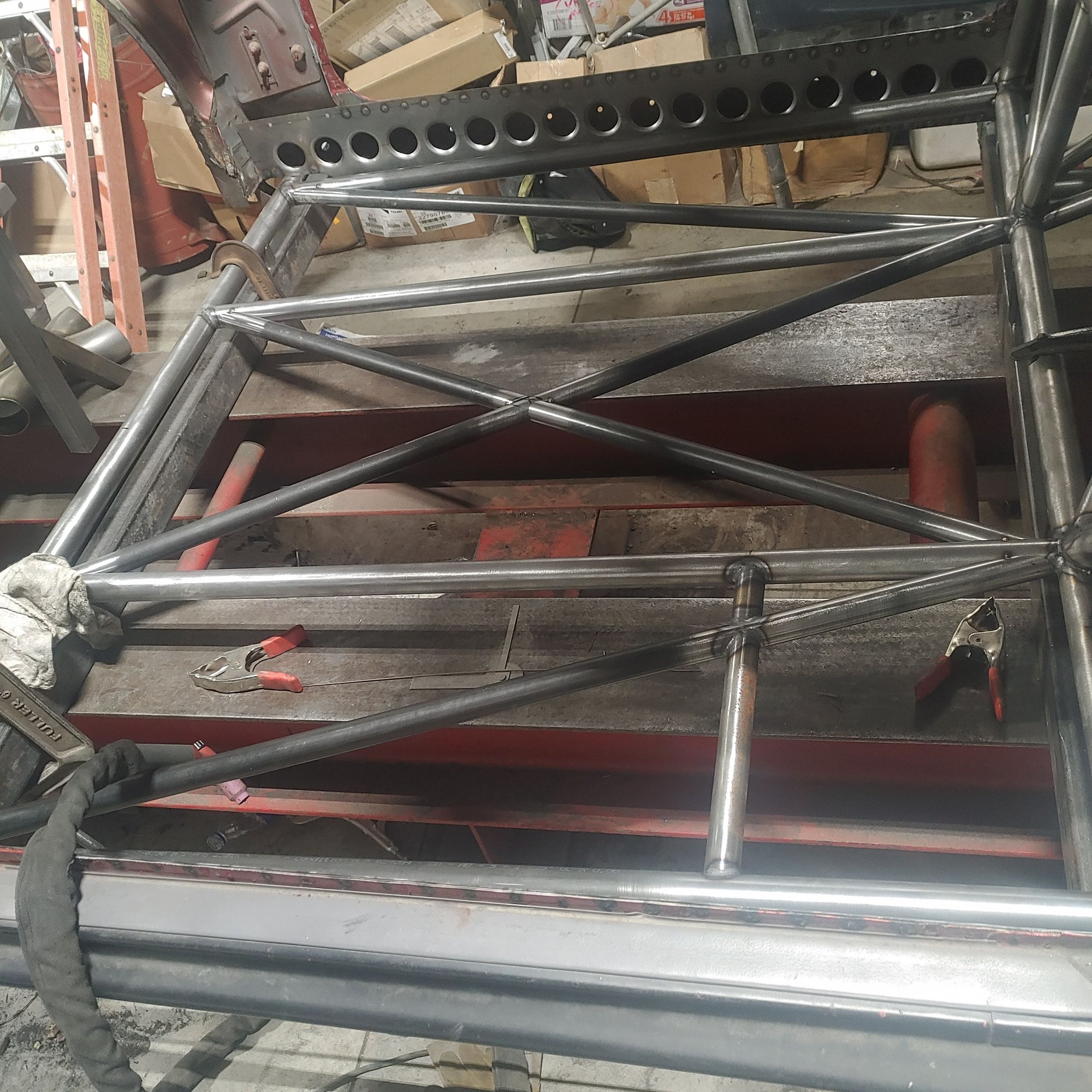

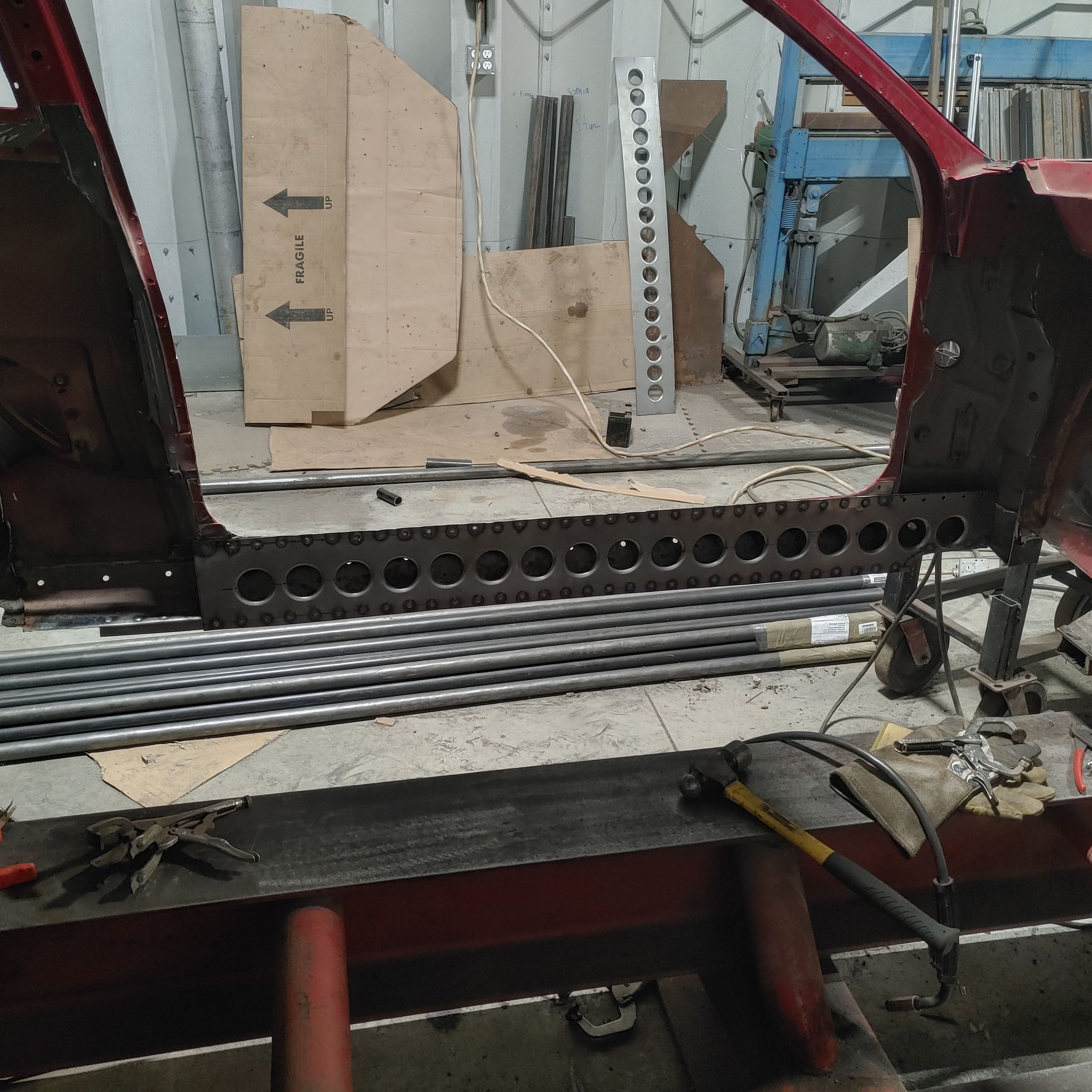

More bars
