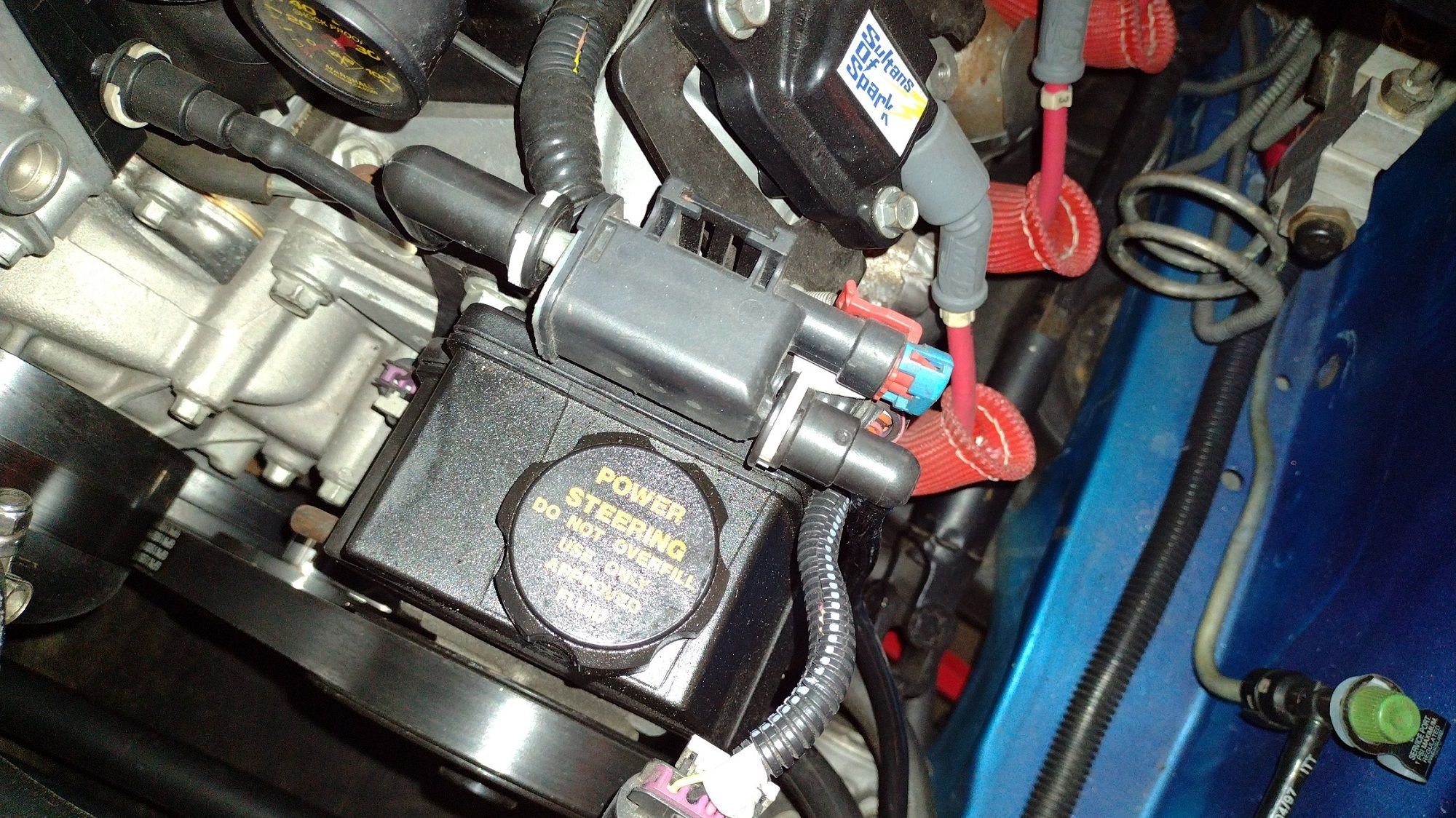

Haven't tried it on nylon, but i have on those black GM lines. I used a heat gun with some foam shoved inside. Biggest issue, the GM lines collapse really easy if you use too much heat or less heat for too long and by too long i mean just a few seconds, but i was able to form quite a few bends. I also swapped some quick connect fittings by heating the ends and shoving the fitting on. Example below, evap solenoid.
Awesome. Looks good.
Luckily, the vacuum lines that I have are nice and thin and I was able to form them just using heat. I had some mandrel bent tubing laying around, so I taped the lines to the tubing and heated them up gently. They relaxed to form the bend and then held the bend when they cooled off. I didn't need to add anything to the inside, luckily.
