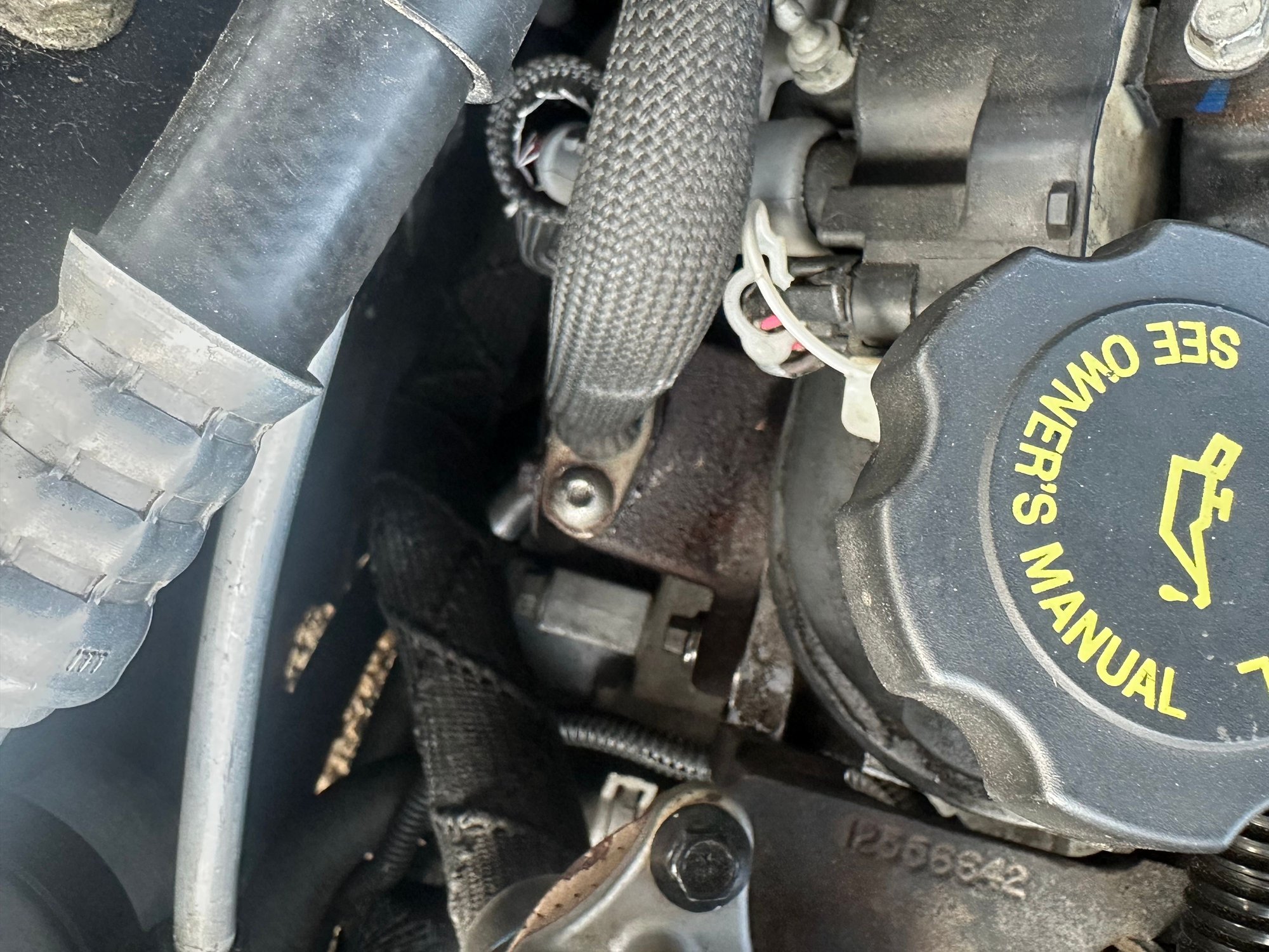

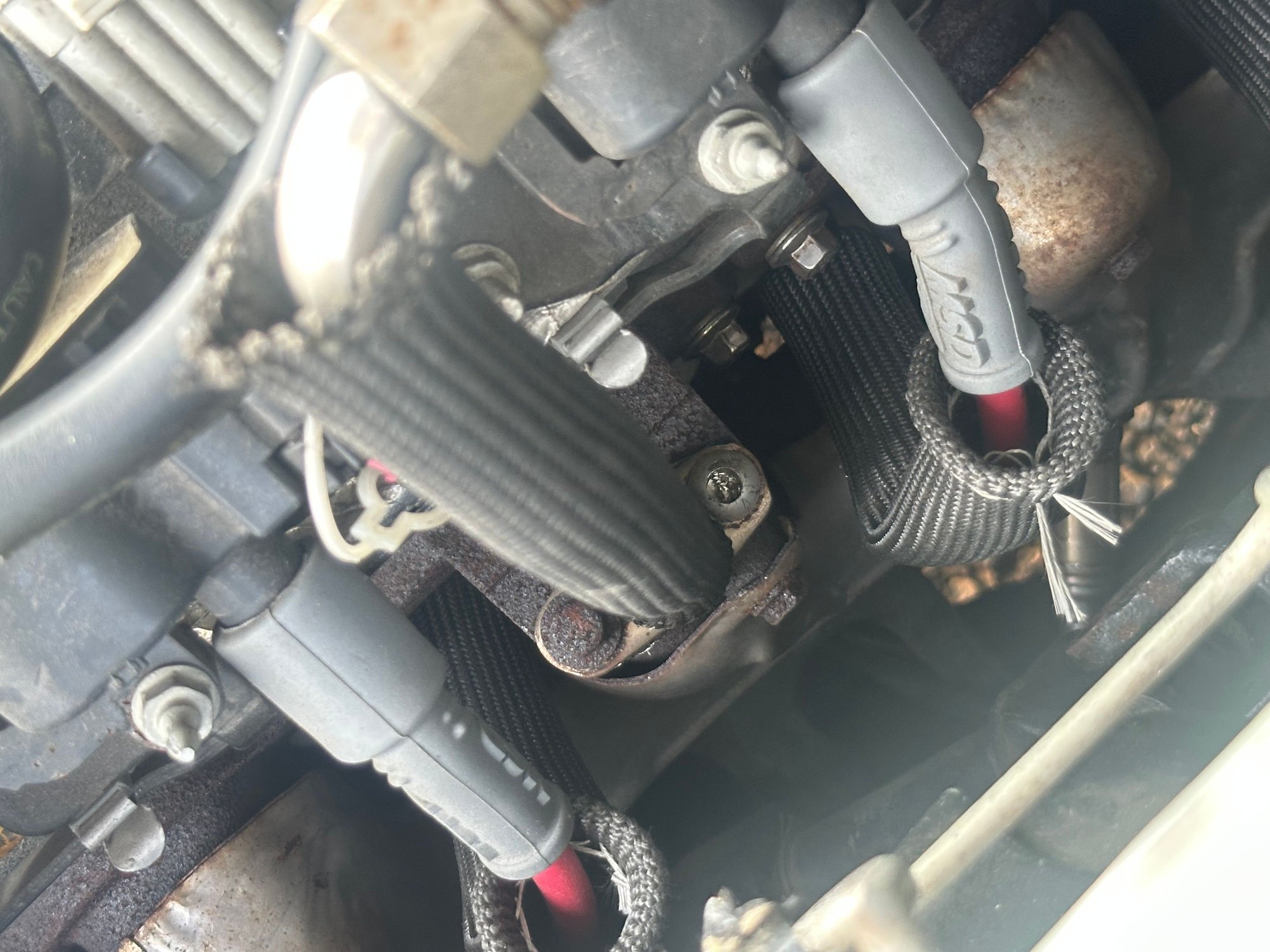

Hi I have these stripped bolts on the header manifold I can’t get off any tricks I can use to remove them?

10 different ways you could attack those with positive results with plenty of YouTube’s videos showing you how.
whatever method you go with hit the bolts a few days before with penetrating fluid. Spray em in the morning, mid day and before ya go inside for the night.
Worse case, cut the head off, hit it with a center punch. Then drill and tap them out.
