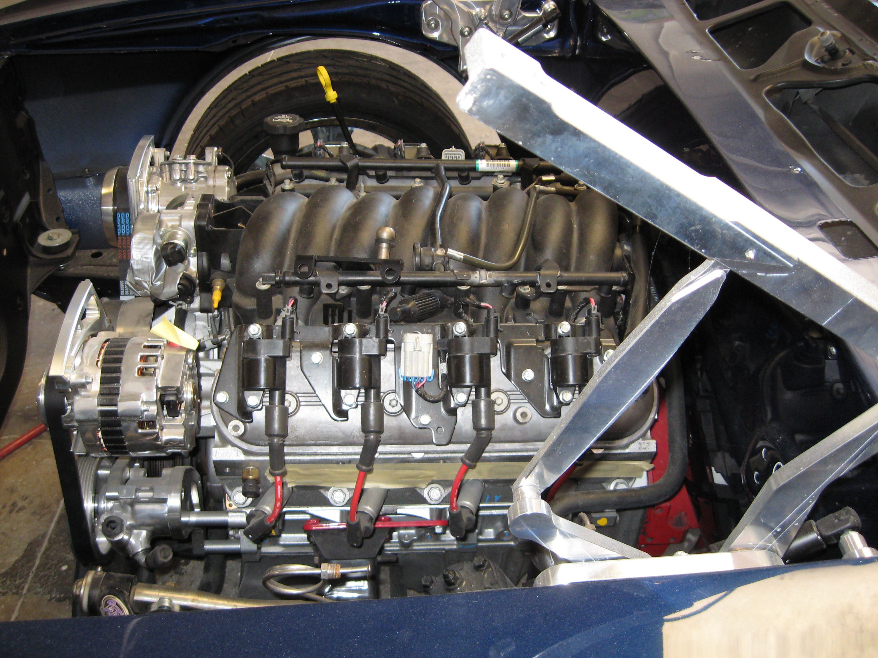

I did one in a 67 camaro. Used Vetteworks motor mount plates. They put the motor mounts in the stock location.
