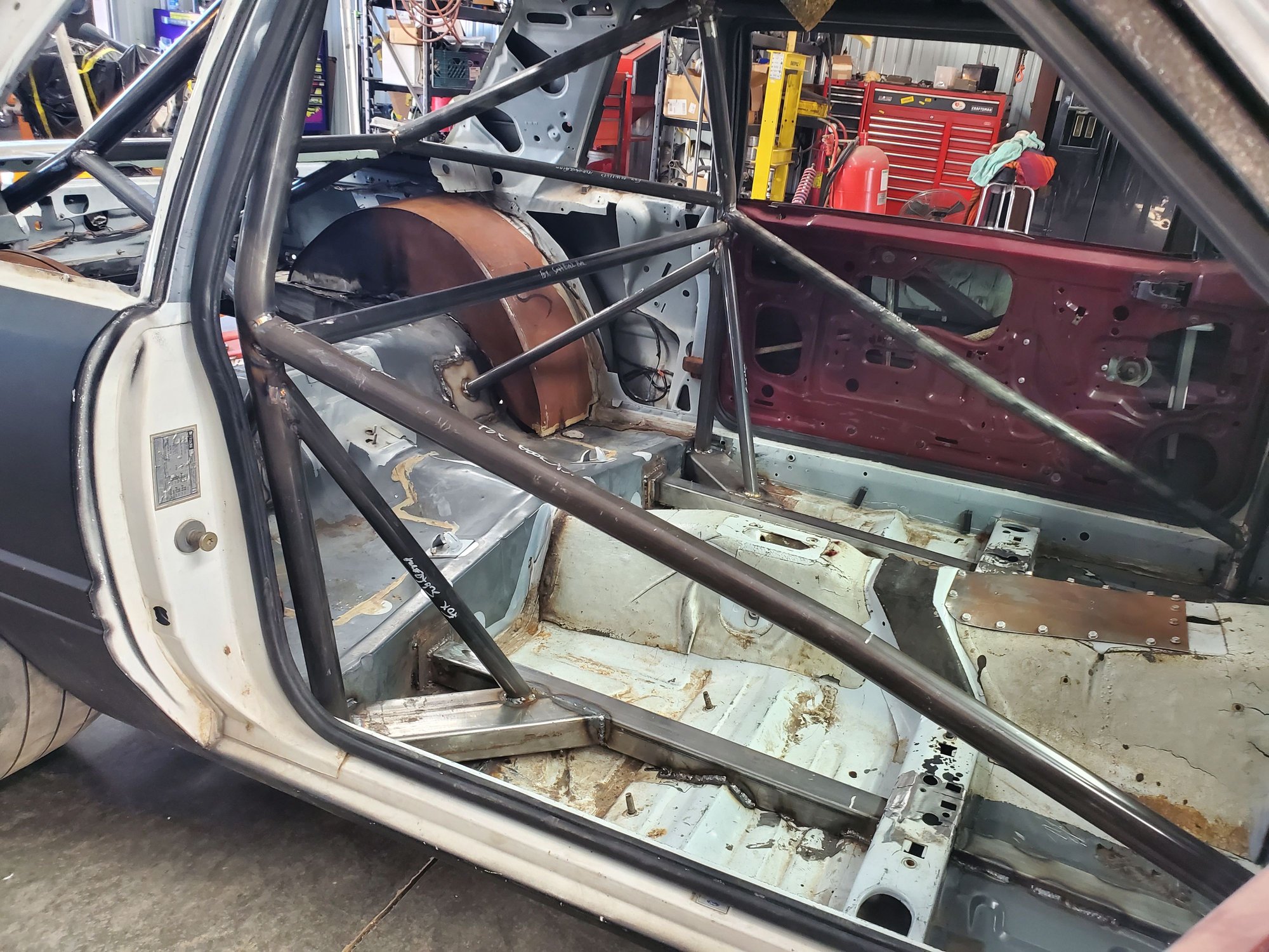

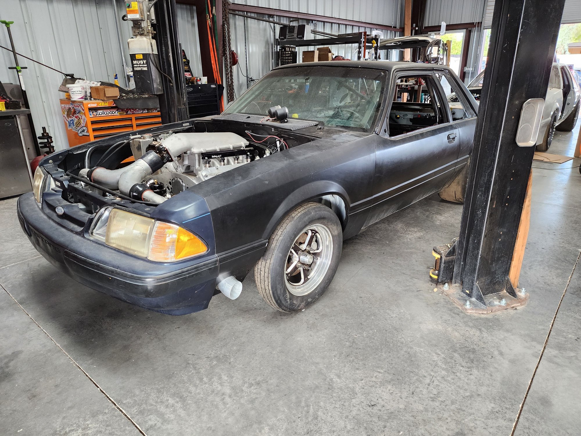

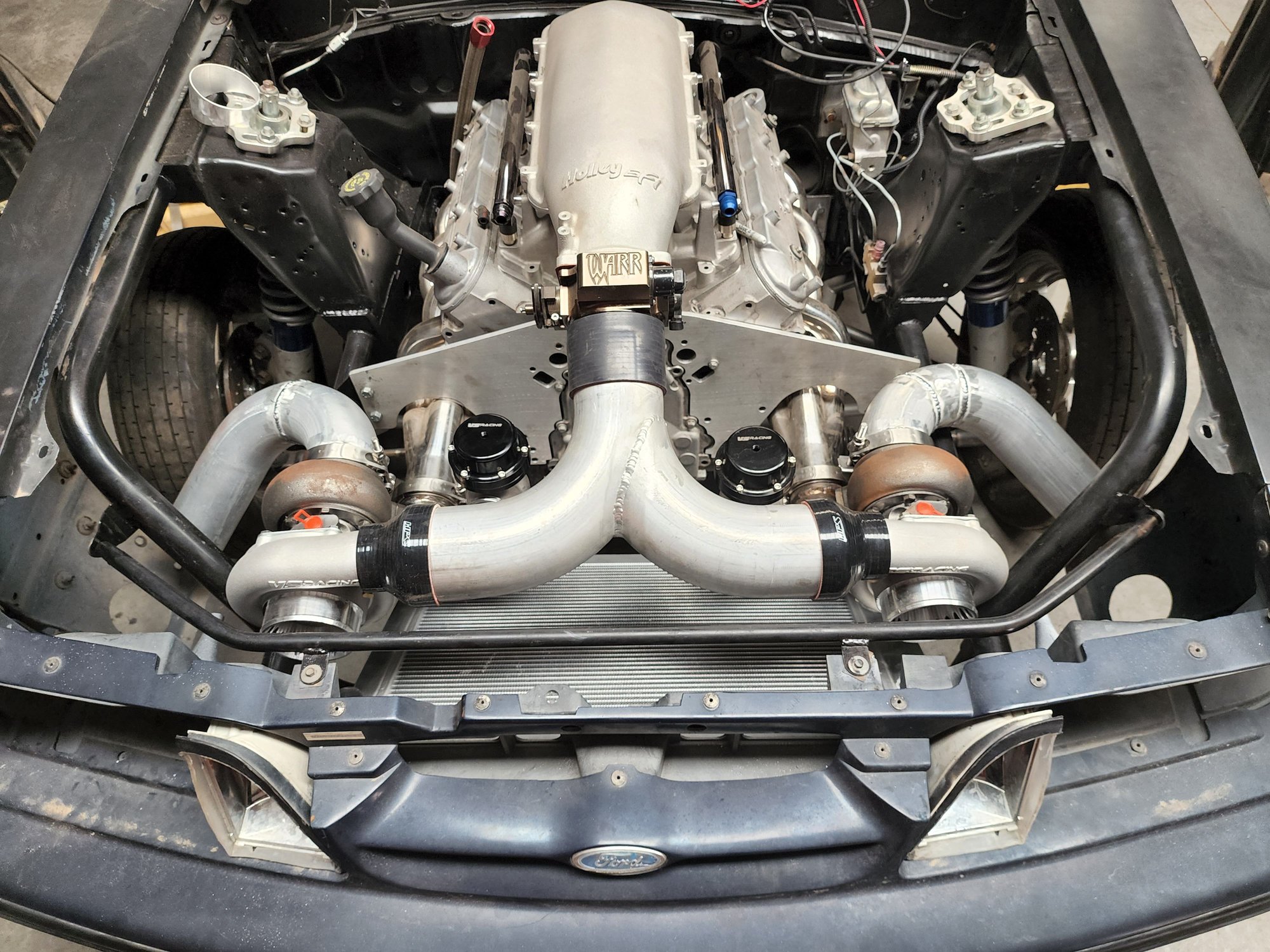

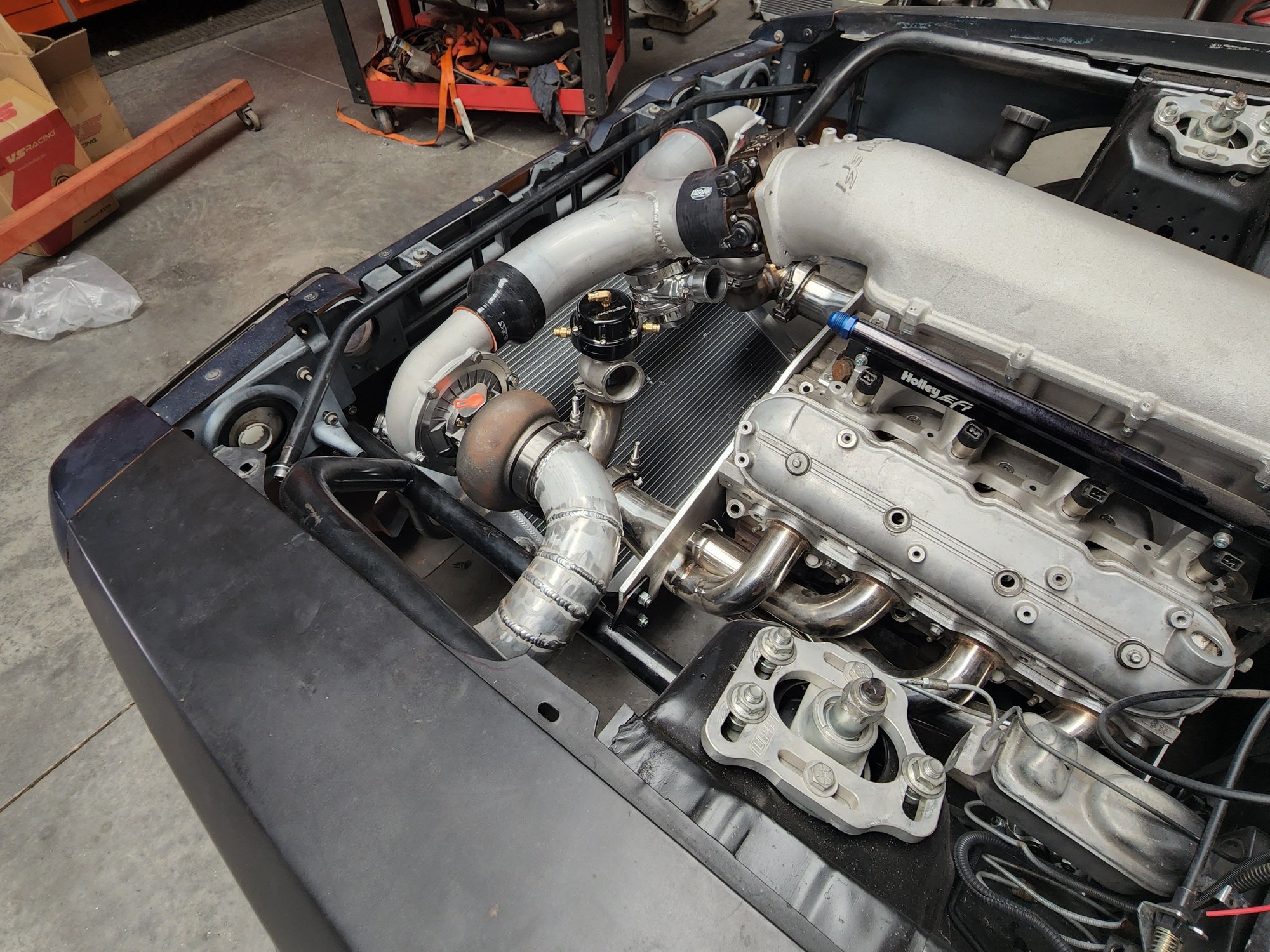

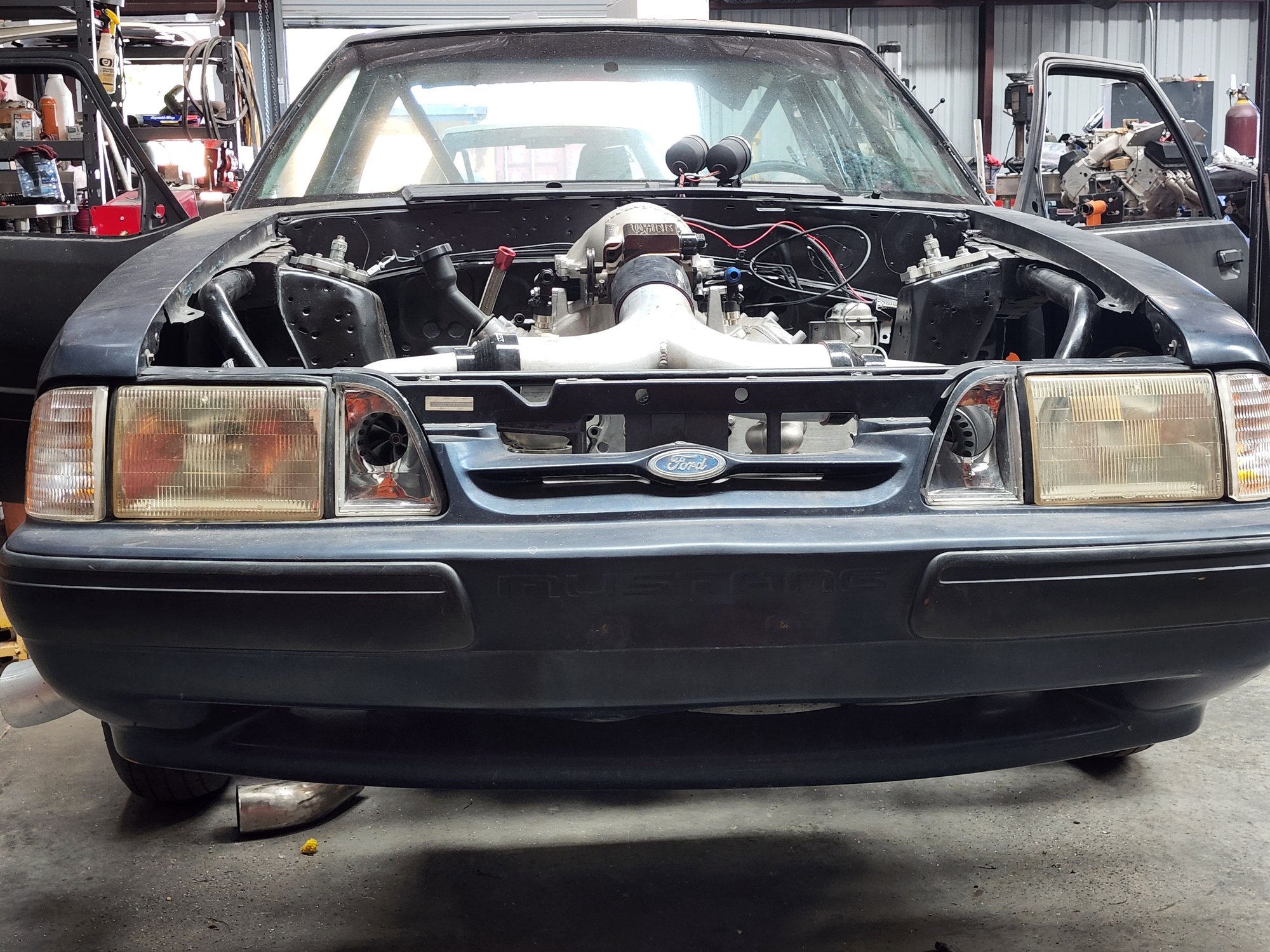

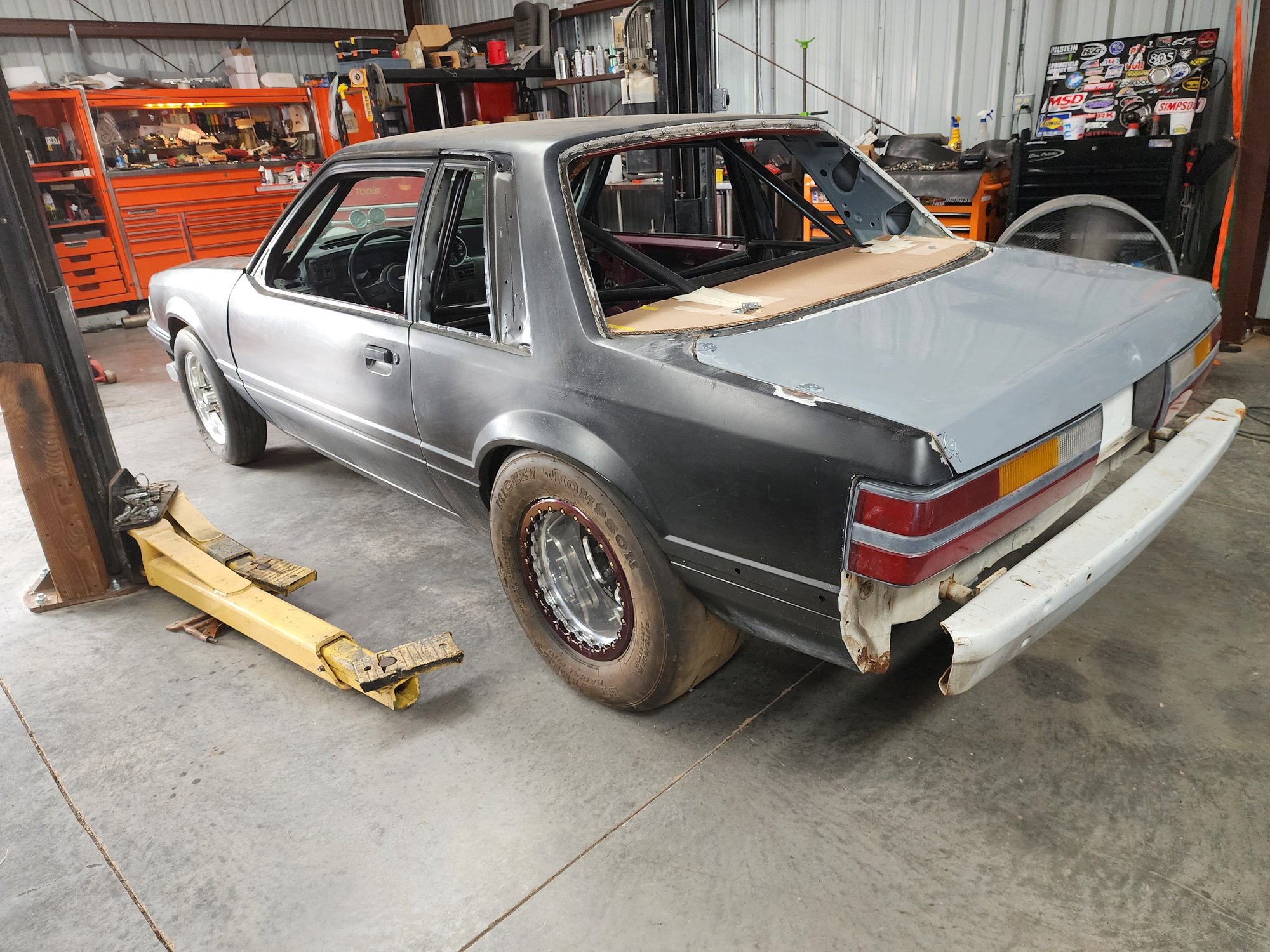

New here. Mainly a ford guy but doing a ls mustang out of the 85 for drag racing. Seen a bunch of people were having good luck with this direction. Currently 5.3. 317 heads full chassis, power glide with 1.80 gear set and a 3.90 rear gear.. all set up for street 1/8th mile. Making it as light as I can with what I have. Had some old wheels off a previous car. My 19 year old daughter will be running this. So im sure I will detune it. Already have the holley hp and the twin 67mm turbos

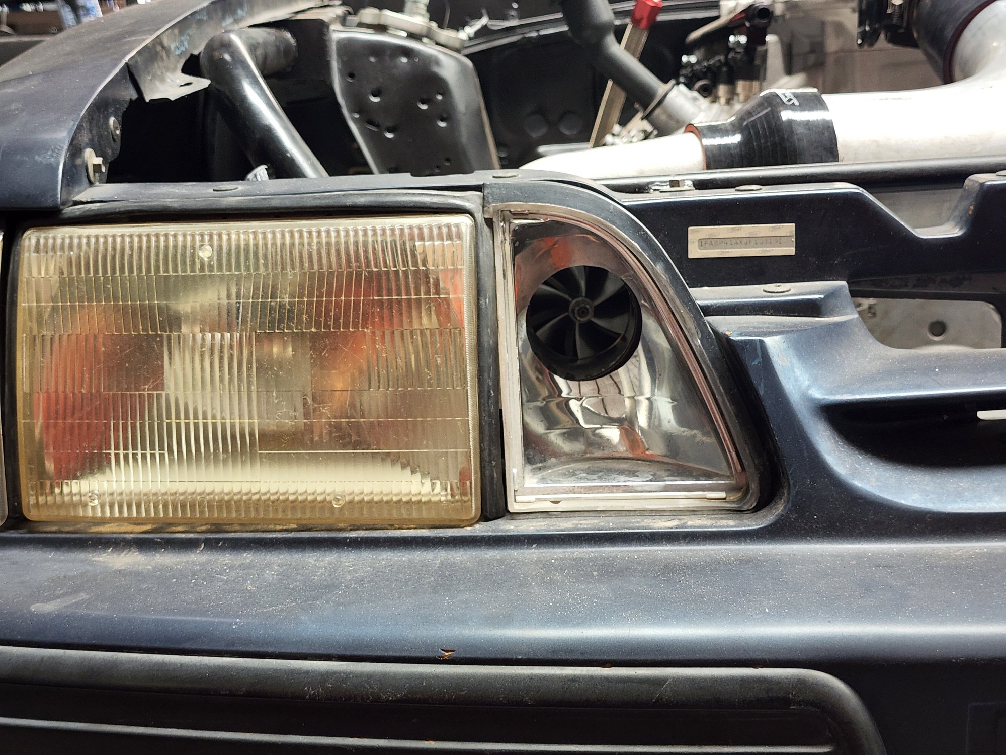

Peak a boo
Figured a little ram air would help

Nice mooostang
Post this up in the forced induction section.
