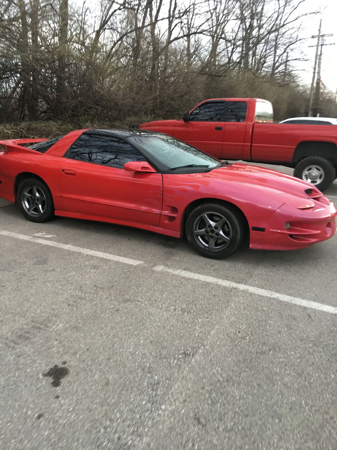

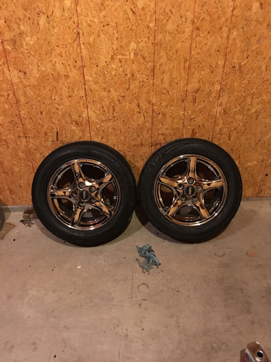

Just got a 1999 tran am and I want a wide or deep dish wheel for the back of the car and kinda deep for the front and I don't know what size to get or what size tire to get? Could someone plz help send pics and details about what you have or what I should get and what style...this is the stock wheels on it thanks!!!

Putting "old school, deep dished" wheels on that car will be a bit of a challenge. The suspension geometry and wheel wells were set up around positive offset wheels, so deep dish wheels will stick out too far, and put the tires in contact with the body work. On the practical side, you might be able to go with a wheel that's an inch, or so, wider in the front, and an inch and a half-two inches in the rear, but that's pretty much it.....
