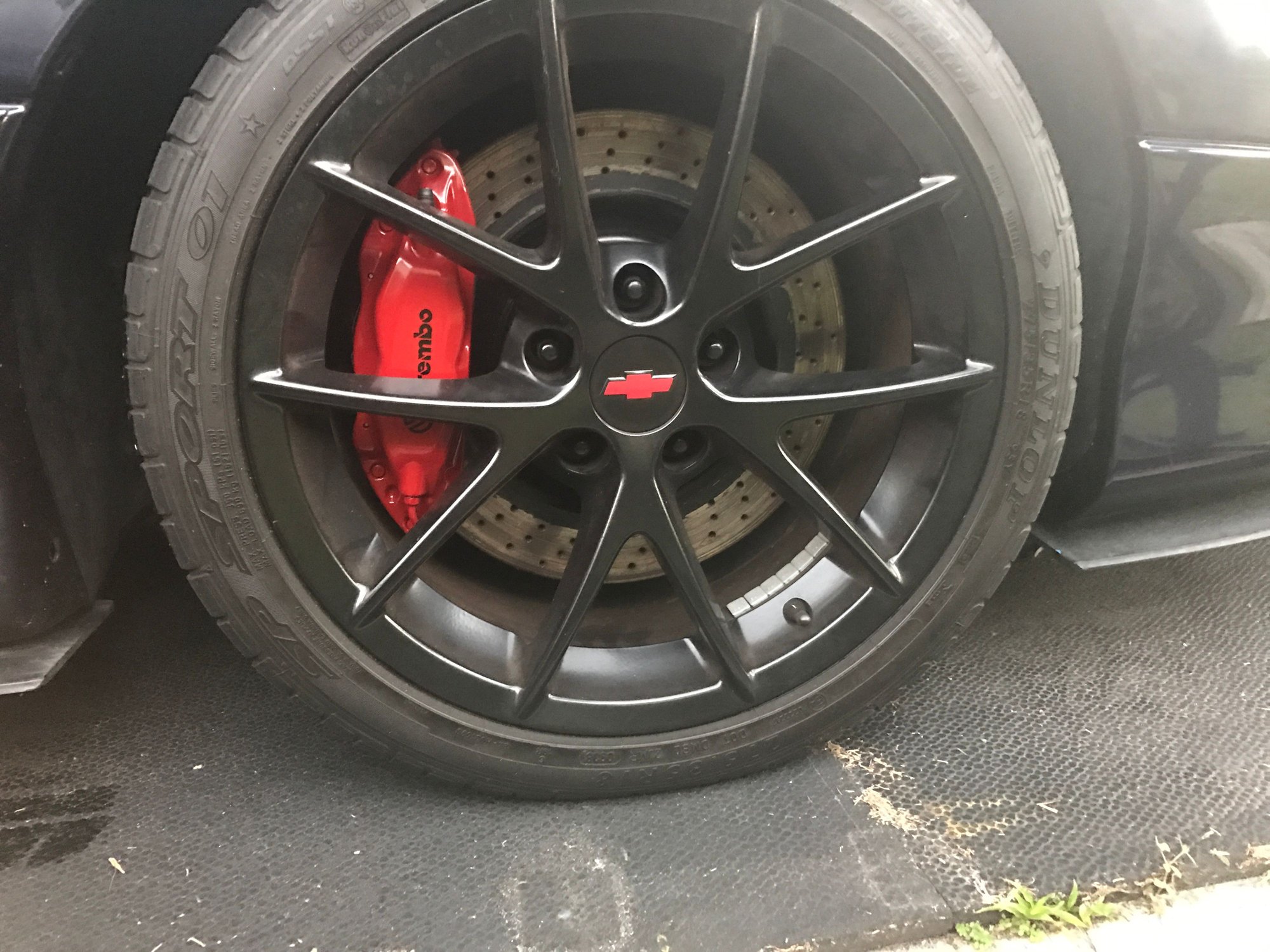

Originally Posted by Matt45
What wheels are those? Looking for a set for my ss
These are c6 spider spiders…I loved the wheels but love needed a new setup for my widened rear

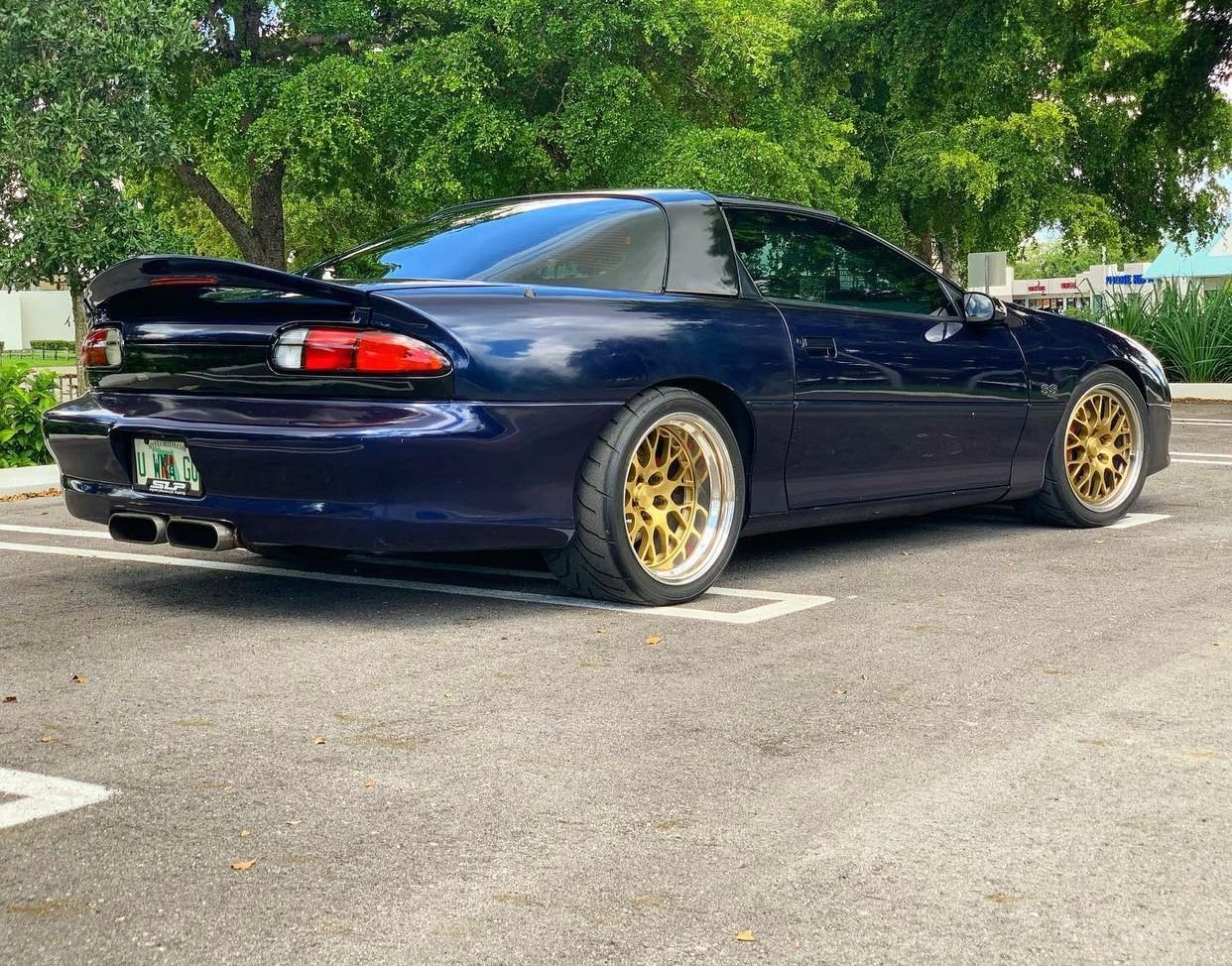

I ended up going 18 all the way around, I think 17 are too small, especially for my brake set up . I did like the fact that there are more options if or tires in 17 but whatever…

It wasn’t that bad,

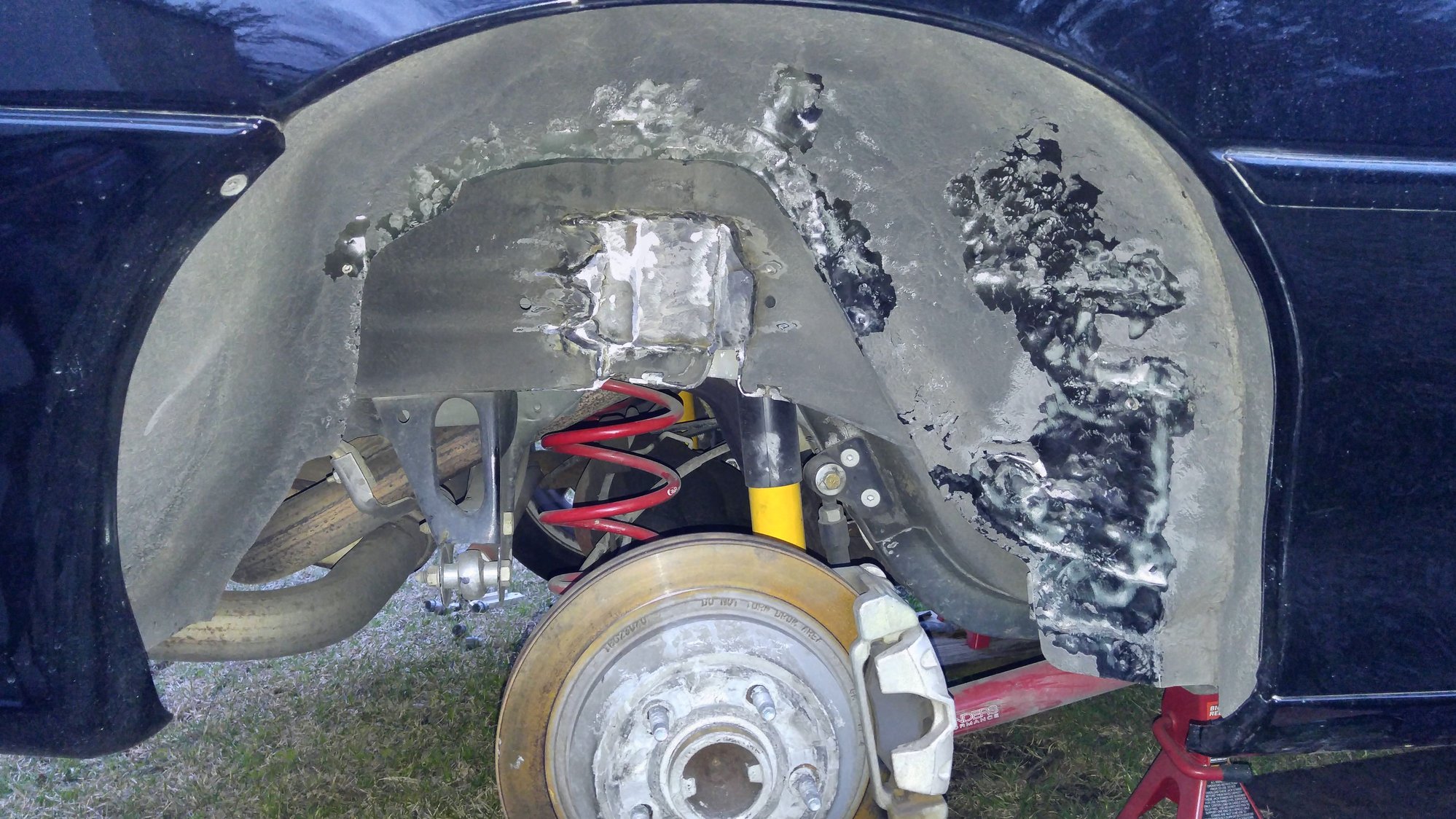

I would say yes to having the fenders rolled. It's some work involved in it. It's one of those things where for me I was like I'm never going to be able to beat this area around where the LCA mounts to the chassis in enough to fit these tires without a spacer. That area is beefed up on the chassis and doesn't want to move easily and at first it appeared that even if I beat it to the point of being pushed against the LCA that it wouldn't be enough to clear the tires, but as you start making progress your worries start to clear up. The biggest thing I didn't like was there was just no way to run these wheels/tires while keeping the OEM bumpstops. Not even close. I cut the off and welded some flat plates in there place to fill the cavity they left behind. I had planned to fab up some bumpstops but never did.
