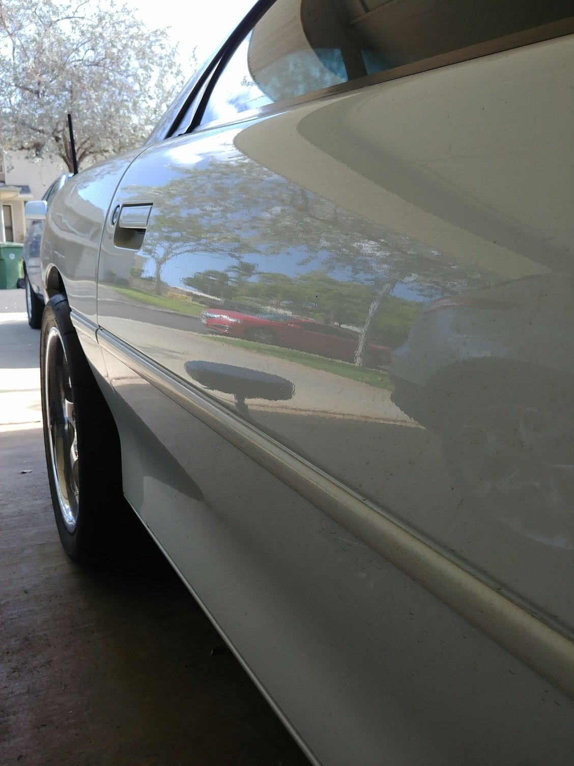

I bought mine off eBay for 39.99. I had to use 1.5 inch adapters due to the offset. What is the offset on yours? Mine are +65mm c5 vette wheels and sit flush with the 1.5 or 38mm. I didn't cut the stock studs..
