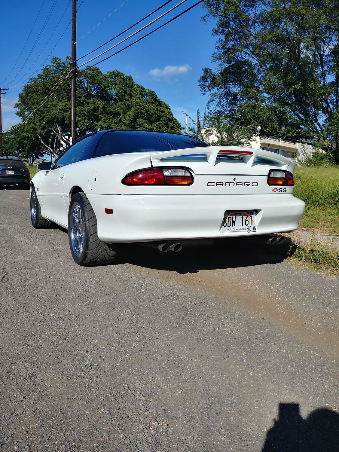

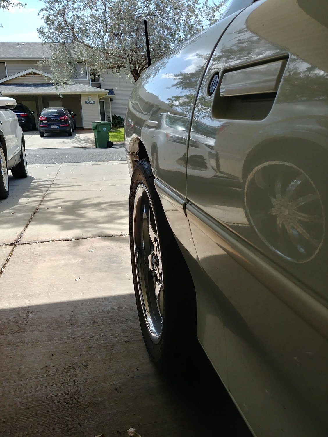

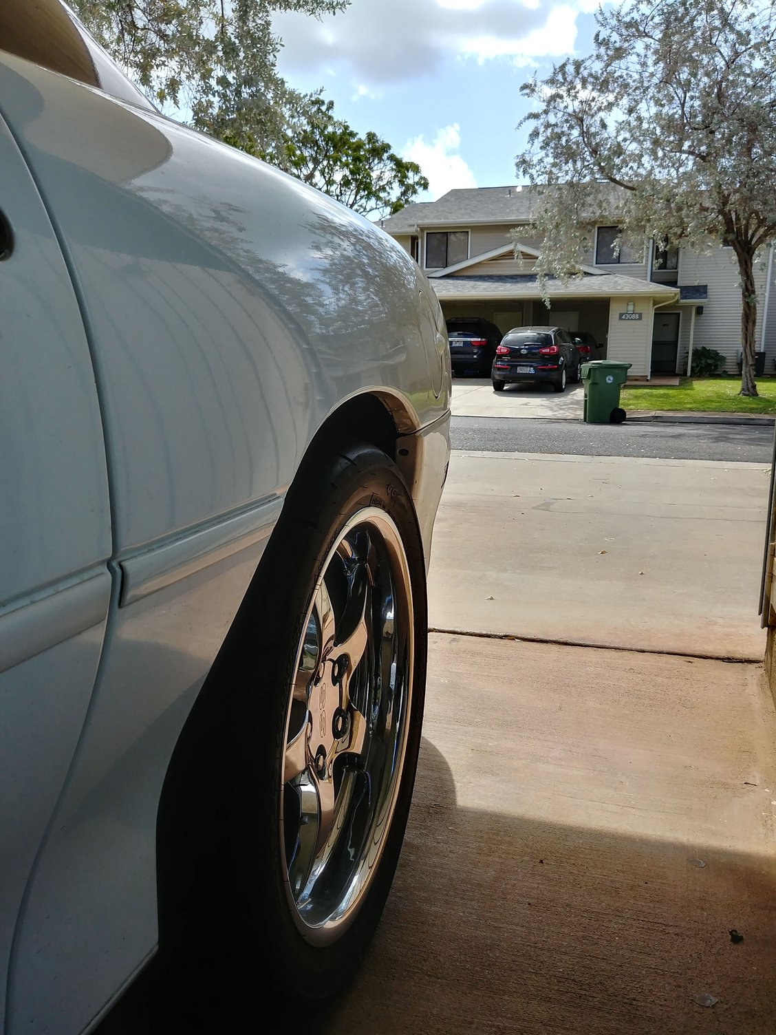

I know what the sticky says, but how bad will it look on 10.5 wheel?? Spacers?? Who's had experience with something similar???

I have a 10" wheel with +35mm offset in the rear of my 02 Trans Am and i've got about a half inch on either side before i'd consider them "flush". A 10.5" wheel with +35mm offset should be exactly flush with the outside face of the fender, at least on a Trans Am, Idk about a Camaro. I'm lowered on Strano's in the rear of my car without the hose mod, I think if I had 10.5" wheels with the same offset i'd be having some serious rubbing issues that i'm not sure rolled fender lips would help. I've seen horrible things happen with very expensive "quality" spacers on the track and on the street so I will never endorse or encourage anyone running a spacer.

Any pics?

I have 18x10.5 with a +50 offset, sits perfectly flush with the fender, f&r

Im running 10.5 inch wheels that are +56 offest with a 20 mm spacer so they are essentially a +36 offest. They are flush with the fender however i am probably gonna get some 15mm spacers to have them come in just a lil
