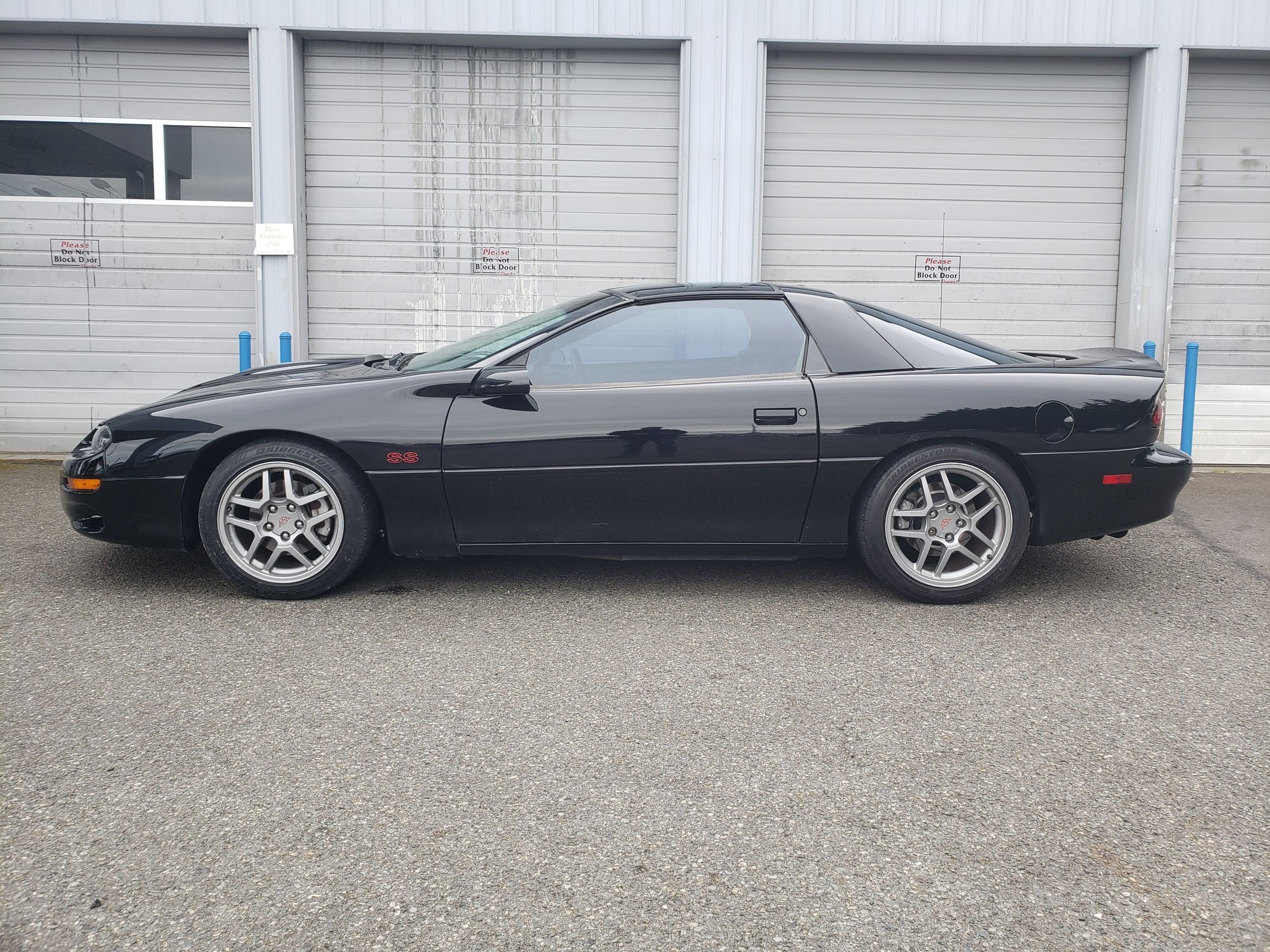

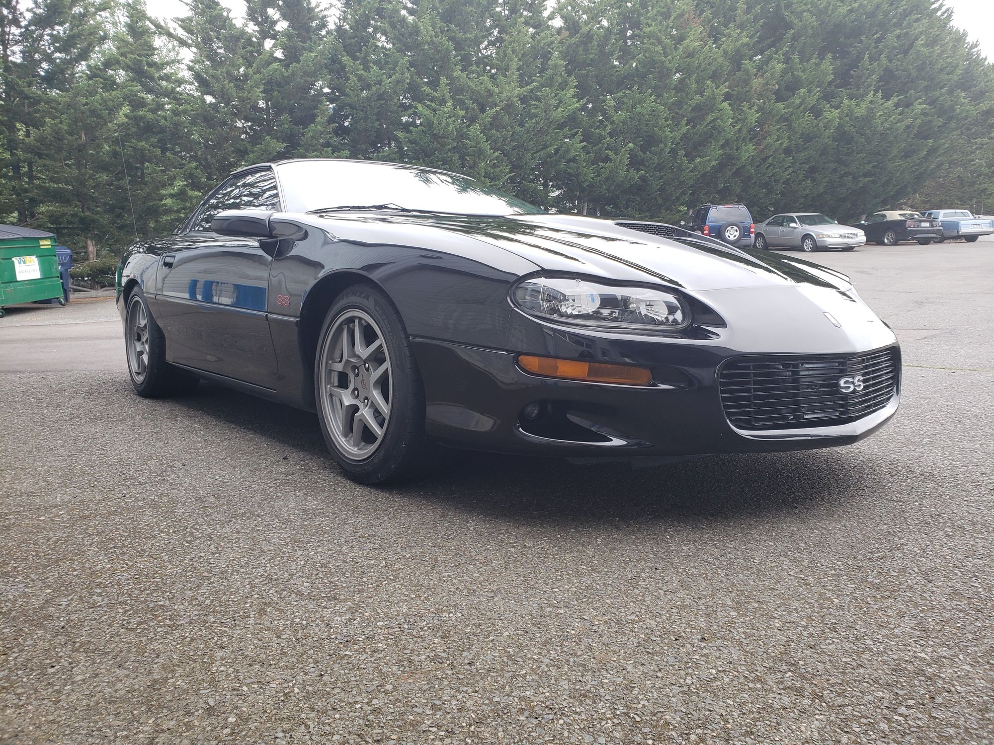

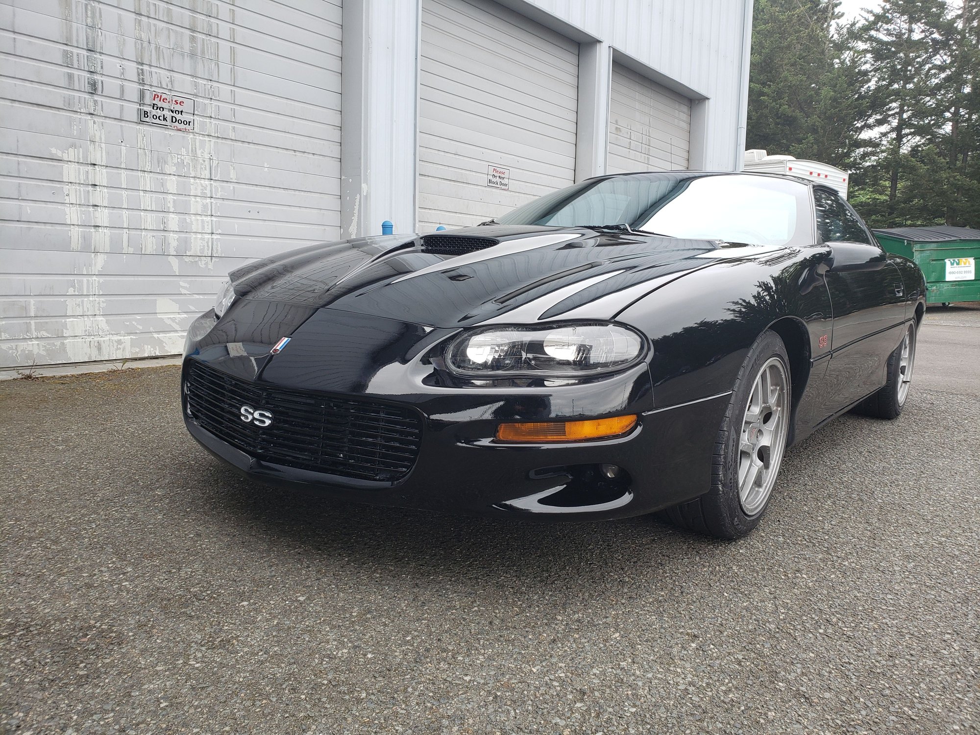

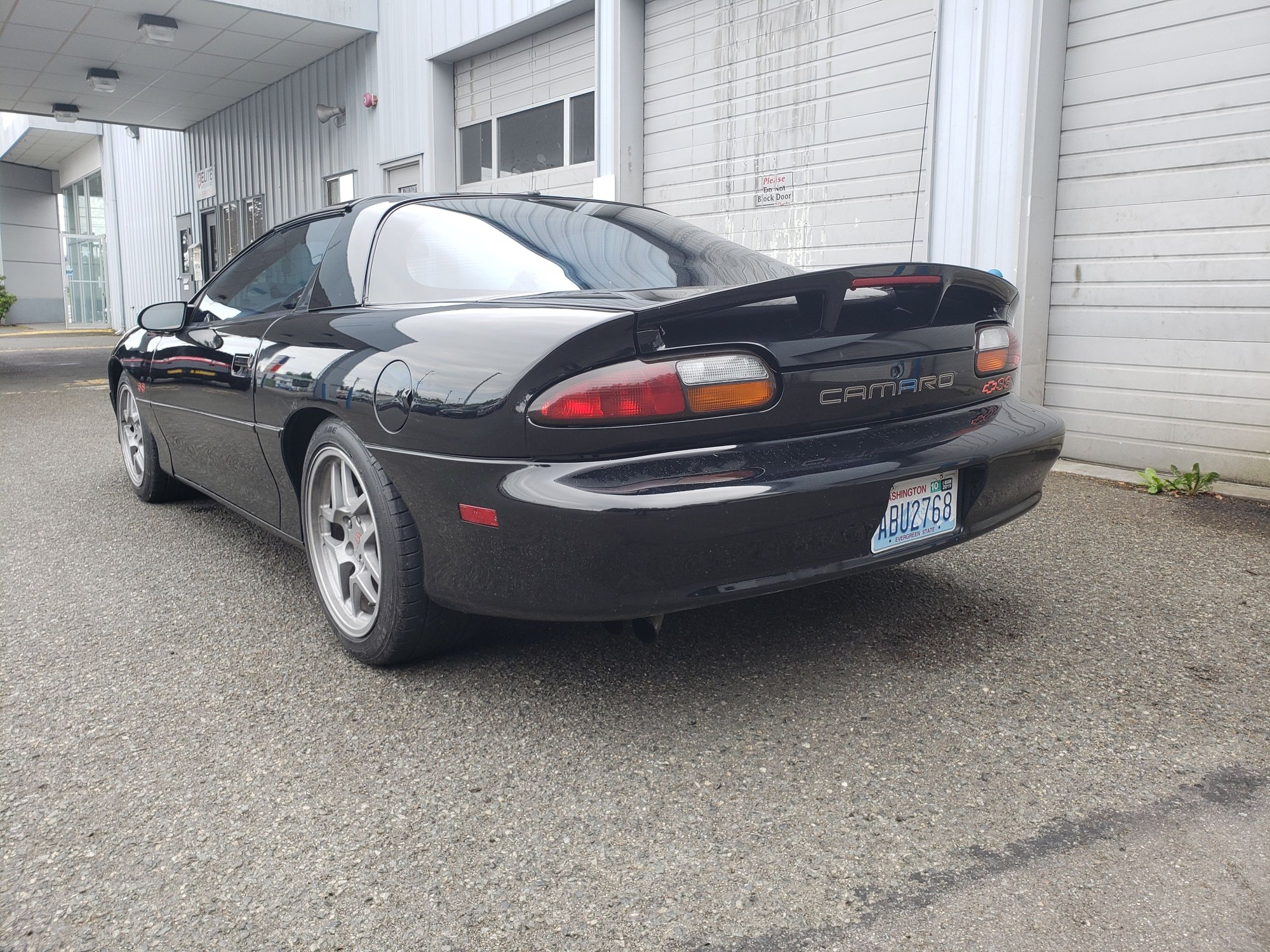

Hi all, I'm sure this topic has beaten to death but I needed some feedback on what wheel/tire size to get. My car is a 2000 Camaro SS, has BMR 1.25" lowering springs and BMR tubular front and lower control arms, LCA relocation brackets, etc. Currently running staggered Corvette Z06 wheels with Bridgestone Potenza RE760 Sport tires but tires are worn and figured its a good time for new wheels and tires. Also recently did heads/cam/intake/headers so cars putting down much more power and having a hard time keeping traction.

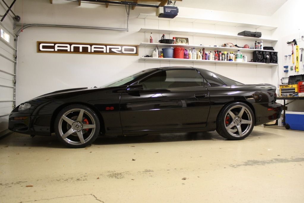

I've decided on Forgestar CF5 wheels in gunmetal gray, either 18" or 19"s. But not sure about offset/backspacing and getting something that'll fit the wheel wells without rubbing fenders and being able to fit a BBK later down the road. Anybody have experience with this on a lowered f body? Any suggestions on tires and tire size as well? Don't want them sticking out, just want everything nice and flush. Any feedback will be much appreciated! Pics are my current setup and my inspiration setup.

I thought about 19s as well, the only reason I went with 18s is hoping for better ride quality with more sidewall on the tires. My suspension setup is super stiff so anything the can help soften the ride would help. I had 20s at one point and that sucked super bad!
