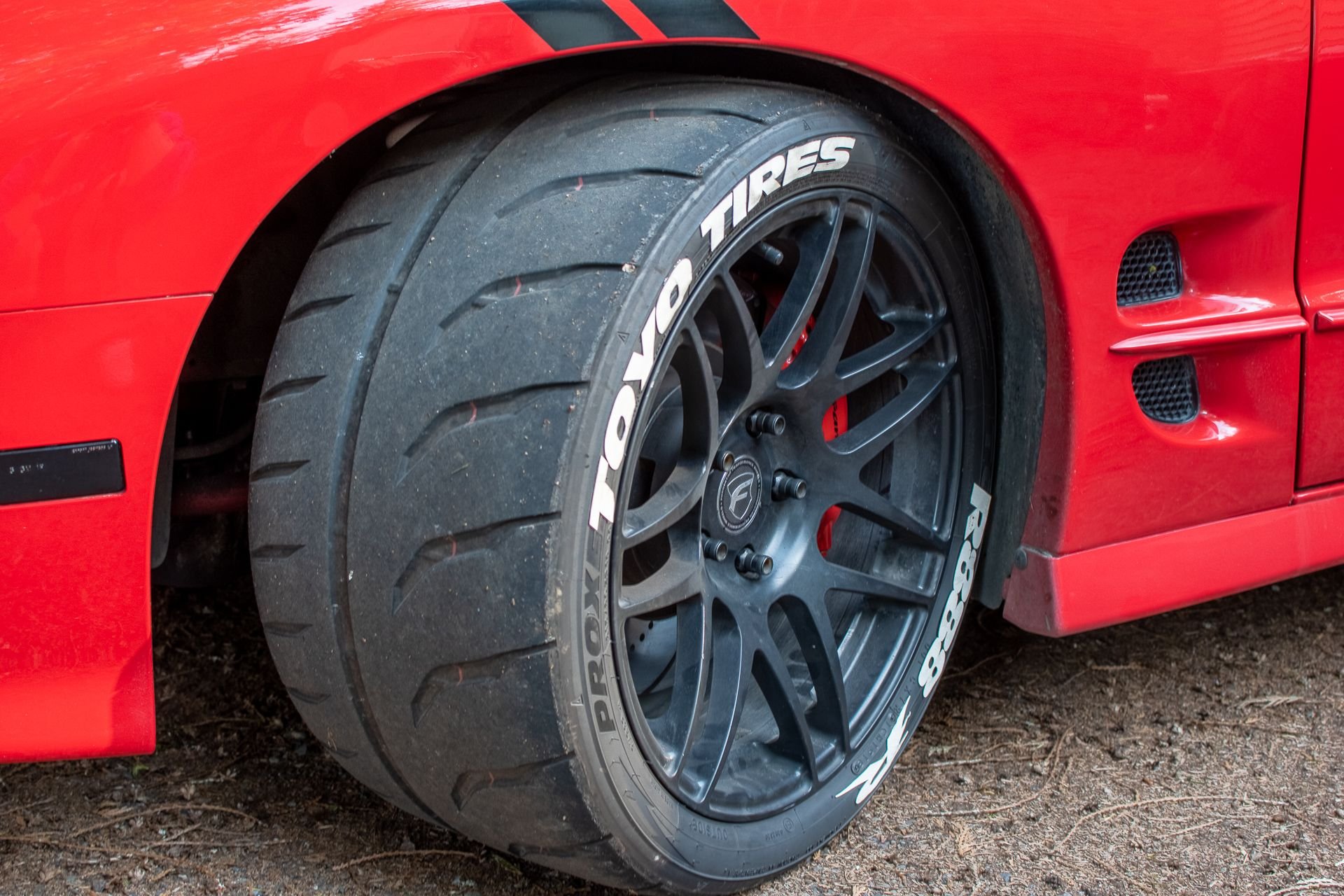

I'm running 315/30/18's on a 18x11 Forgestar F14 with a +40mm offset & CTS-V calipers. I didn't need any mods. I've seen autocross guys run 335's.
All depends on your wheel choice, needs to have the right offset & clearance.
