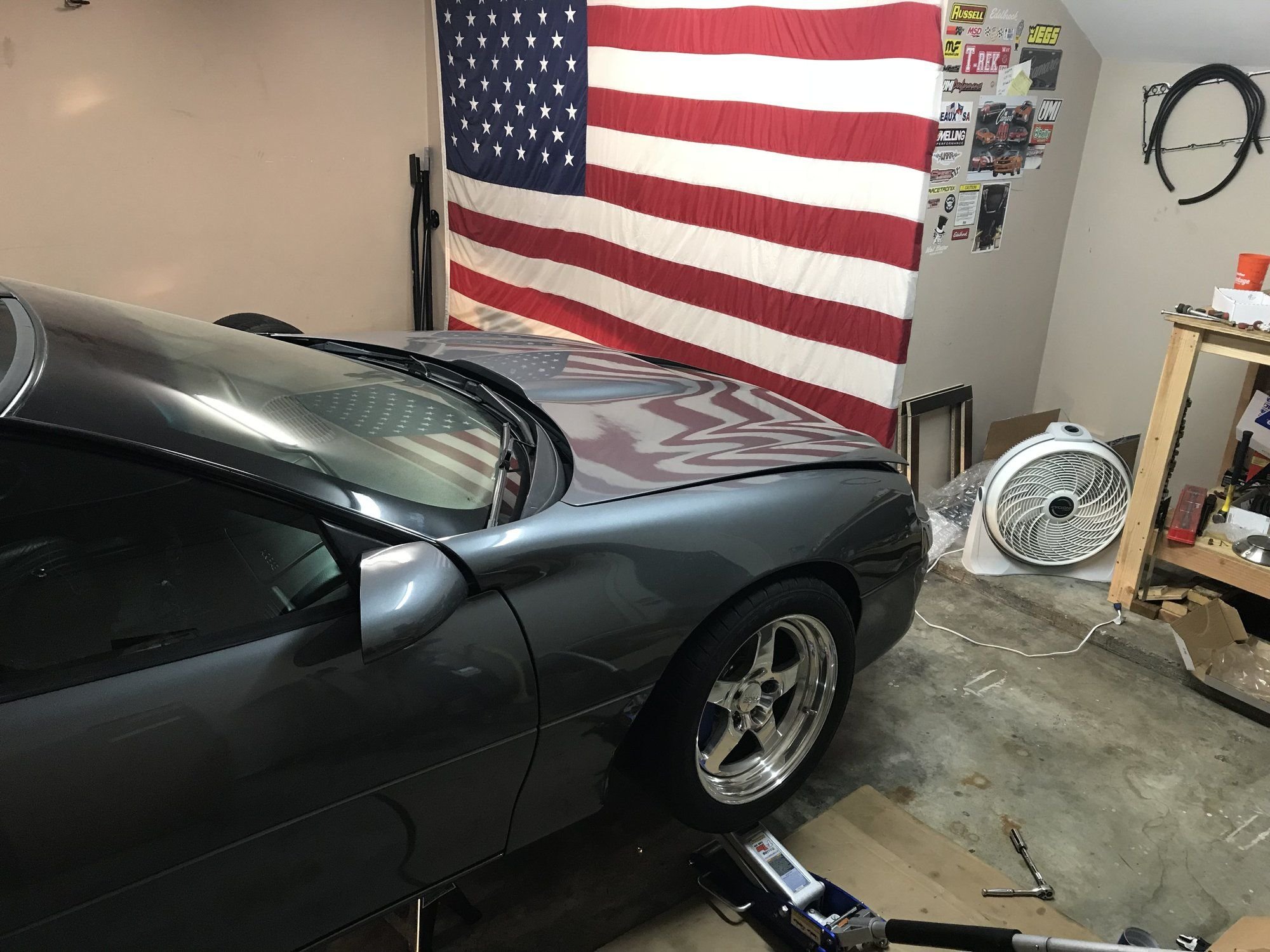

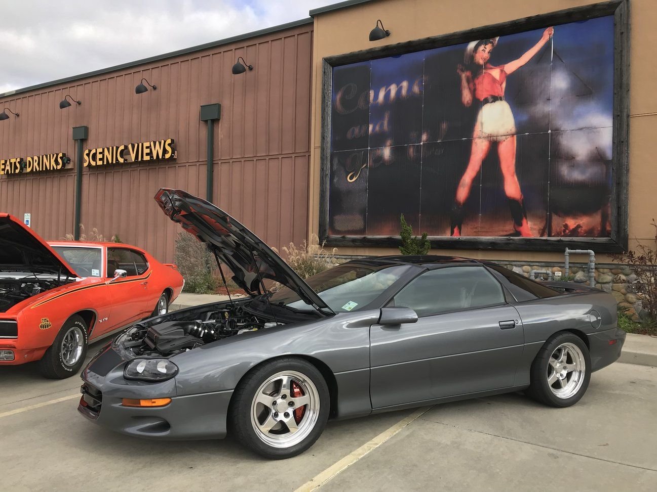

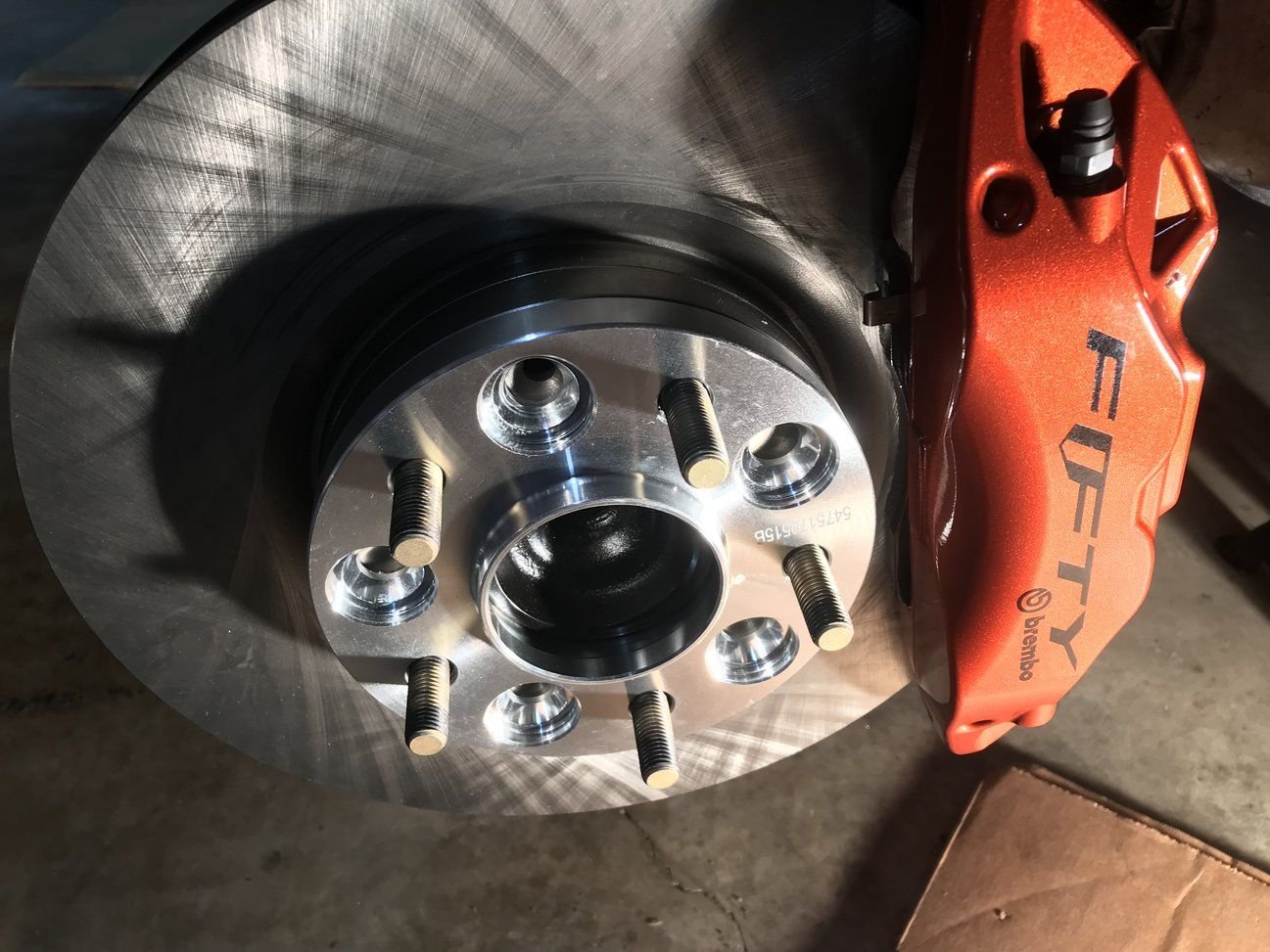

Will depend on your application. I had a set of 17" Fikse wheels with "F-body specific" offsets, they fit nicely.
When I upgraded my front brakes to 6 Gen Camaro brembos, the Fikse's didn't not fit unless I added 15mm spacers. I installed longer wheel lugs and the spacer but this caused the wheels to have a wider track compared to the rears which made it look funny.
The adjustable upper control arms allowed me to bring the wheels back to where I wanted them and looked great once again.

Wide track without Adj upper control arms.
15mm spacer
Adjusted

Yup...that looks really really good. Very nice SS by the way. Can't say i've seen one in gray.
