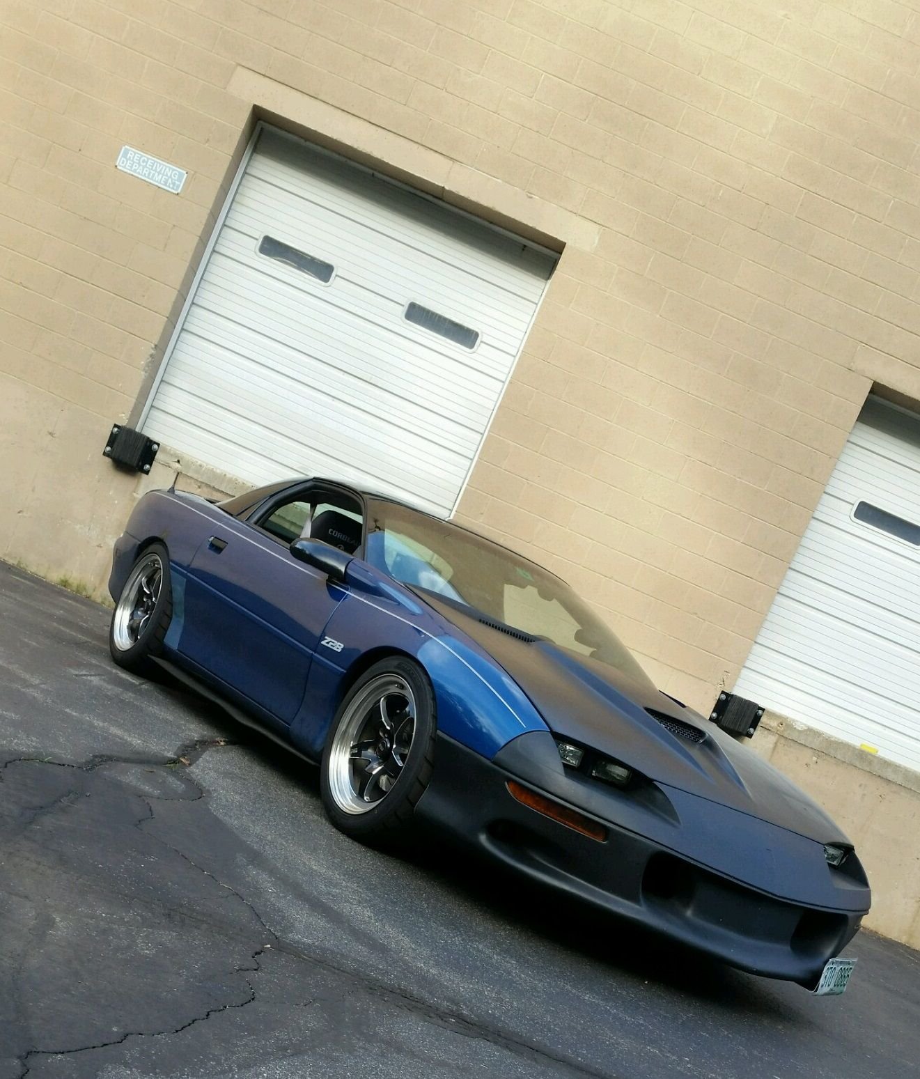

I have 18X10.5 +50 on all 4 corners of my camaro, +22 would push the wheel out a little over an inch from my setup. now i have heard that T/A's quarters are slightly wider than the camaros but i have no personal experience with that. in inch would be out past the quarter on my car and not fit
