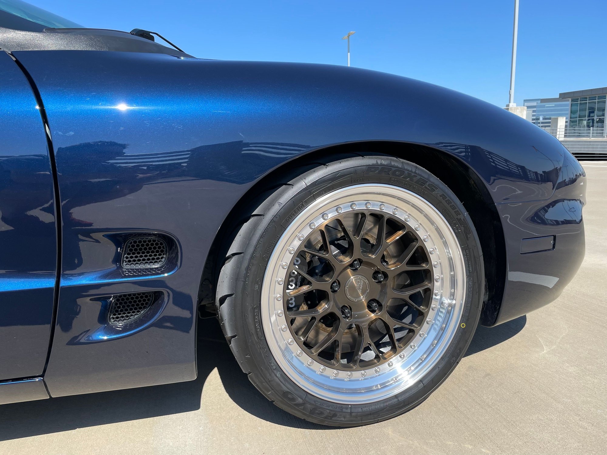

18x11 rears with 5.25” back spacing or -19mm offset
18x10.5 front with 7.72” back spacing or +50mm offset
I placed my order with BC forged and so started what felt like the longest 5 weeks of my life!

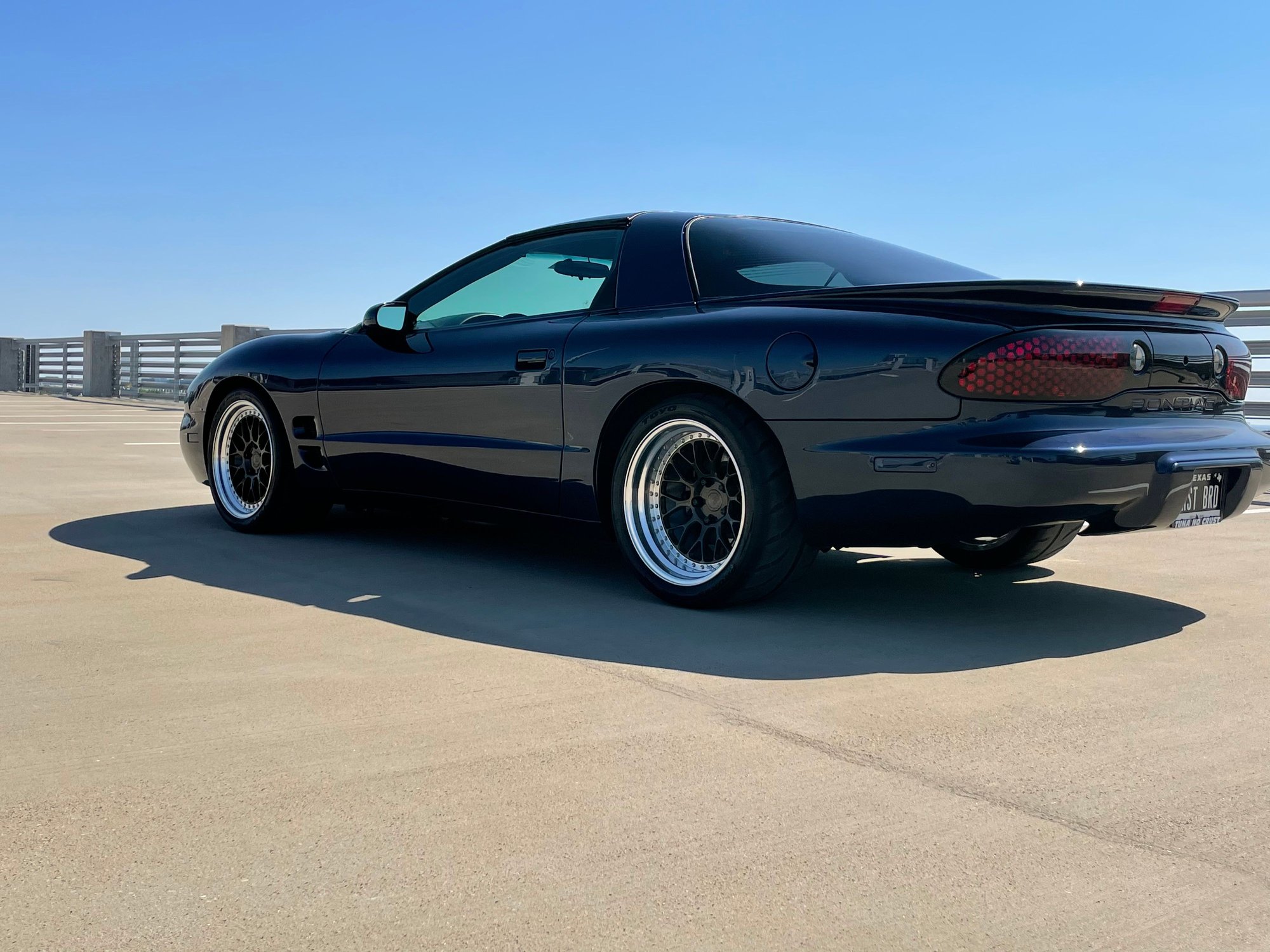

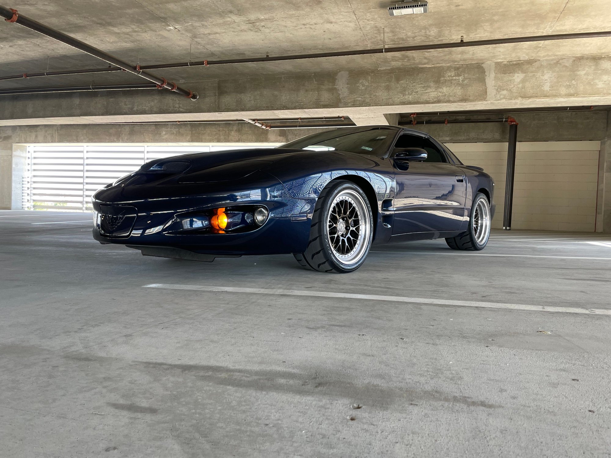

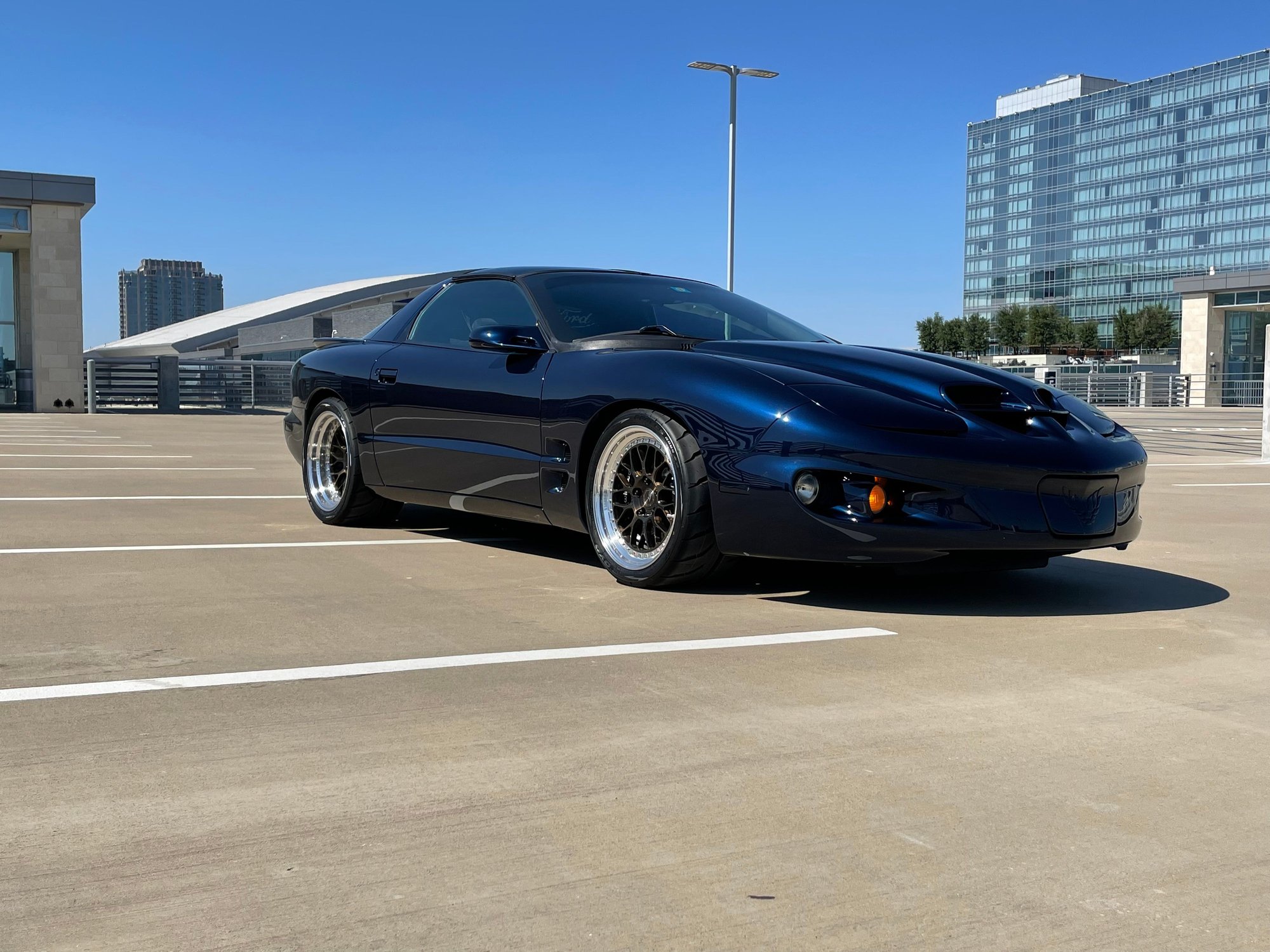

wheels arrived last week and I wasted no time, tire were mounted that afternoon and it was the moment of truth, to say I was nervous was a complete understatement! I started with the rears and boom!!! Perfect fitment!!! I kept my excitement bottled up till the fronts were on, driver side goes on and again it’s a perfect fit!!!! In this moment I feel like I am watching my third child being born. I am over the moon with excitement!
So as we are nearing the end of my novel and finally getting to pics, I hadn’t planned on taking any till a few more things were done like new tint and paint correction and ceramic coating the car and wheels, but I couldn’t resist, I had some free time one afternoon this last week and got it out to snap some quick photos.
anyways I hope y’all enjoy and if you read my whole rant, thank you! Thank you to all the members of tech over the years that have posted helpful information in this section and others.
