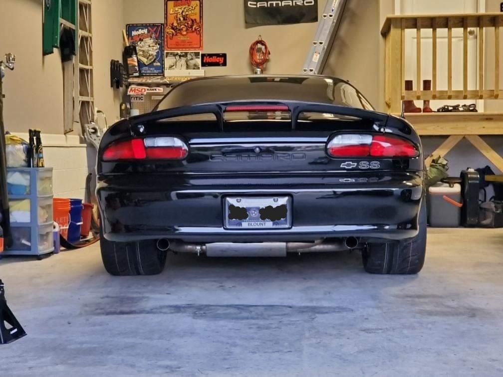

A double adjustable panhard is the way to go on that issue. I have OEM C6 Z06 wheels, 19x12 with 325's out back. Had to bfh, grind a little, tubular lca's and roll my fenders but fit with no spacers. Just make sure you are test fitting with rear suspension loaded. Took multiple test fits and licks but its fairly easy. Now I can corner hard with no rubbing. And rolling the fenders simple with right tools.
That's so much tire in there. Look awesome!
