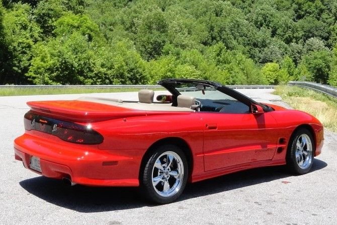

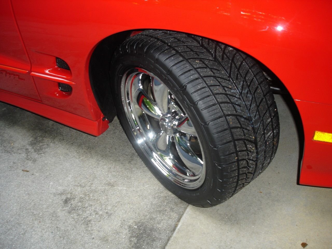

Geez! Been there done that with the grinding. Did it for over 10 years until finally the tire shops said 'no more'. The leaking was a real pain at the end. If you need new tires, definitely start fresh with new rims. I've been tickled with my new set.
