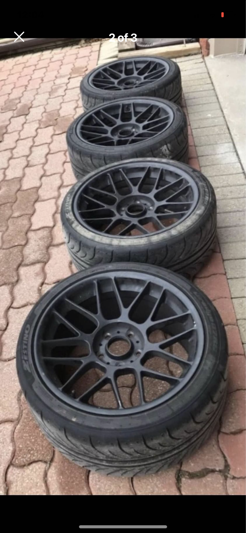

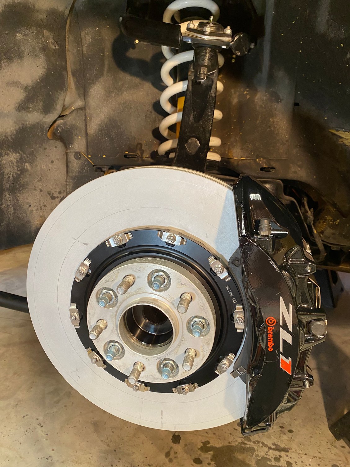

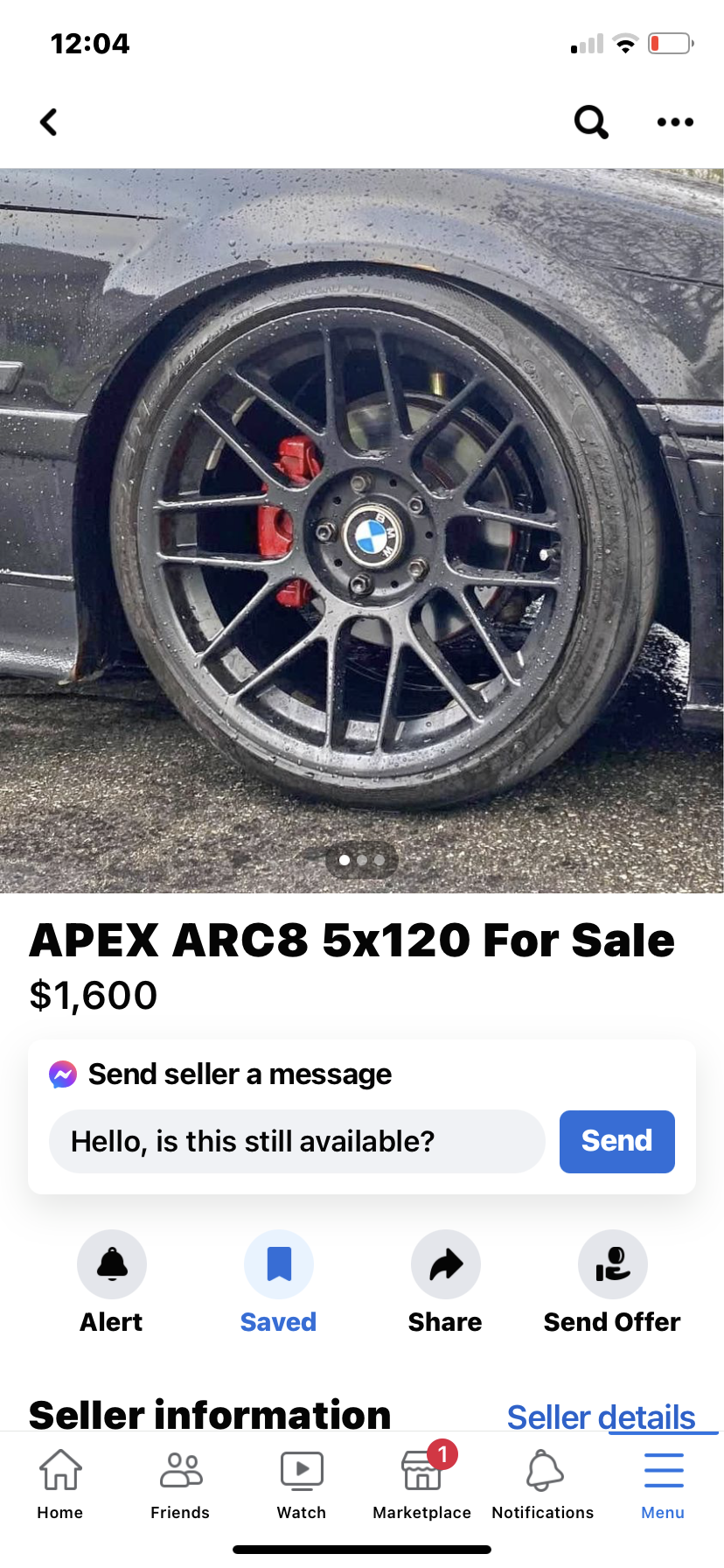

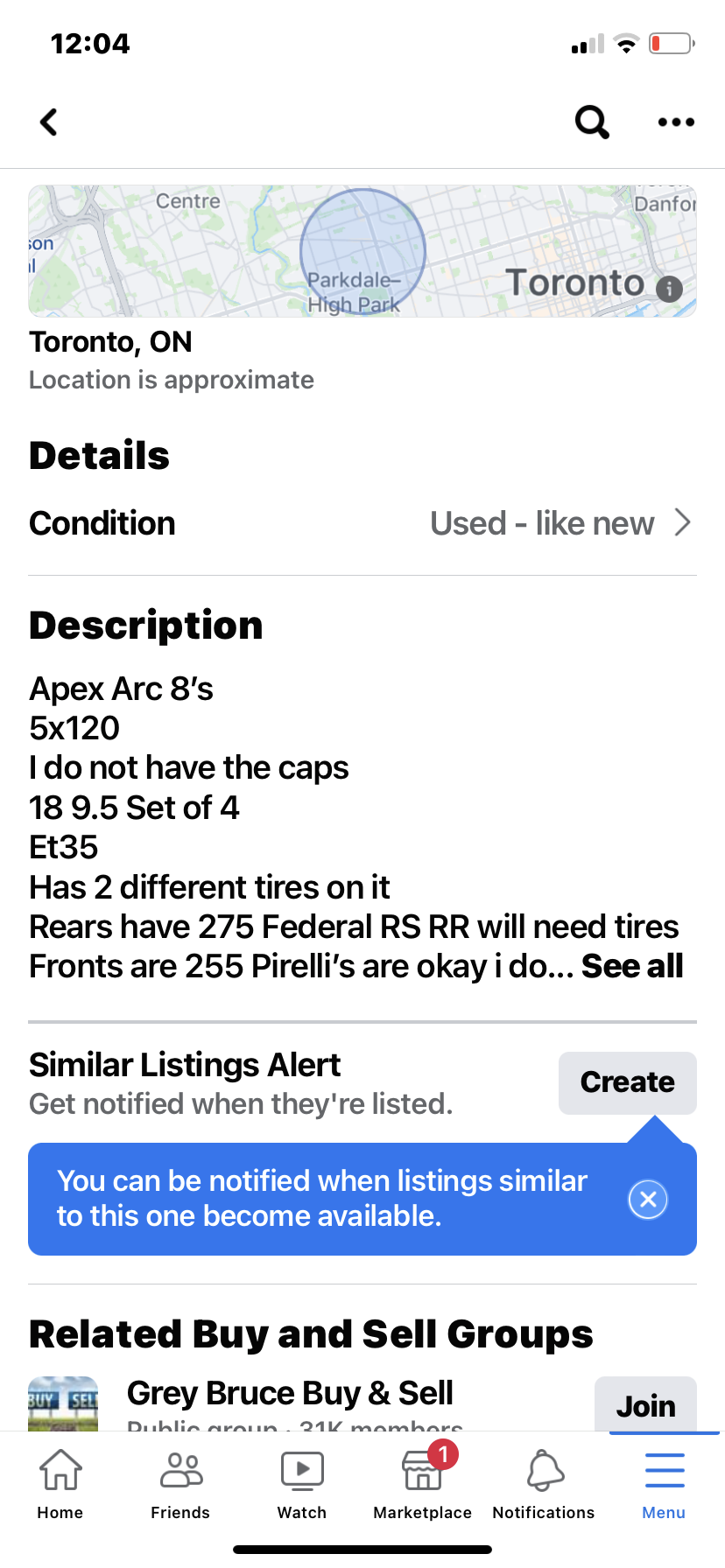

Will these Apex ARC 8’s fit my Brembos? Or will I need spacer’s with these rims?
My brakes. Spacer on, but would like not to run it.
Wheels I’m thinking about.

do you know the et?
Old Dec 24, 2022 | 07:28 PM
Barn Find CETA's Avatar
Joined: May 2020
Posts: 269
Likes: 64
It says 35 in the add. I don want to roll
fenders. A bit of BFH is ok though.

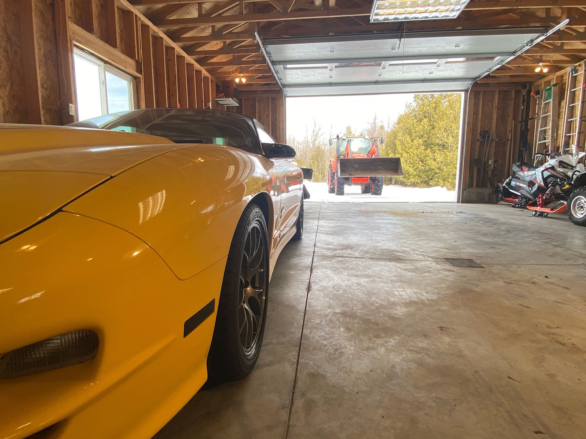

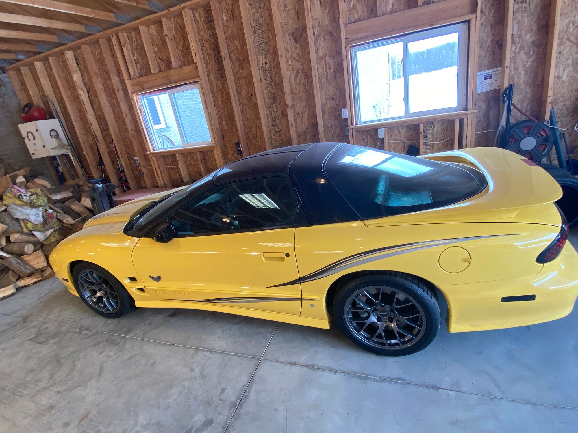

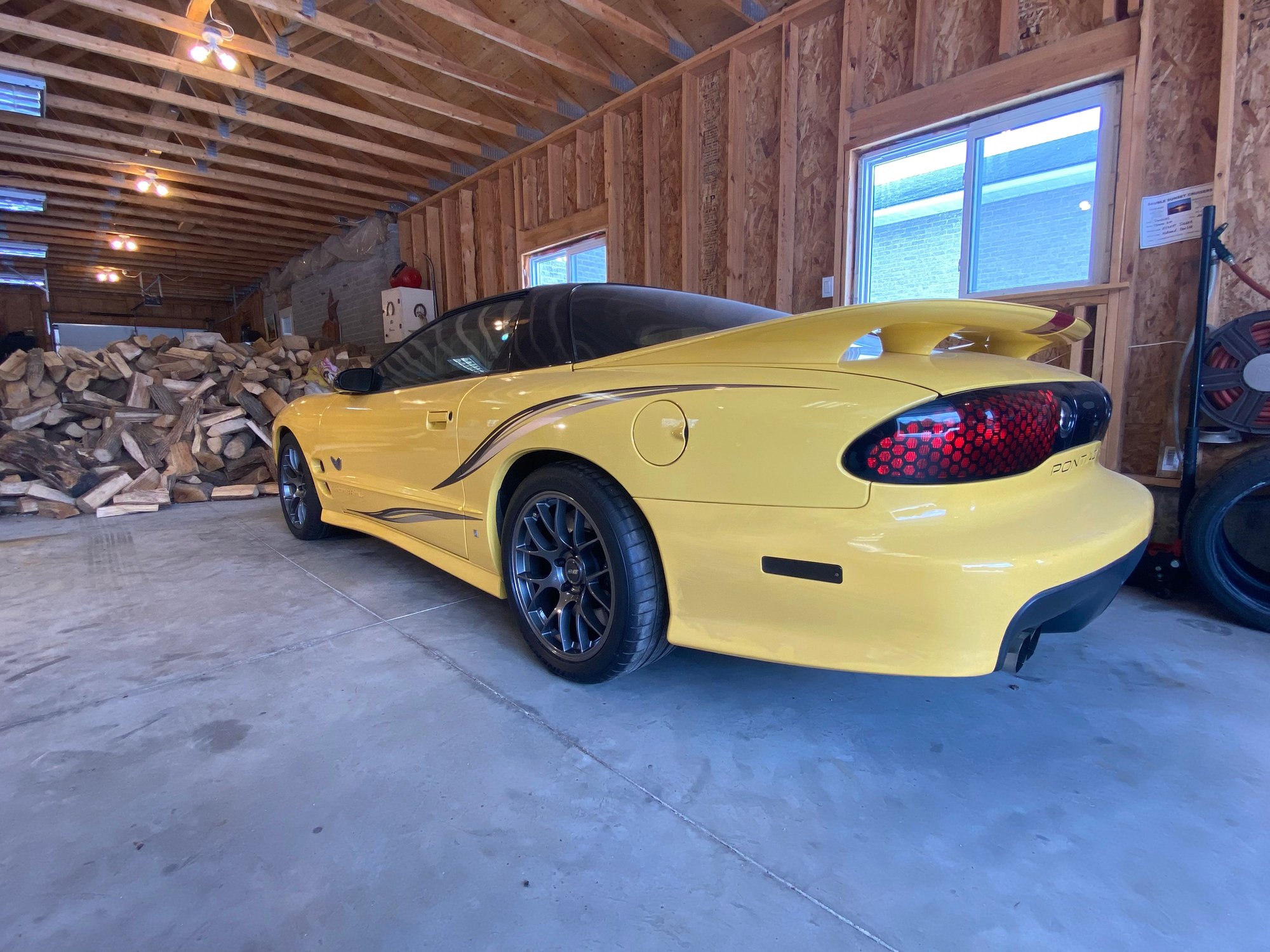

No I didn’t get these, but I got a set of EC7’s 9x18 with 31mm offset in the front and 10x18 with 43 mm rear. They fit perfectly. No rubbing, no rolling fenders.
295/35/18
185/35/18
