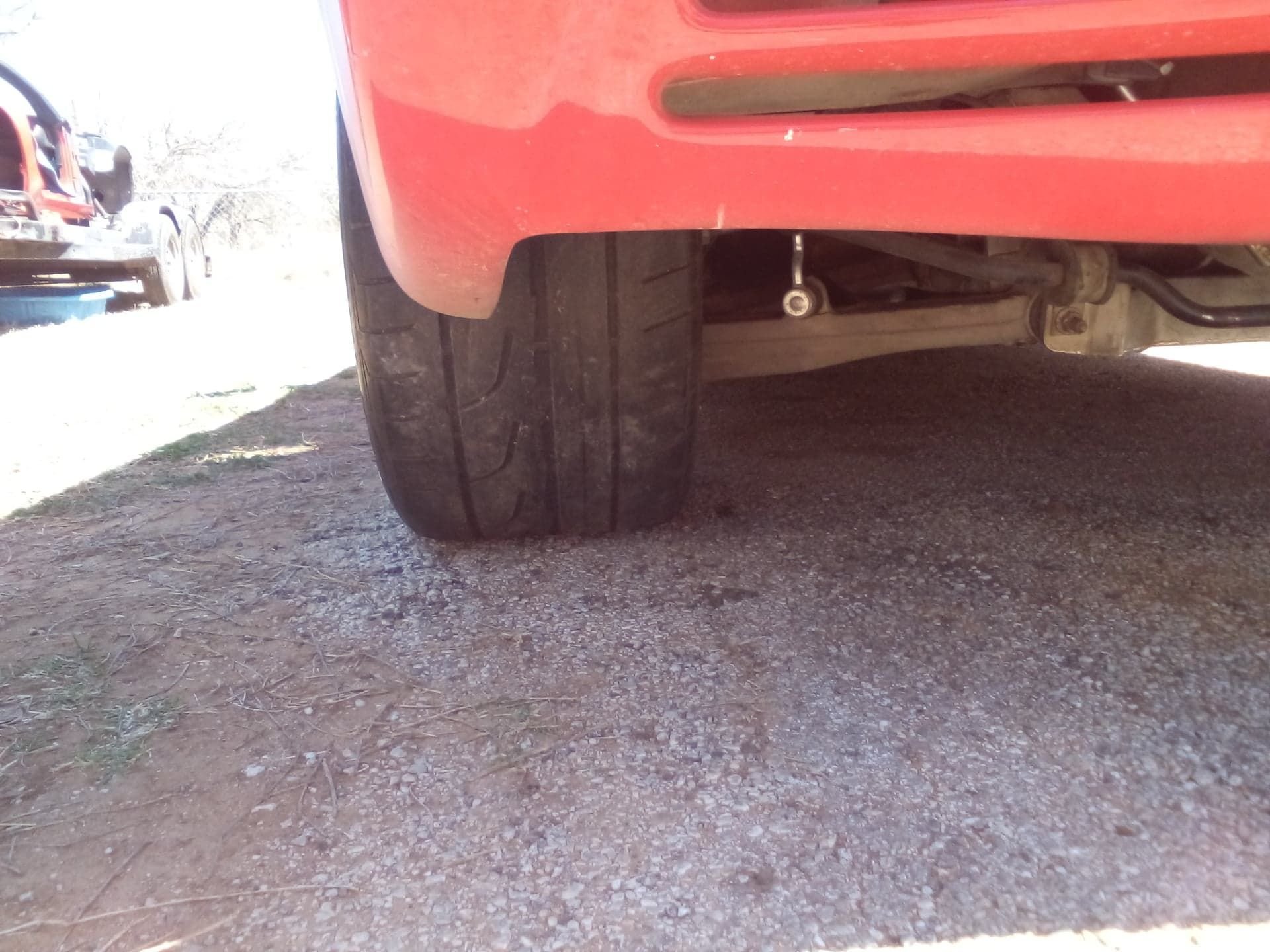

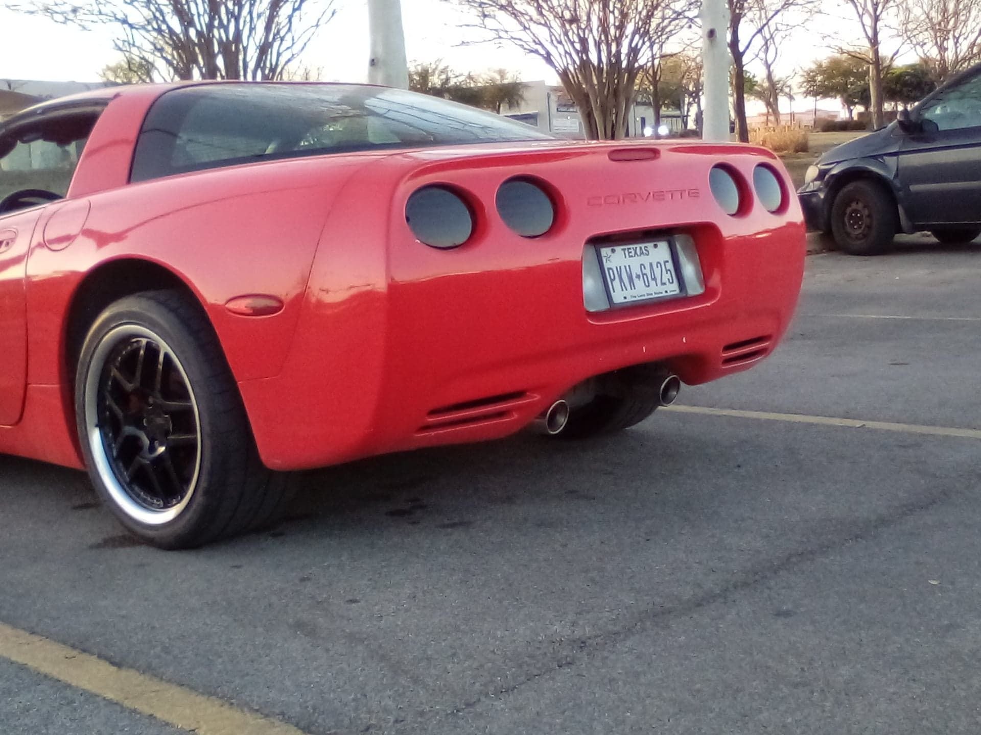

Default Are wider wheels worth it?
Not for handling/braking as Sam Strano has proven. Showroom Stock is kind of limited but he's consistently shown better lap times on 16X8 OEM wheels than 17X9 OEM wheels, but that's road racing.
Sapper was right "Wider wheels on the street is more of a downgrade for a cruiser / DD other than looks." Sad but true. Drag racing is different but this thread is about DD.
The Law of Diminishing returns applies to wider wheels just like everything else. Mostly chasing ever more improvement is not cost effective. As I prove:
