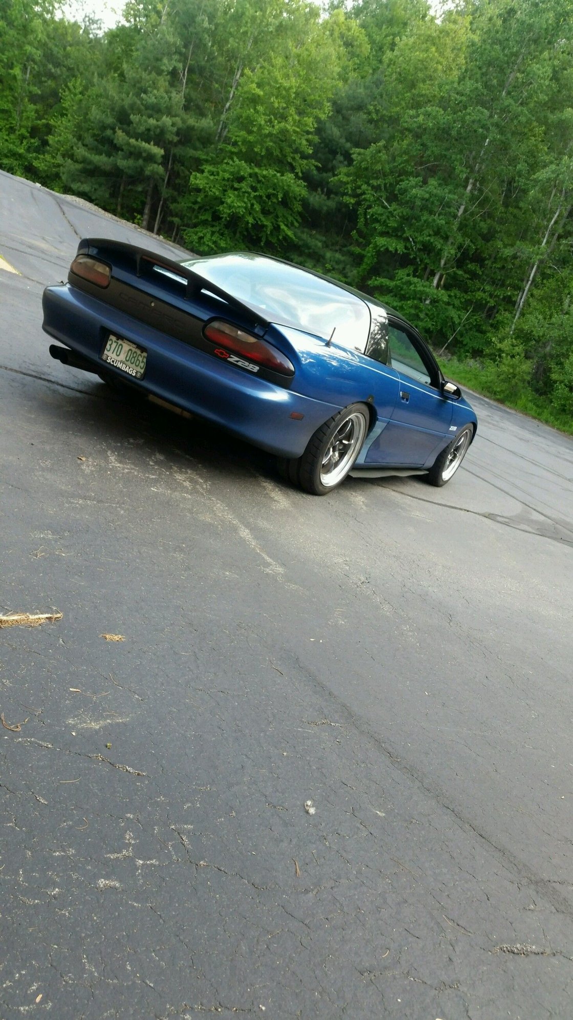

FWIW my car is on coilovers roughly 2.5" lowered with 18x10.5 wheels (295/35 tires) on all 4 corners with +50mm offset and they sit about perfect imo
