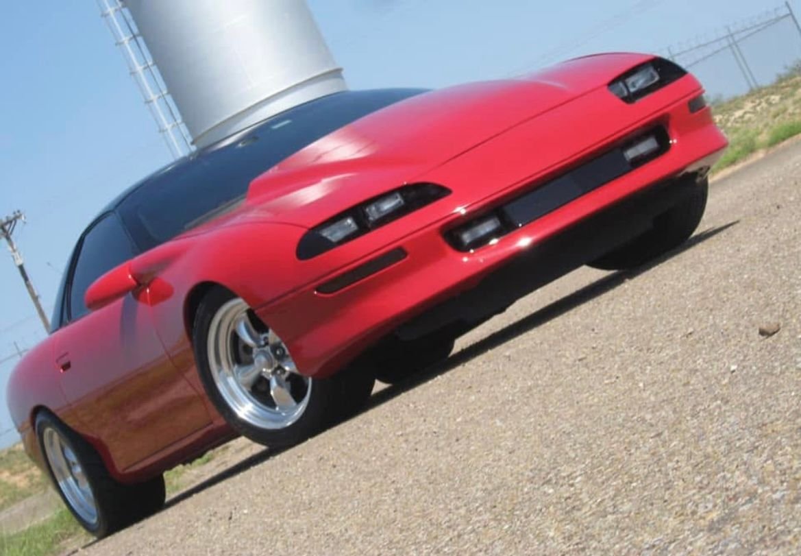

I’ve been trying to buy some 18” Torq thrust wheels for weeks now, and everytime I go to buy them and ask a second opinion someone tells me they won’t fit etc. Car is 1996 Z28, these are the ones I was going to buy all round. I want them to fit like the car in the image below. American racing recommends 18x7 but to me that would seem far too thin of a rim.

FWIW the stock salad shooters that come on these cars are 16x8, later SS cars came with 17x9 wheels so an 18x7 is a downgrade in my opinion. i fit 18x10.5 on all 4 corners of my car pretty easily, no issues in the front and a little clearencing in the rear plus rolling fenders because it is lowered on coilovers, have seen plenty of other cars fitting 17x11 on all 4 corners as well so it is doable. there is also a ton of info on this site about torq thrust fitment, they have been pretty popular over the years on these cars.
