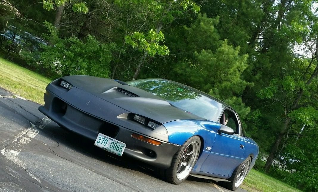

you should be fine with the 9.5 and +50 offset. i have 18x10.5 +50mm offset weld rts's on all 4 corners of my car and they fit perfect imo, tires are 295/35 nitto nt05's. you have a little wider rear quarters with the trans am over the camaro's too.
