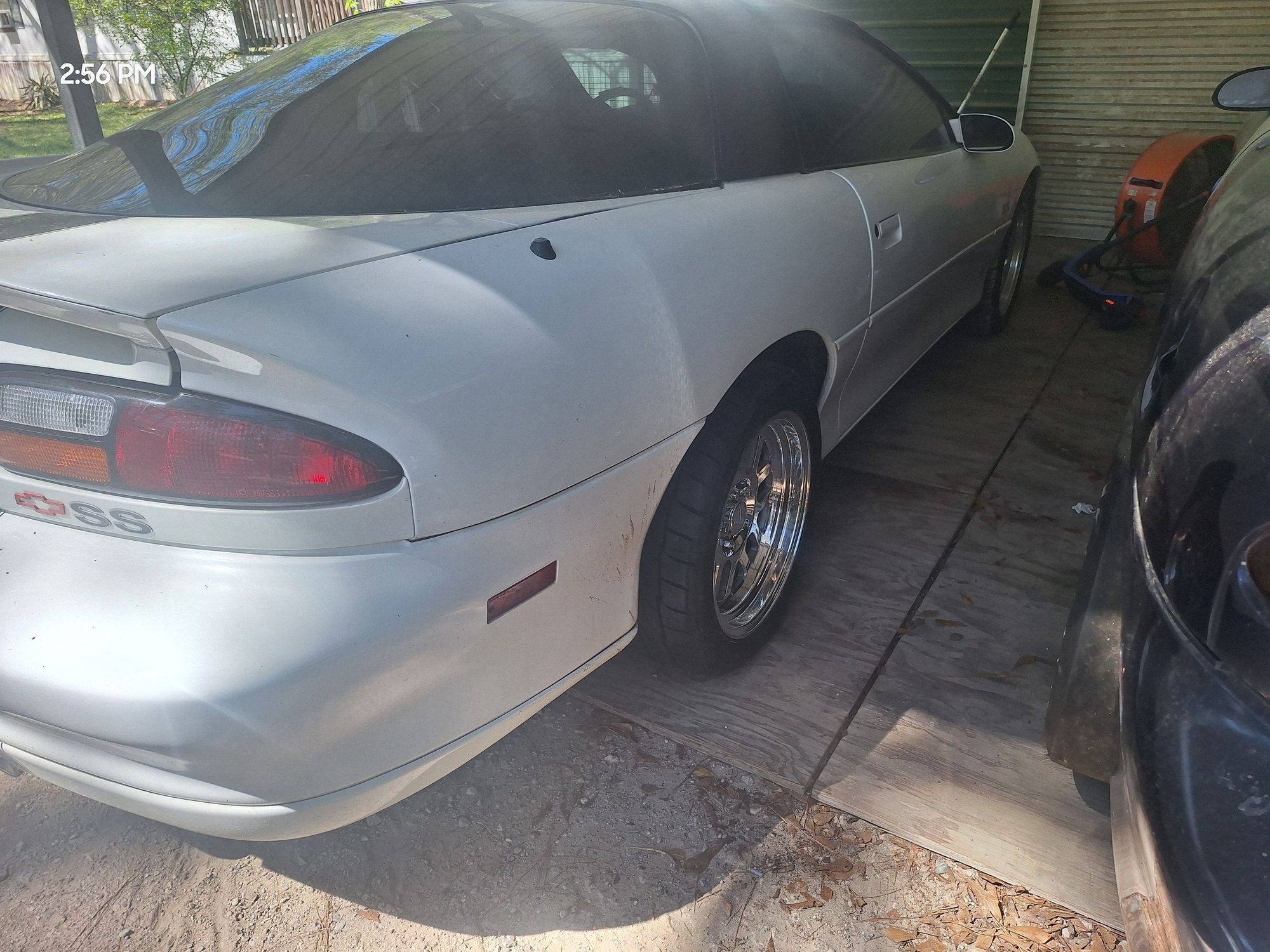

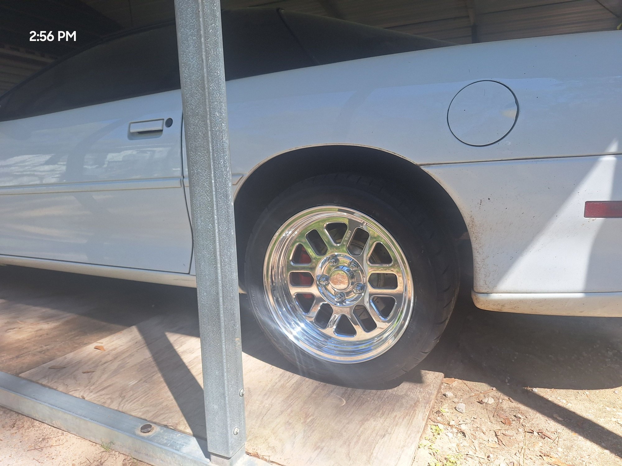

I got around to installing the Bogart 17x11 with Nitto 315 35r17's today. I didn’t have to do anything to the bumpstops but they will make contact with the wheels if you lift the car and let the suspension hang. I'm going to make the move over to coil overs on the rear and once that's done I don't think bumpstops will be staying.
