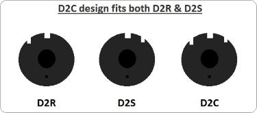

That is not an H3 bulb. An H3 bulb is much smaller (total length is just over 1.5" not including the wire pigtail):
To my knowledge, H3 has never been used in headlights but they are common in fog lights.
What you have appears to be a D2S capsule (what an HID bulb is properly called). D2S and D2R are basically the same except that S stands for shielded (normally referring to projector lamps) and R stands for reflector referring to some specially designed HID reflector housings (still never a good idea for use in a halogen reflector housing). The D2R has a painted area around it that is designed to cut glare when used in the proper housing. The bases of each type have different notches to prevent installing the wrong one.
D2C is an aftermarket capsule that has notches in its base to fit either D2S or D2R housings. The C generally means Colored referring to the aftermarket tendency to use bluer color temperatures like 6000K and higher.
The problem is the base. If your projectors are OEM HID retrofit to your car then the D2S capsule will be the one you need. If they are aftermarket or OEM halogen projectors then you will have to match the capsule base to a corresponding halogen bulb base. For example, if the base has one wide and two smaller tabs spaced evenly around it and is held in place by a clip then it's probably H7 (could be H4 but that is a dual filament bulb not used in projectors). Similarly, twist-lock bulbs like H9, H11, 9006, etc. vary in the diameter and configuration of tabs on their bases.
It's very hard to tell from your photo because it only shows the edge of the base so the notches and tabs aren't visible but it looks like an ordinary D2S.
Here are the D2 capsule base types:
