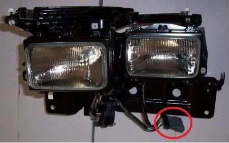

So this is a pain in the ***! I have no power to my driver side headlight motor. The light goes on but motor doesn't move. I tested the motor on the other side and it works. Also checked the fuse and its good. Any other ideas? Could it be the BCM?

You need to test the power at the motors electrical connector, which I notorious for corroding.
Agree, check this. You may be surprised...
