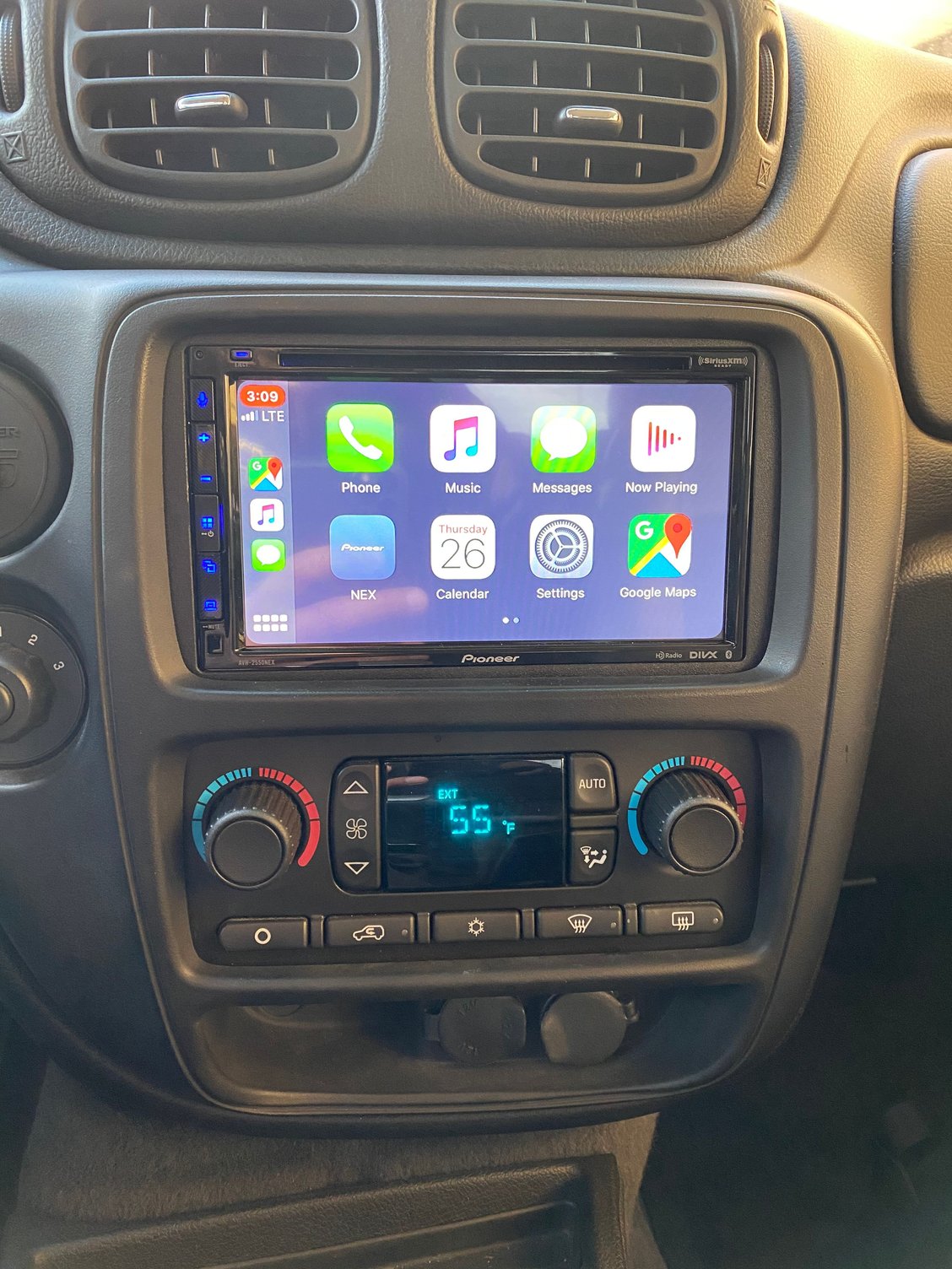

It was an easy swap, just plug and play. The dash bezel on the other hand was a PITA. I ended up going with the AVH-2550NEX.

Yeah the dash bezels are always fun... I've gotten really good at taking them out after doing it a dozen or so times. Still nothing compared to some of the dashes on Fords though. Good job on the swap! looks great!
