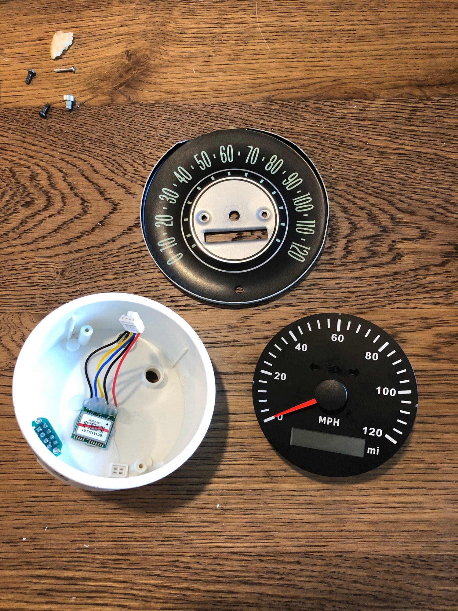

I ended up getting an extra speedometer face for cheap. Someone was able to help me out with. that from a nova forum. I measured the sweep of the stock speedo and found a cheap($50) chinese gps speedometer that had the same sweep. The plan is to overlay the factory face on the new gauge. That way I can just put it back into the stock cluster. Since it is gps, I will not have to interact with the computer or transmission.

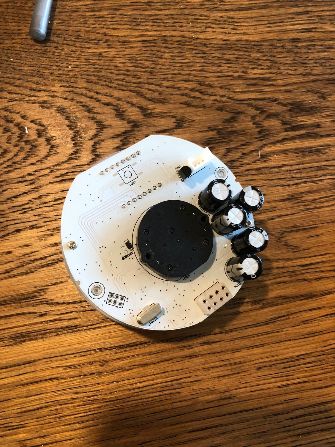

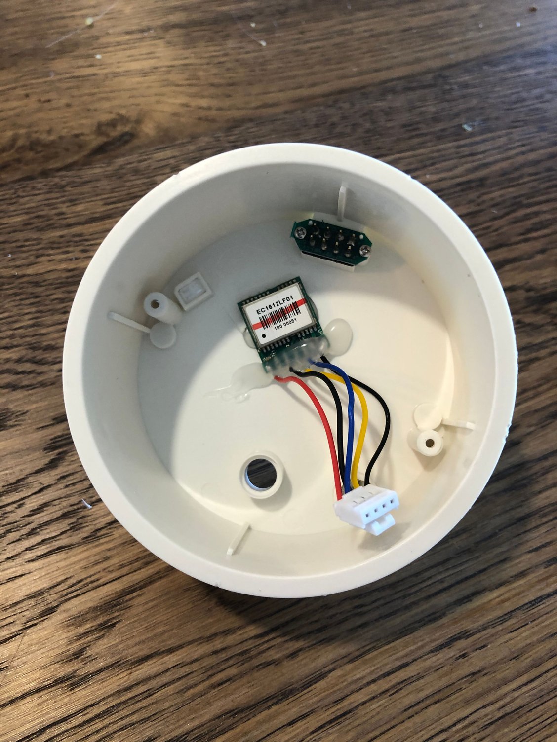

I started by taking the new gauge apart. It was tricky to pry the bezel off, but once it was apart, it was pretty simple inside.

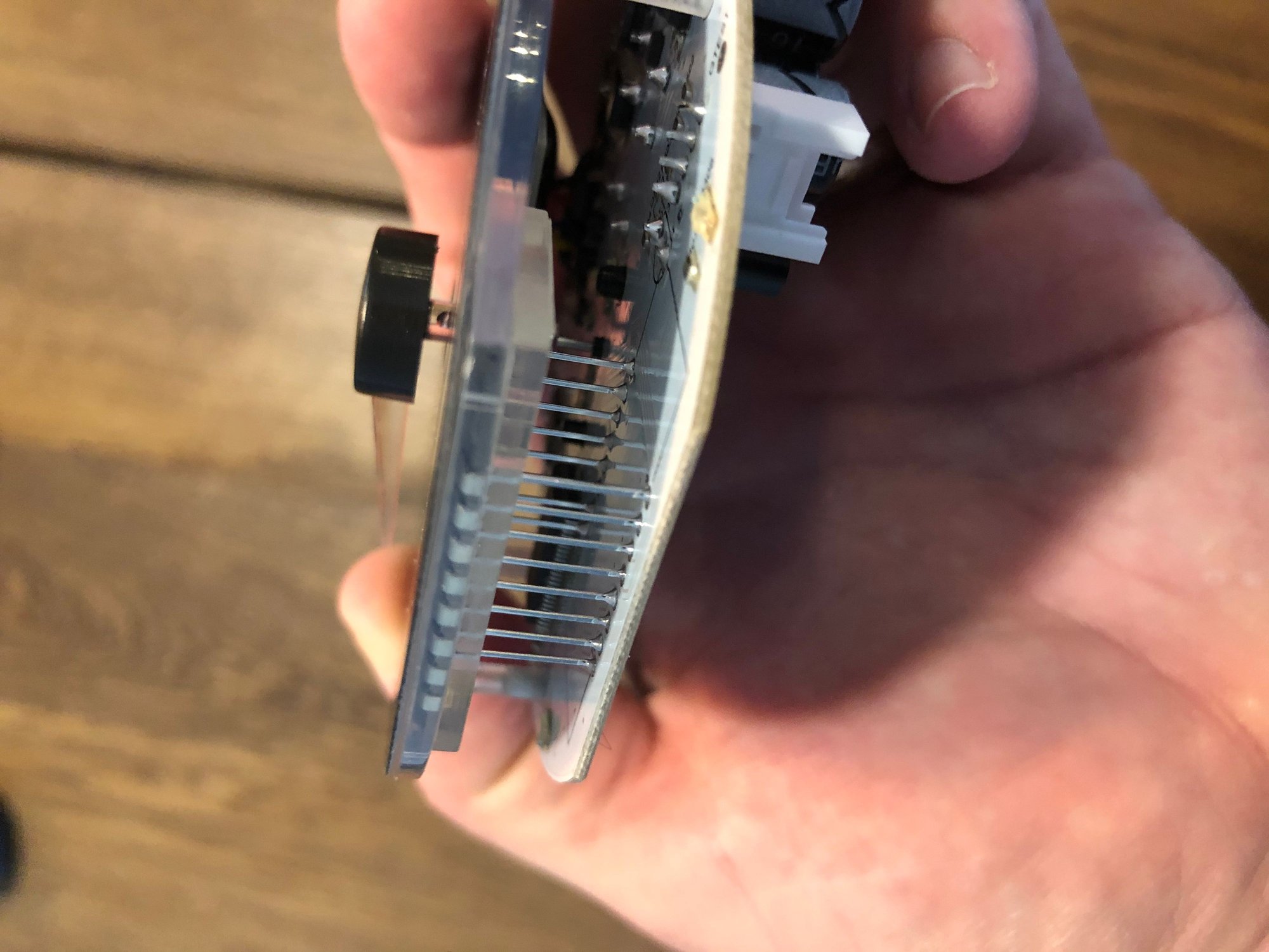

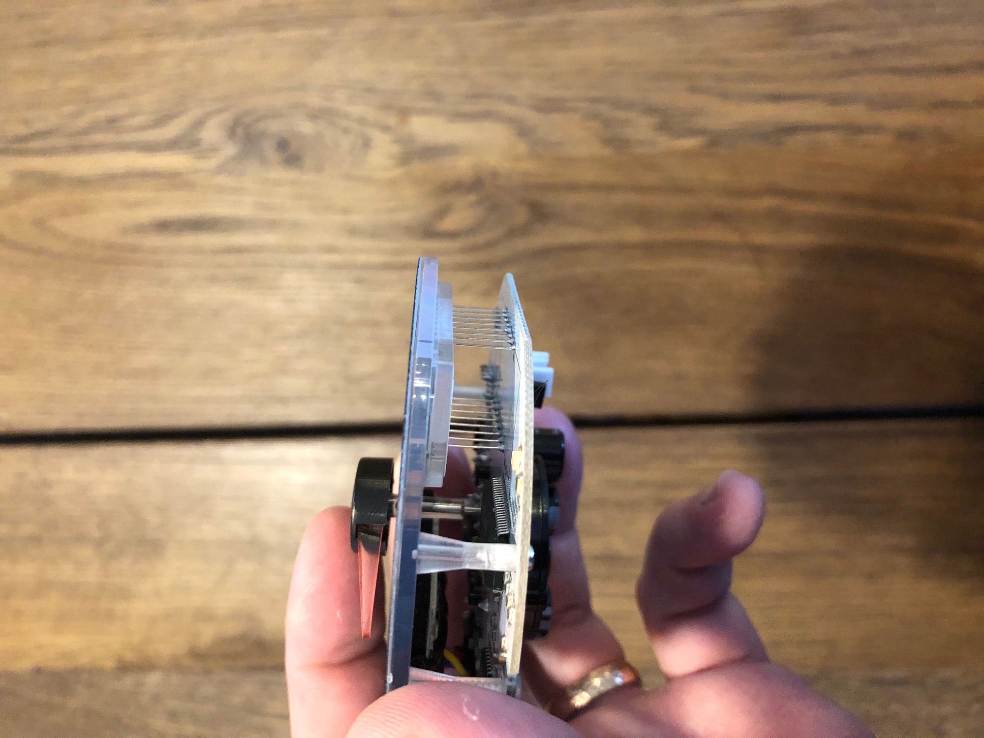

One problem I ran into was that the odometer readout was lower in the new gauge. It is just connected with these pins. My plan is to clip the pins, move the display so that it will line up with the original gauge, and then reattach the pins with a short cable.
I am still trying to figure out how to remove the pointer. I emailed the seller about it and am hoping to hear back soon. It does not just pop off like other gauges.

I had a successful test! Now I just need to move the odometer readout up a bit to line up with the factory slot. I may have to open the factory slot up slightly but not much. Once the odometer is working, I can attach the stock needle and then I just have to drill and attach the factory face to the new gauge with the 2 original screws. I think I can hide the gps sensor behind my sun visor. After that, I just need a keyed 12v + and a ground.
