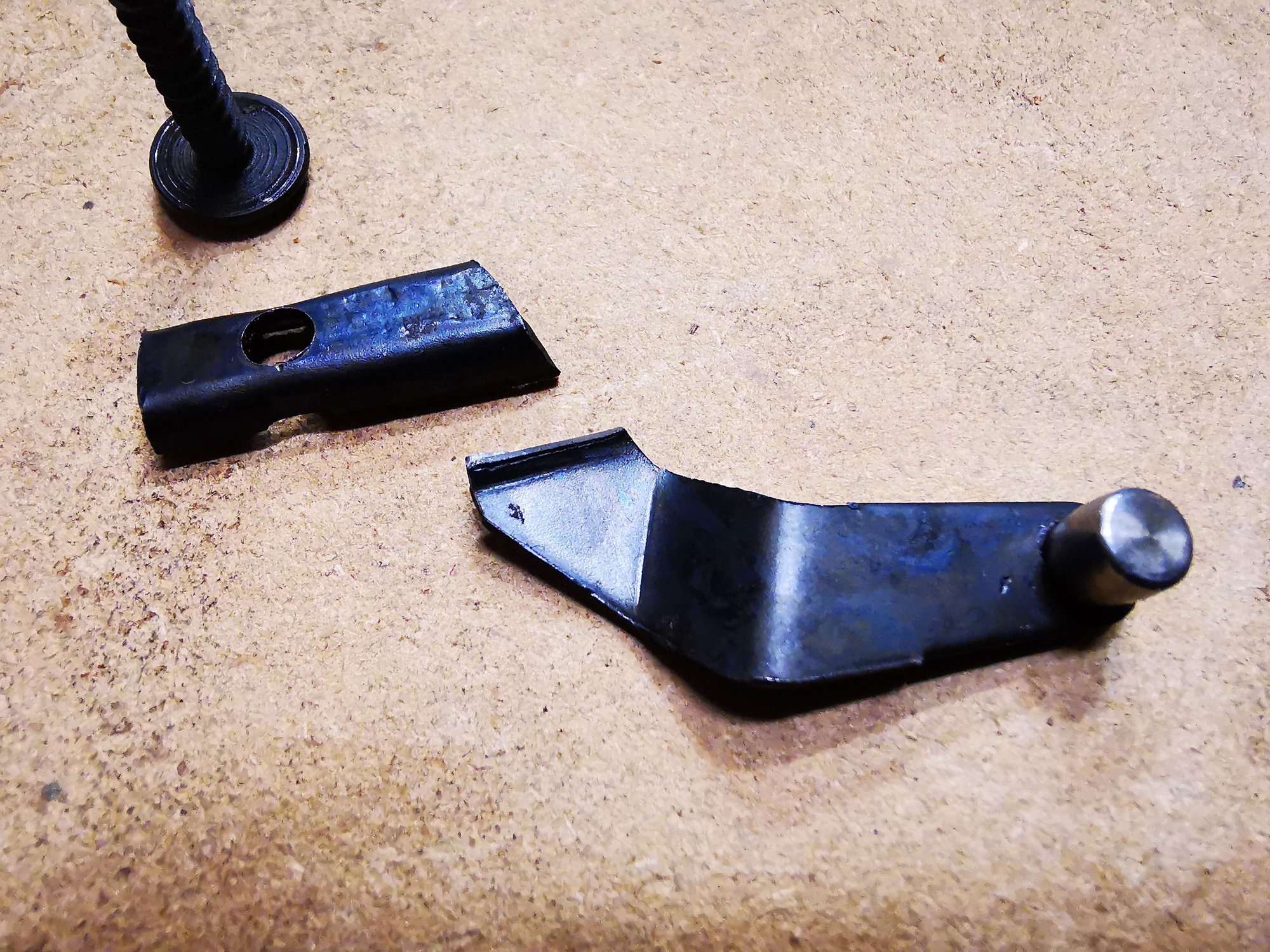

For anyone that finds this thread in the future, and needs help diagnosing the issue, this is what broke: The turn signal switch arm actuator [GM part #7827038]. (The part is only about 1.5" long.)

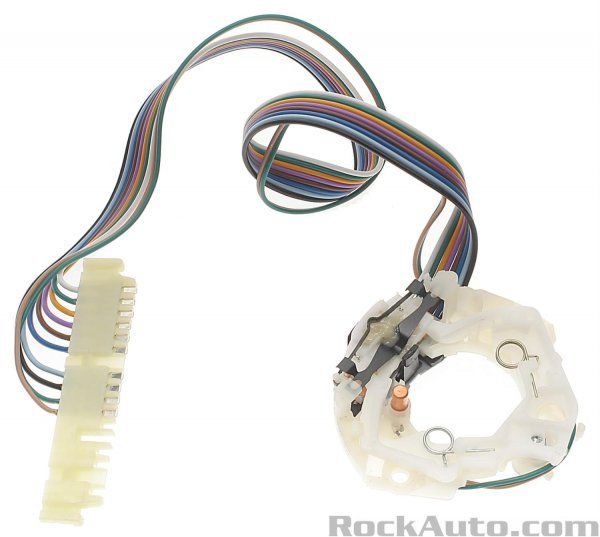

Since I already had the steering wheel and lock plate removed, and I had a new turn signal switch in hand (unfortunately, the actuator is not included), I went ahead and replaced that for now, and ordered a new actuator online for next weekend...when I will have to take everything off again to install it, since I need to drive to work in the mean time.
If the turn signal switch was more expensive, I might have just returned it, since my old one wasn't broken, but a new OEM GM one was under $40 on Amazon. By the way, I did not use the D6210A, I purchased D6262D since both were listed as matches and the latter was cheaper. From what I can see, only the color of the plastic, and one small tab are different from my original (so is the hazard switch, but it works the same). Now the silly little stamped actuator, which probably cost less than $1 to make, cost me over $25 to get new on eBay!
