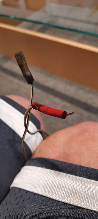

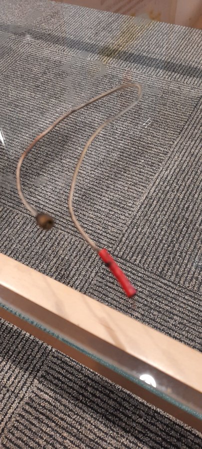

so i was trying to make wire loom for the drivers side o2 sensor plugs into longer.. the mass air.flow sendor plug, the air inlet sensor connected to the airbox lid, are also connected to this wire loom.. when i unwrapped the hard plastic that holds the wires togeather, there was a wire that was just like hanging there, i removed it and now my battery does not chage, and the alternater does not keep the battery charged.. where does this wire connect to.. thank you in advance..

My guess would be that is someone's prior bad attempt at an alternator exciter wire repair, which has now come apart.
