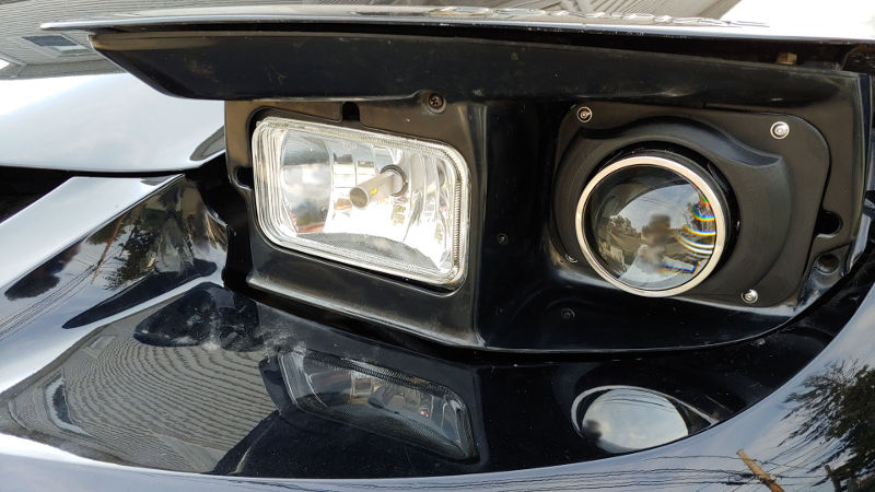

I don't have those headlights anymore so I can't check. I have Low Beam HID Projectors and LMC Truck High Beams now.
My current headlights...
https://www.fadingarrow.com/images/F...lted_SMALL.jpg
http://www.fadingarrow.net/images/Fi...lted_SMALL.jpg
