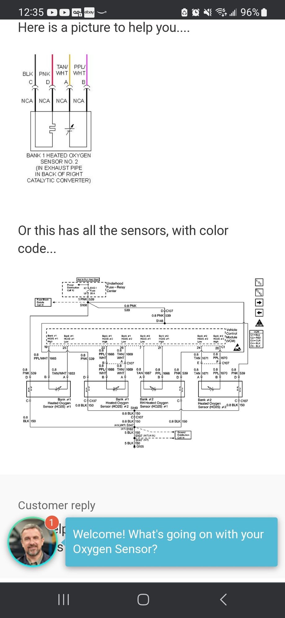

I just 1999 silverado 1500 5.3 lm7 that has bank 2 harness cut off trying to hook it back up all wires for each sensor are the same so I have 2 tan 2 purple 2 black and 2 pink trying to figure out which wire to which sensor mostly concern about the tan and purple they had different circuit for each the pink is the same circuit and black is ground
