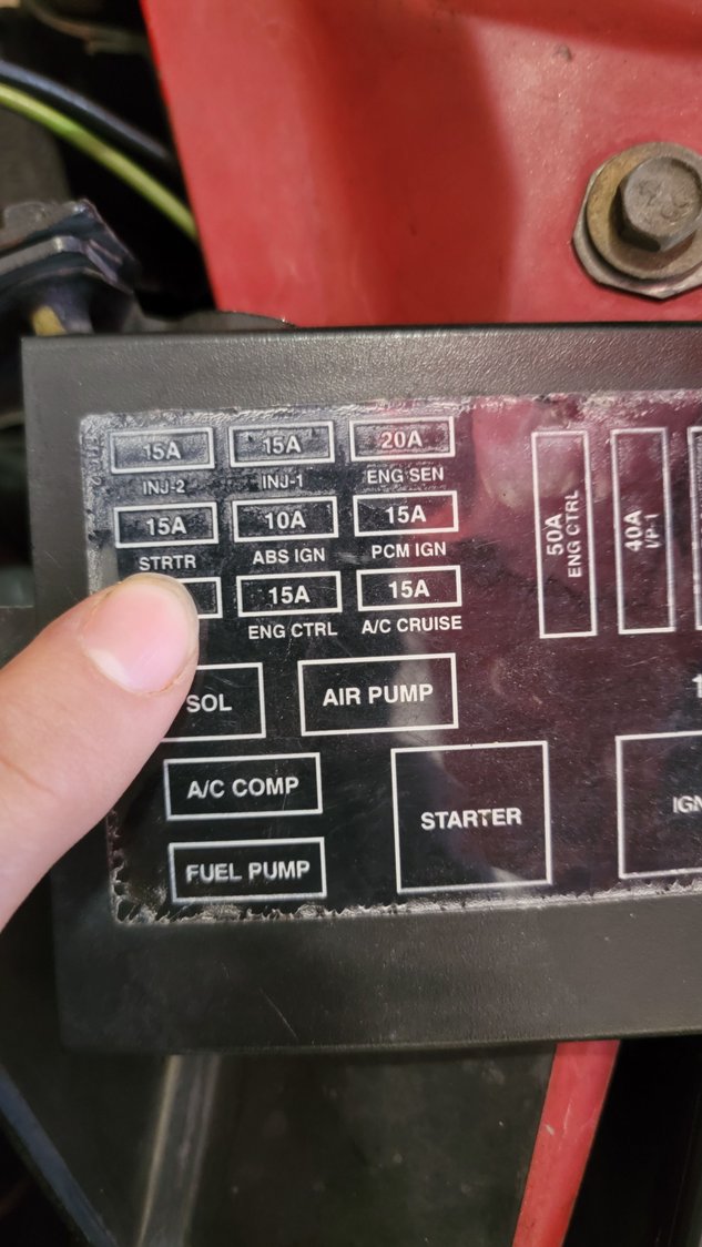

I am trying to add a killswitch and want to keep it nonchalant. I found a great spot that I would like to be using the stock fog light switch. But I have a couple questions. Is it even possible to use the DRL switch to power the starter relay without causing problems? I originally wanted to turn on the fog light switch and the daytime running lights to give power to starter then crank it like normal. One way that I have thought of is to splice the starter 15A fuse and run that through a relay and the foglight switch can be the power for the 86 in a relay. To me That's probably the way that I would do it or at least the way that makes most sense. New ideas or corrections is greatly appreciated.
