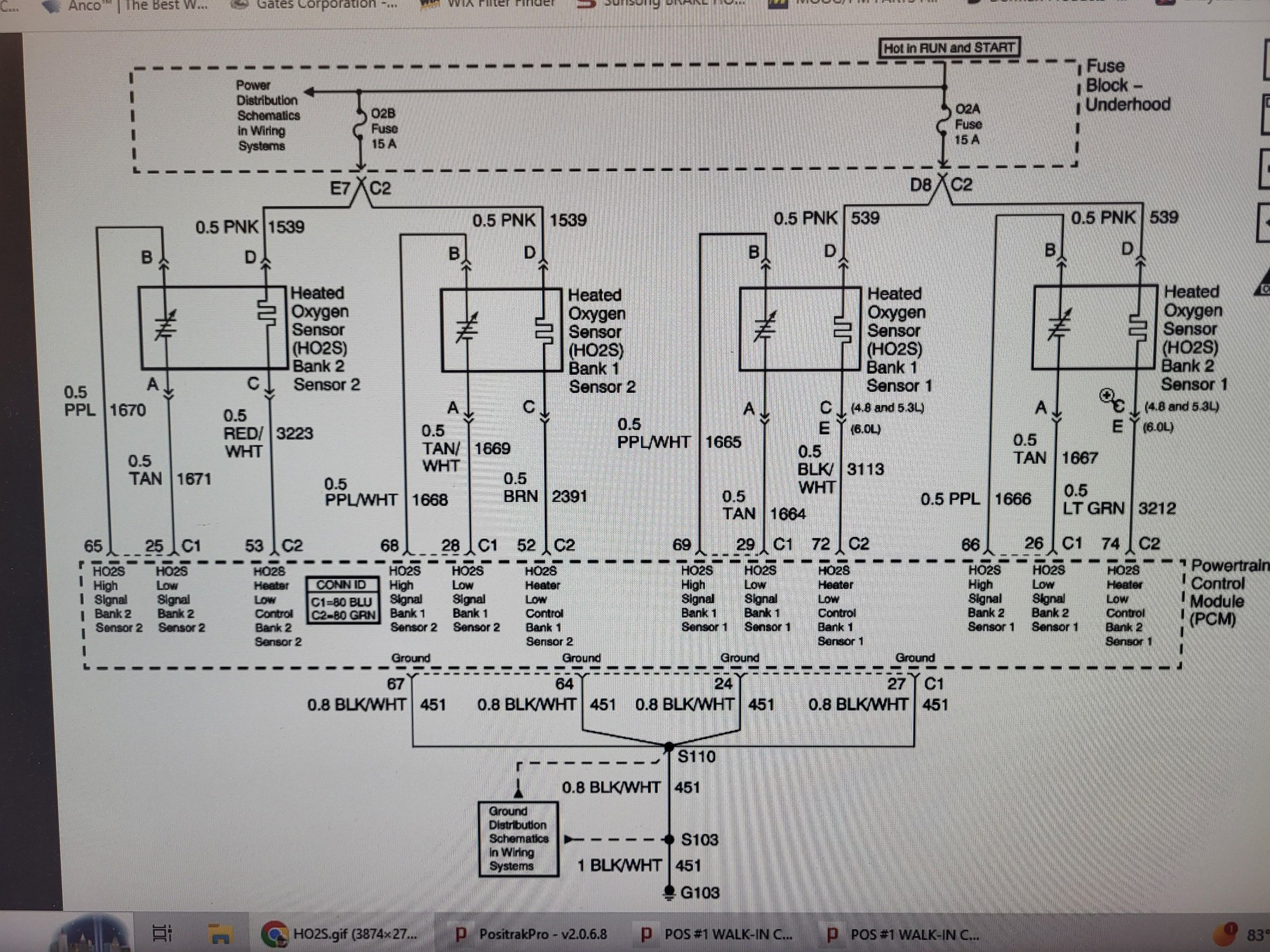

Look at the schematic, do they both share a common for the positive. Also there is a sensor fuse at the fender, IDK if the 02 sensors use it, but its worth a shot.
I see what you mean. Heres the schematic. They do share a 15a fuse and it says "underhood" but idk how to tell which one... so I will check all the 15s in the fuse box.
Apparently the share the pink wire too? The thing that gets me is that they read in HPT all the time with no issues. So idk how it could be the power but maybe?

I found the fuse. It is the engine sensor fuse. Which controls
MAF/HEATER CIRCUIT O2's/BRAKE SWITCH/SKIP SHIFT/REVERSE LOCKOUT.
Going to check that here shortly
