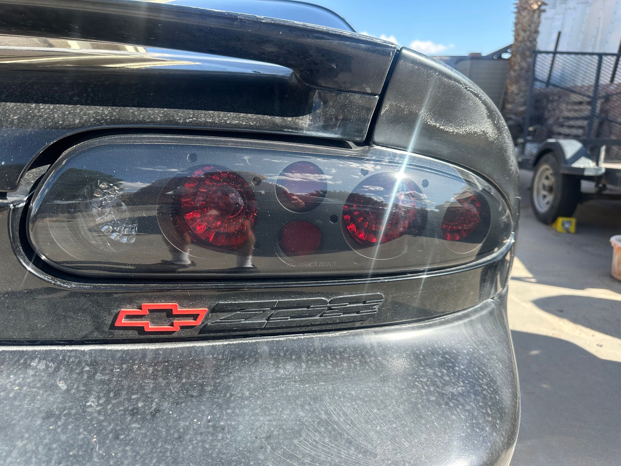

Hey guys I have a 2000 z28 Camaro A4 and the only electrical stuff that’s done to it is a new head unit speakers and a sub which have been on the car for past 10+ years except the head unit it’s been on the car for the past 3 months but up until now I’ve never had a problem with it but what is happening is when I lock the car the power accessory fuse blows every time without fail any ideas what it might be ?
also I never had a problem until I installed a new tail light housing which was about a month ago a few days after that the first one blew then it went a few weeks and now it blows every time I don’t see how it could be related but just giving the information just in case
also tail lights don’t seem to be working when it blows
PS: just found tail lamps fuse to also be blown

start at the spot where the problem began. pull the taillights back out and check all your wiring. you probably have a wire pinched behind one of the lights.
