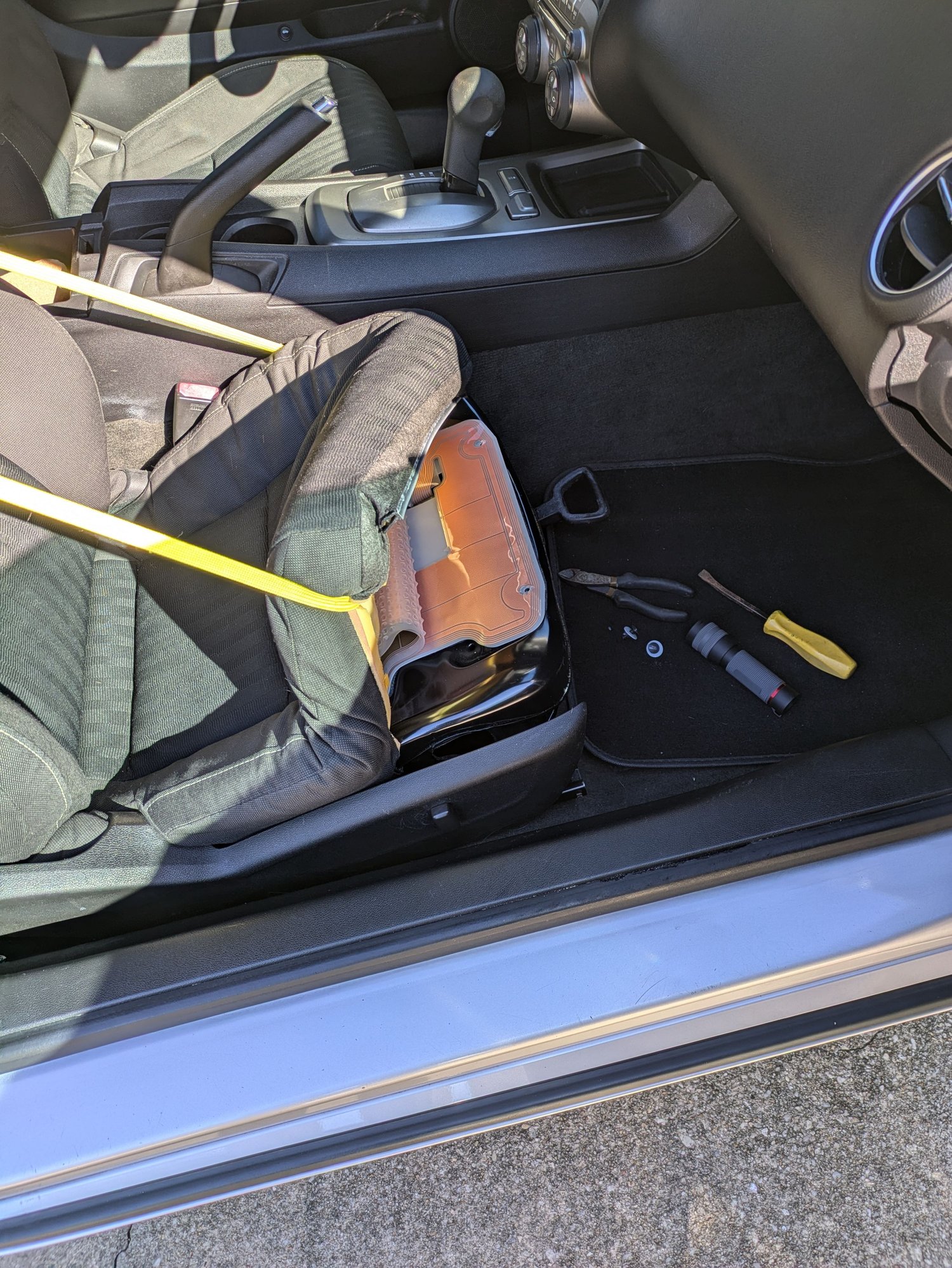

Hopefully this is posted in the correct section. Is there any hope of repairing damaged electrical traces in a passenger seat airbag sensor pad? This is a 2011 LS.

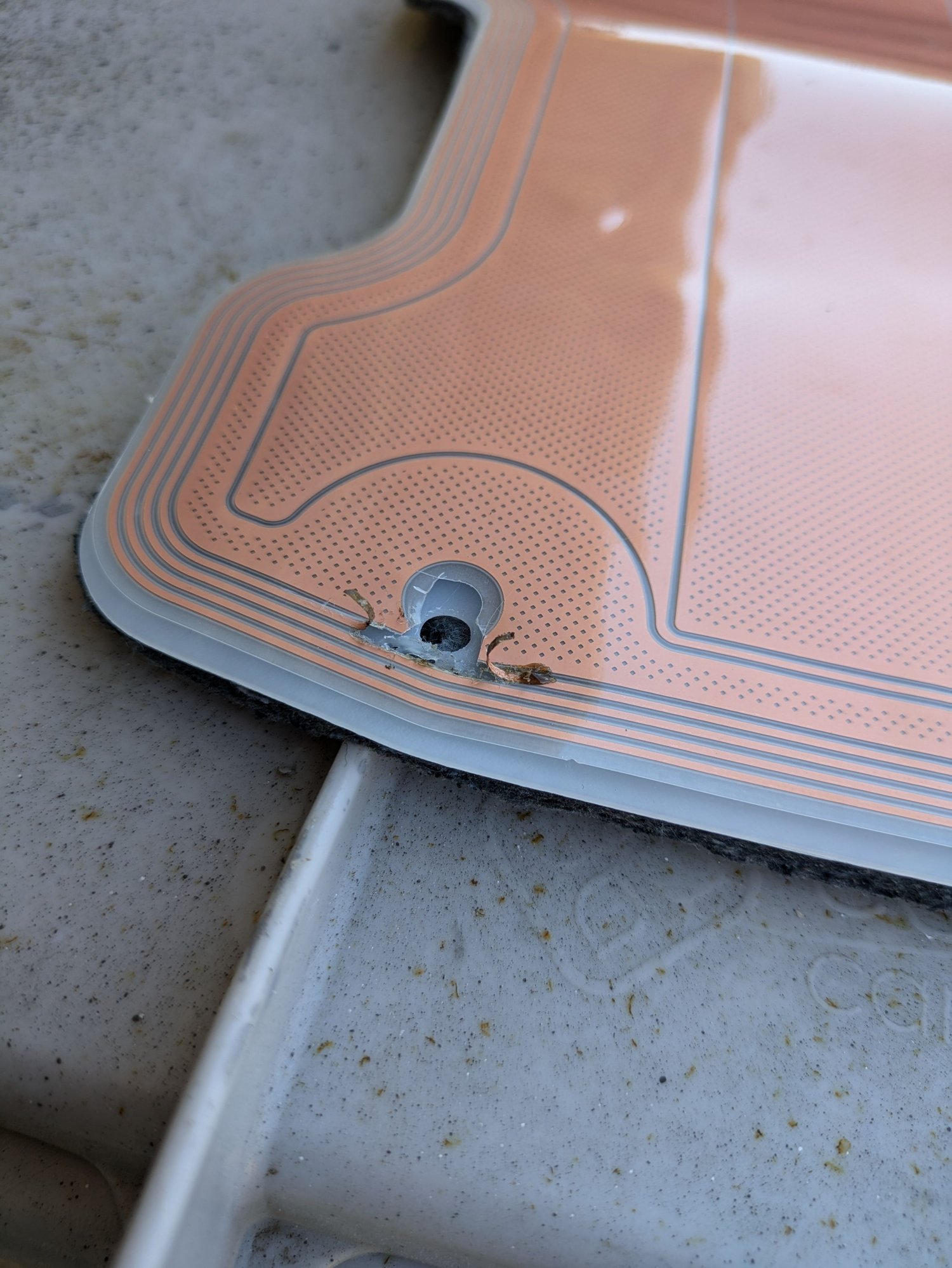

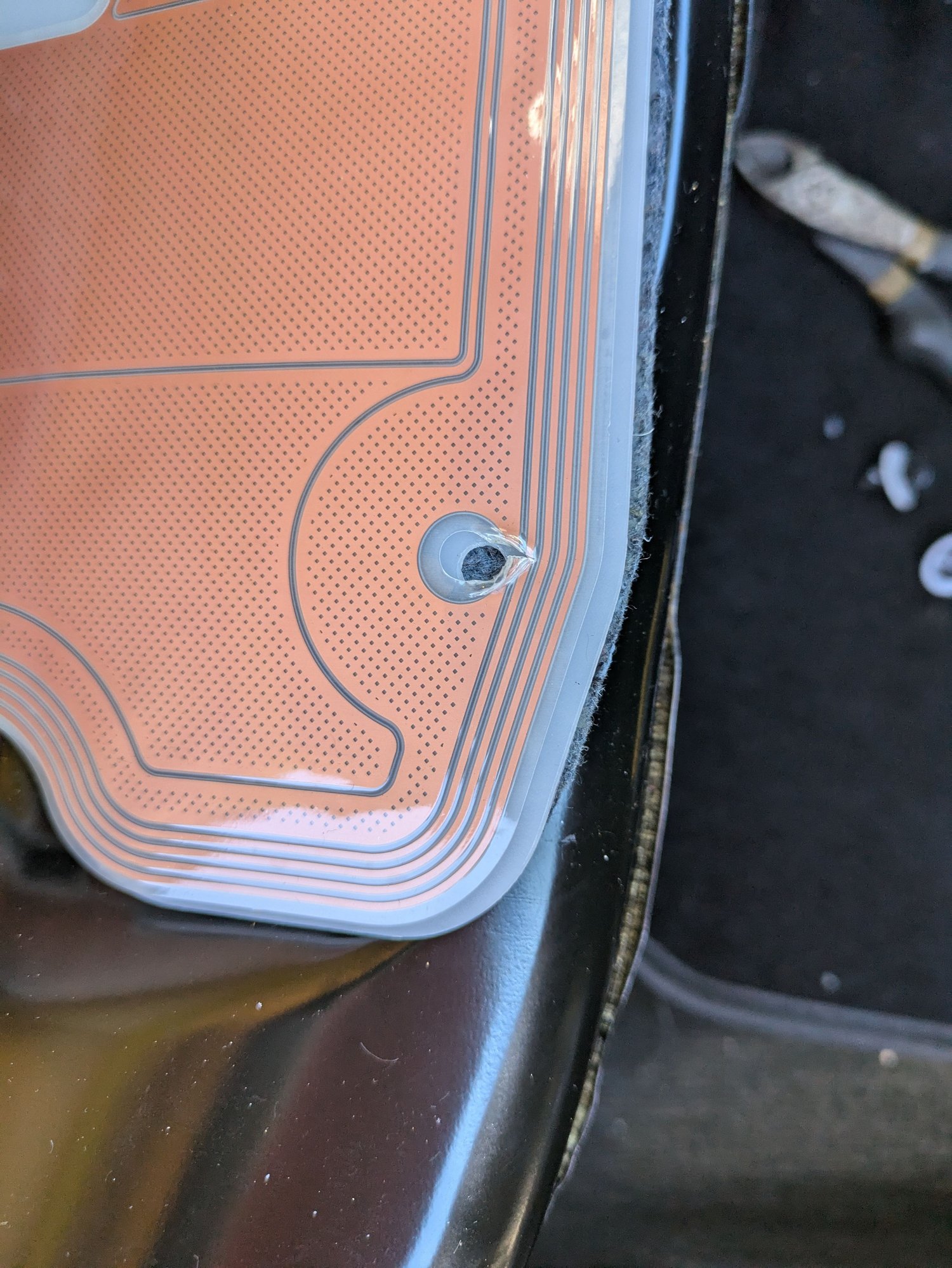

Guessing nobody has tried this. I have nothing to lose at this point so I gave it a go. Tried a heat gun first in a attempt to separate the plastic film, but that was unsuccessful. I then used a pencil soldering iron to melt the plastic film over the trace and was able to pull the copper ribbon free. I will fold the ends back down and use some copper tape to bridge the two ends together. A little silicone caulk and I will try it for effect. Probably use some duct tape to hold it in position in lieu of those plastic pins.

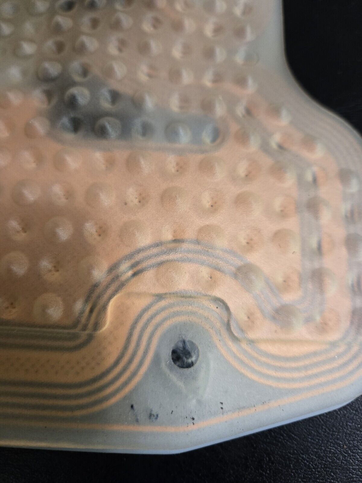

My attempt to repair was unsuccessful. Ended up purchasing another sensor pad off ebay ($135) and it took care of the problem. In the image you can see where GM had the vendor change the routing of the traces so that the retaining pins no longer rip them into.
