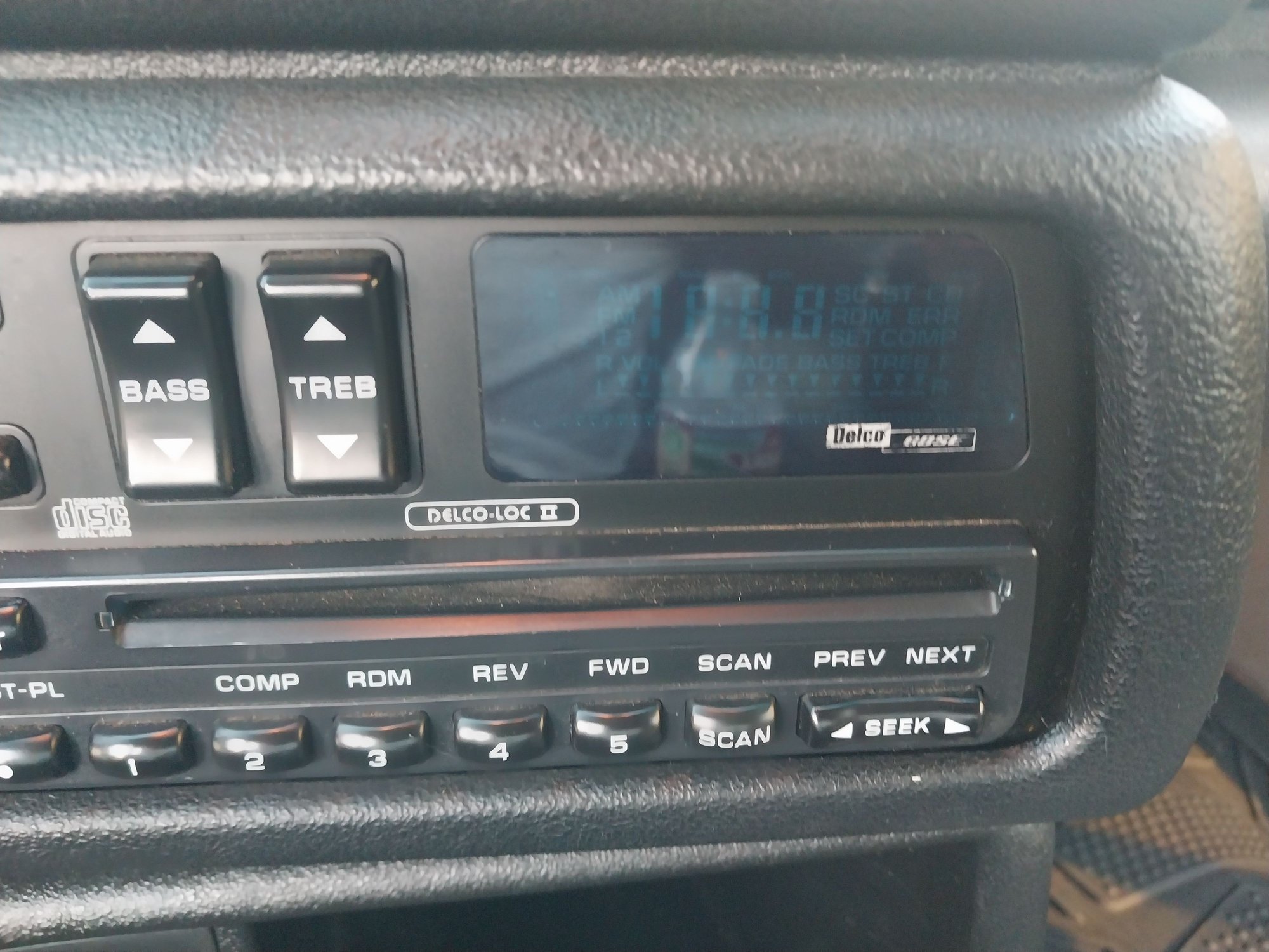

sjsingle1's Avatar

Yours is definitely the stock 93-96 camaro bose headunit based off that picture. Rock/hard place
