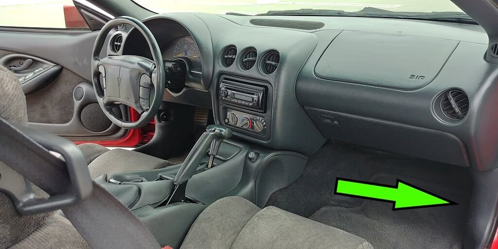

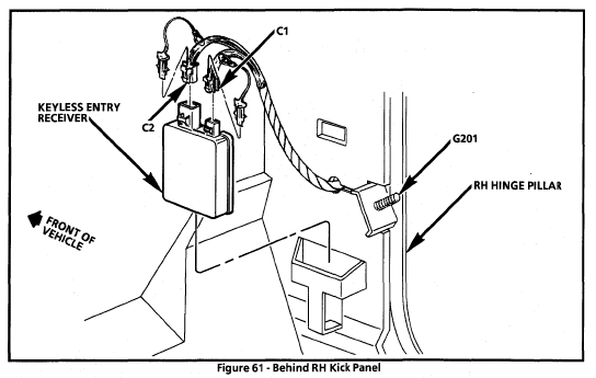

Where is the keyless entry module located and how do I access and/or remove it?
It is in the passenger side footwell behind the passenger side kick panel.
Once you remove that panel (four screws along the sill going from the front seating area to the rear seat by the seat belt anchor) you should see it sitting in a little pocket with two connectors at the top.

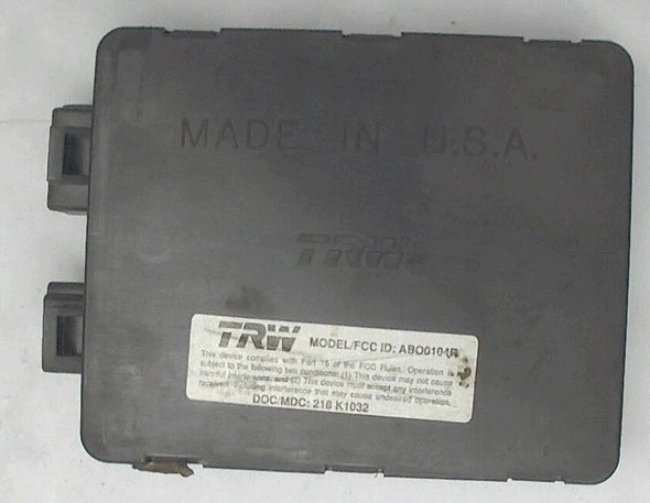

Disconnect the two connectors and then you should be able to wrangle the module out from the top. Once free it should look like this:
The FCC ID should say: ABO0104R (R for receiver)

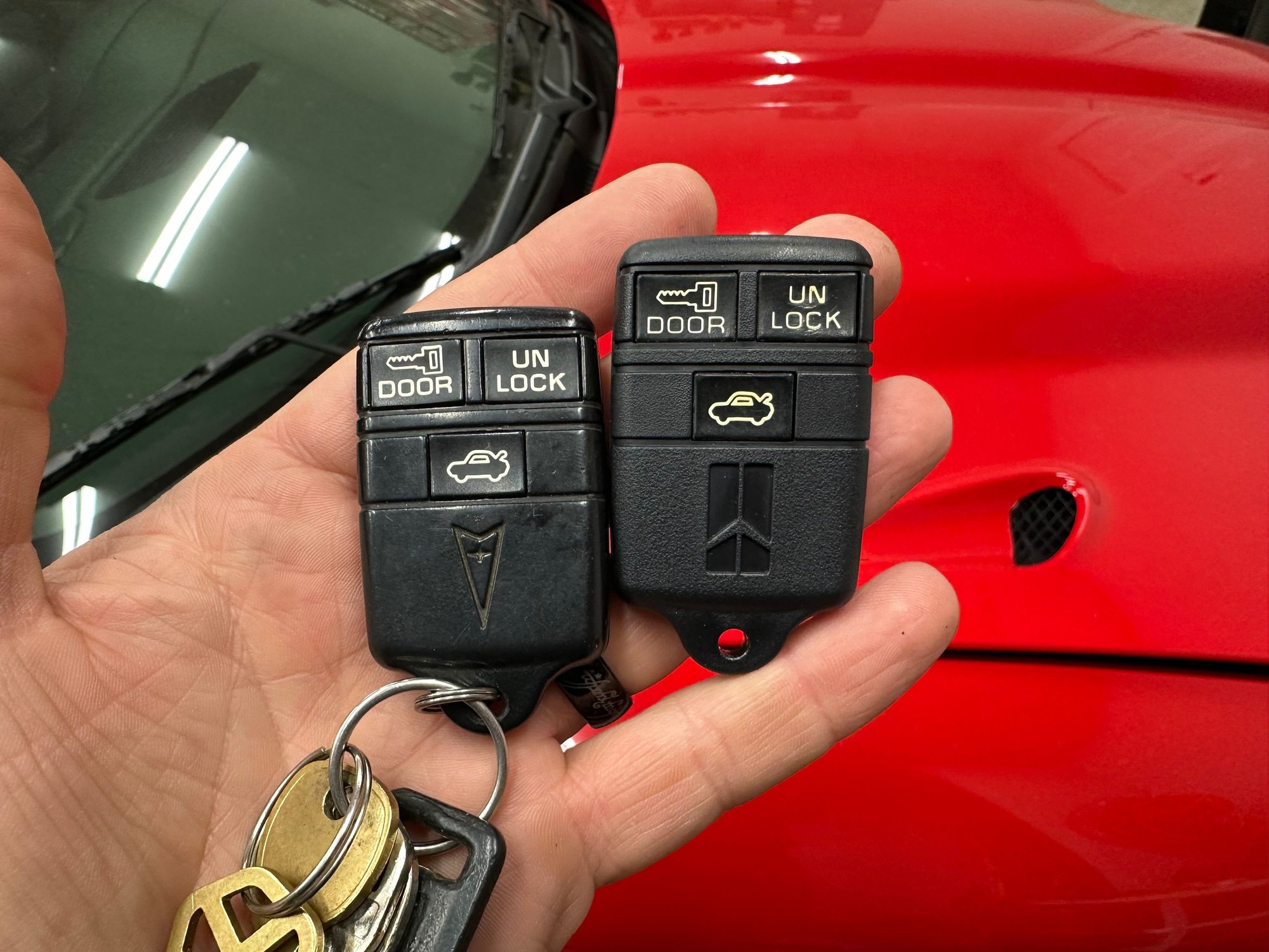

I don't have any key fobs....which ones will work with my car?
I show 12522339 as the GM part number from the parts manual. I have seen different ones on the rear of the remotes, so I'm not sure if that number is for the front part of the cover/buttons/board and the rear covers have different ones. I have seen many different styles show up when searching for that number though. Chevrolet, Pontiac, Buick, Oldsmobile, even blank. I tend to search by the FCC ID: ABO0104T (T for transmitter). Here is my Pontiac keyfob and a new, unused, Oldsmobile fob with the same FCC ID that I harvested the board from to make mine work (my used Pontiac ones had some corrosion on the board).

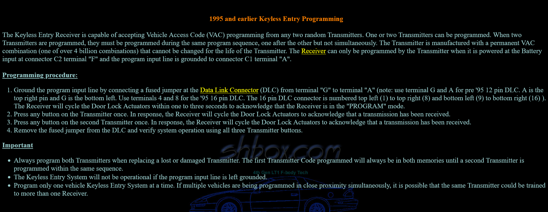

So I see the receiver in my car and I have acquired some fobs. How do I program them?
Shoebox from CZ28.com days has a great website HERE that outlines how to do it. I have snipped the information just in case his site ever goes down.

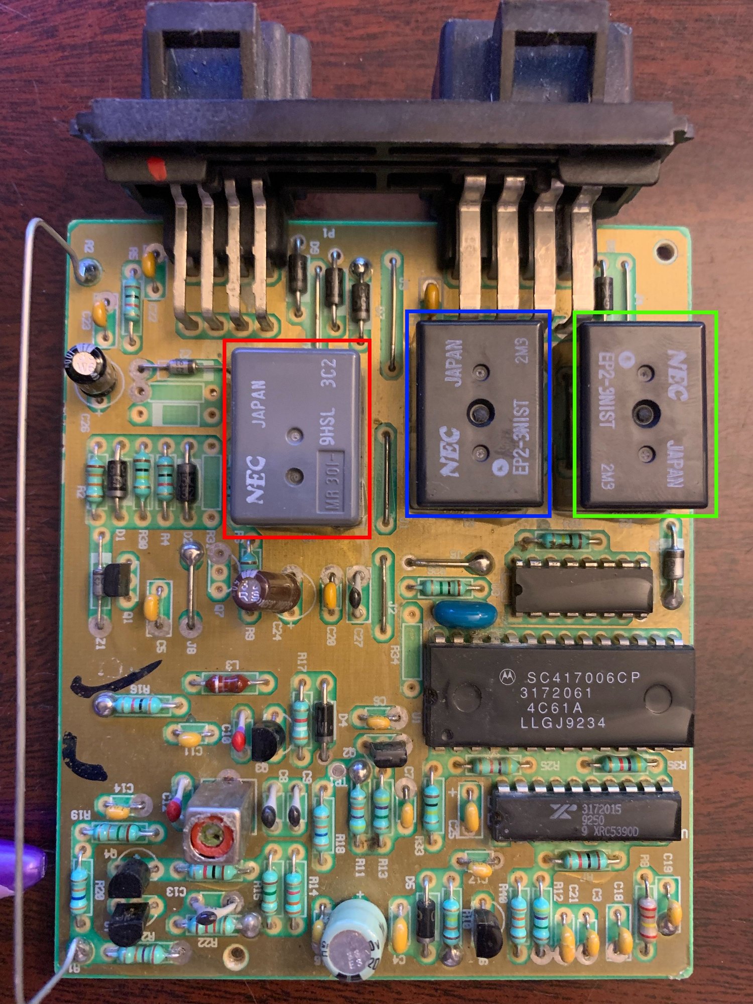

My car, when programmed, would release the hatch and unlock the doors, but the lock function would not work. I searched and posted for months and never got anywhere. Most people just advised replacing the module. It has been discontinued for something like two decades, NOS units are pretty much non-existent, and used ones seem to have similar (or worse) functionality. I decided to crack the module open and investigate. When you open the module case you will see the board:
After pouring over wiring diagrams in the factory service manual, I found the following information. The relay in red is for the hatch release. The relay in blue is for the unlock function. The relay in green is for the lock function. Whichever one of the functions is not working for you (as long as the board itself is clean with no corrosion or other crazy issues) likely it is the relay associated with it that is the problem. I am lucky enough to have access to a reflow oven via friends at my office, so I had mine run through and it worked! Well at least for a few months. Sometimes the relay innards can "stick" with age and the reflow process can help free them up. Unfortunately, the lock function stopped working on mine again, so I decided to look for a replacement relay online and swapped it in. The relays used for the lock / unlock functions are apparently notorious for having issues. They were used in other units for other manufacturers and have a poor reputation for reliability in those as well.
The lock / unlock relays are: EP2-3N1ST
The hatch release relay is: MR 301-9HSL

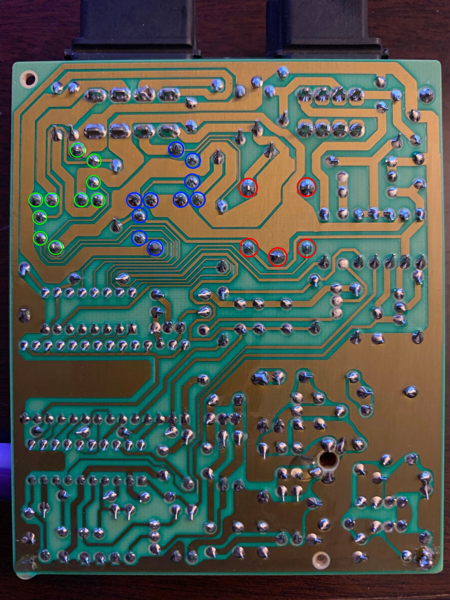

You just need to remove the solder from the back of board for the affected relay, pop in a replacement one, and then re-solder the new relay in. Here is a picture of the back of the board with the pins circled for the relevant relays:
Replacing the lock relay worked for me and my keyless entry system has been functioning properly ever since! Hopefully this information helps others who may come along in the future and good luck with getting your factory keyless entry system working again!
