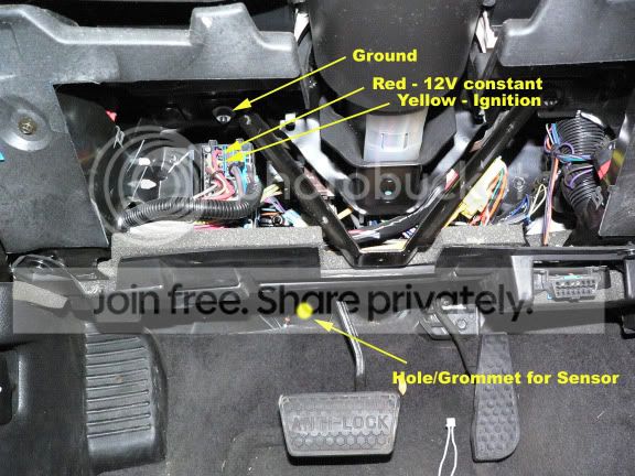

Besides behind the PCM, where else can I throw some wires through the firewall?

There's got to be some other threads on this.
But I recently drilled a hole just behind the brake pedal and popped out under the master cylinder booster...
