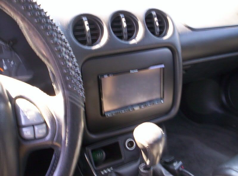

where can i go to host pics i will put some tonight i have the flip out one!

Old Oct 8, 2006 | 08:27 PM
ProjectKronos's Avatar
Posts: 77
From: South Carolina
That looks pretty sweet, ya gotta love it!
I just noticed, but you have a lot of toggle switches...care to elaborate?

lol yeah top is cut-out and the 2nd is my fan and 3rd is going to be nos and last is my amps and stuff!
