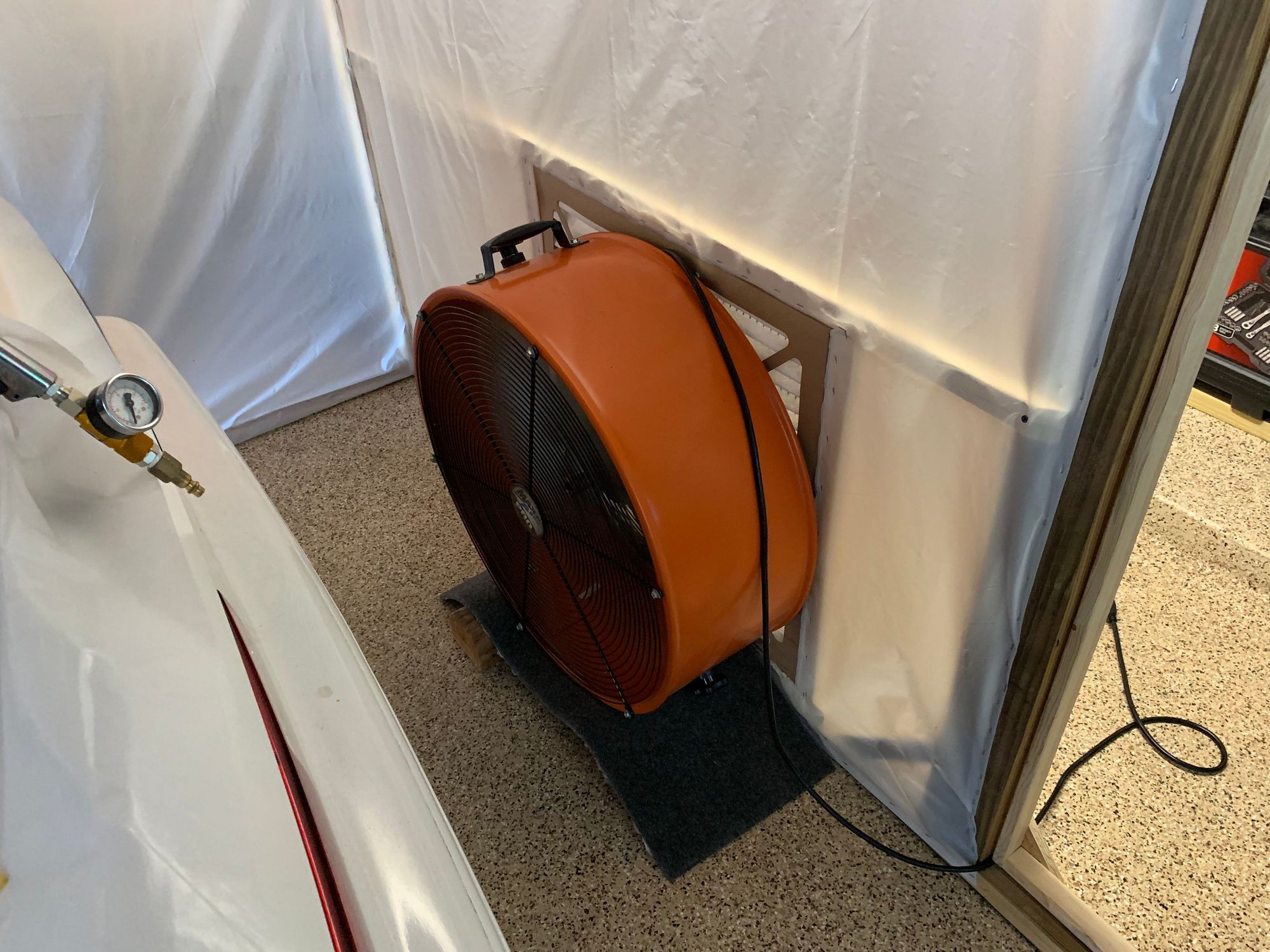

As much as I wanted this barrel fan to be outside of the booth, electric fans are much more efficient at pulling air than they are at pushing air. I tried using it as a pusher and it pushed only about half as much air as it did pulling!
