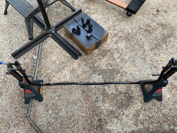

Here is the rear anti-sway bar and painted front anti-sway bar brackets. I put long bolts through the mounting holes of the anti-sway bars. I was able to rest the bolts on top of the jackstands and that way I could paint all around the bars and not have to lay the painted bars down and mar the finish.
