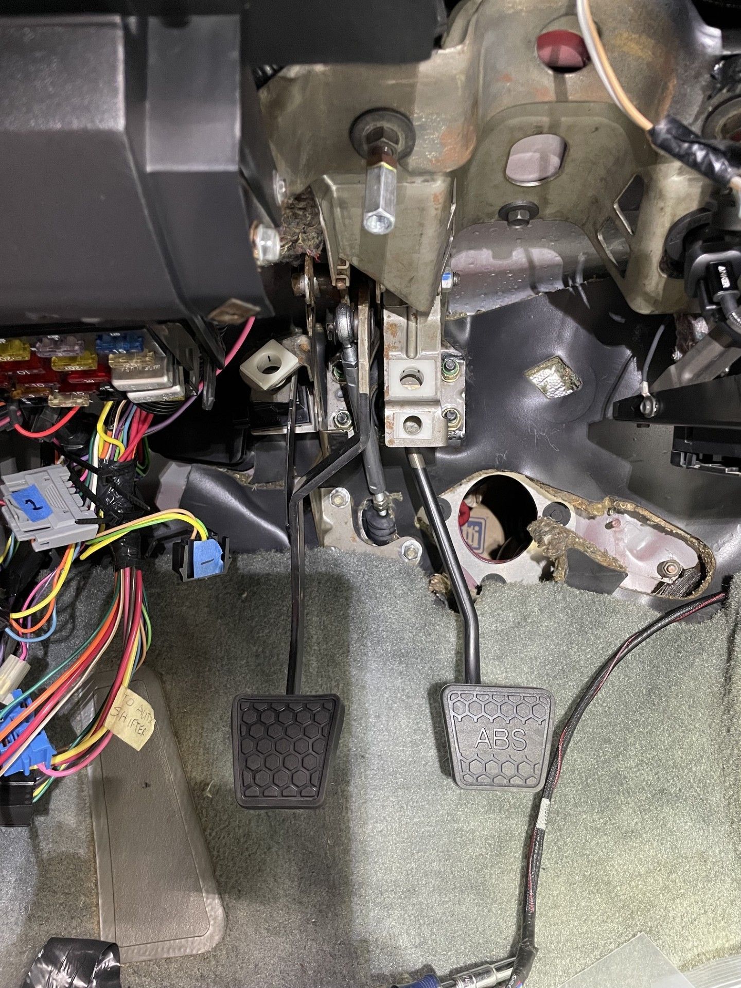

You can see the clutch MC rod in the center of the picture. It's easy to notice that it is not perpendicular to the mounting pin sticking out of the side of the clutch pedal. Pushing on the clutch pedal puts a lot of side force on that small locking clip.
