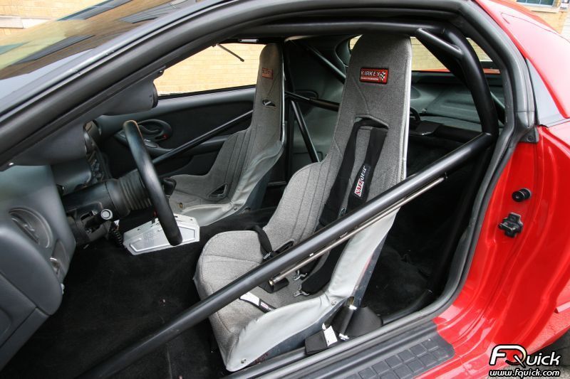

Playing with shift points vs power curve
Not tempted to round up a Kirkey or other drag seat and make some runs with just that seat in the car? 10.04... so close
