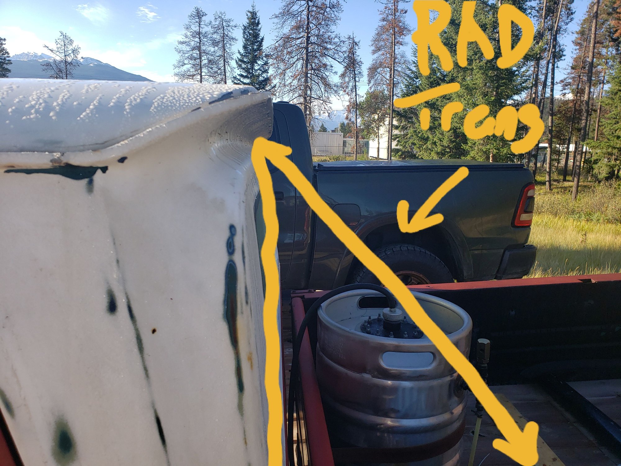

Hey fellas, i used the search feature and found some amazing builds which i got lost in for hours but had zero information beyond some random dude suggesting a roll bar mounted rad. So i put it to you guys, i got a 1965 C10 that i am building a roll bar for, i want to mount my rad/trans cooler on a roll bar, but have heard conflicting information about thermals. so i decided maybe if i put a scoop/air ram to a shroud covering the rad it would perform better... then i thought about when i wasn't driving or in traffic, said shroud/air ram may screw my thermals even more. so i ask if any of you have information, know of threads or even just suggestions i would love to hear it. Thank you in advance. shitpic of what i mean.

I have seen them mounted high on toolbars for rock crawlers and some side by sides. Fans and a shroud should help in low speed/stopped.
I think an issue may come up with lots of highway driving. No protection from junk

Yeah, in that location you're very dependent upon the fans so get some excellent fans.
