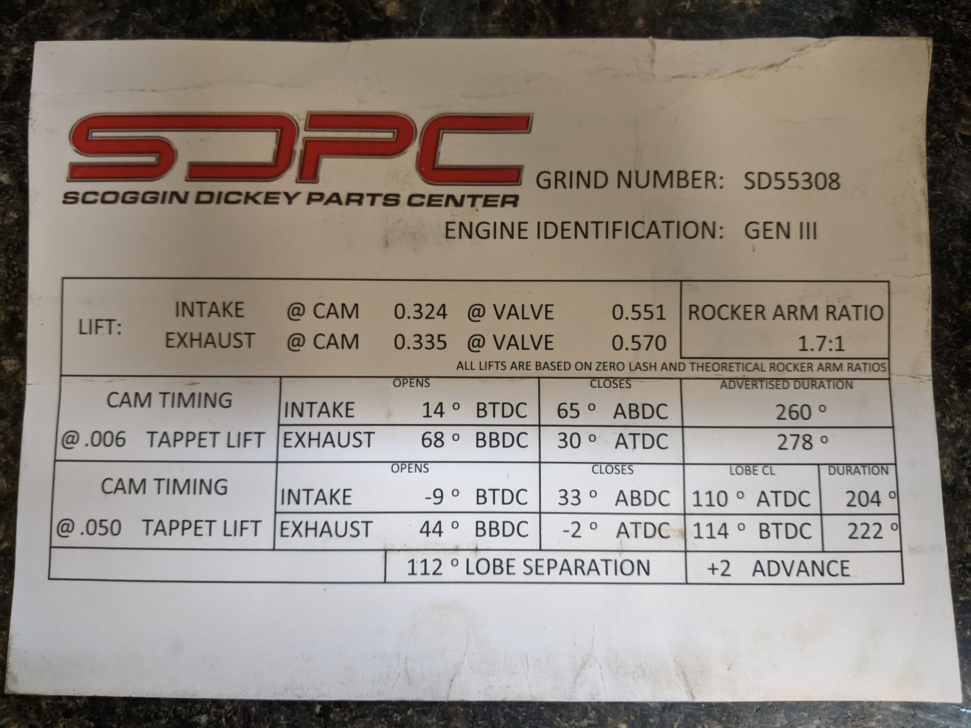

This and the GT 2-3 are a bit unique. I get the impression the GT 2-3 was designed as an "LS6 with more". They took the late LS6 (204/218,.555/.551,117.5 ) and gave it 2-3 more degrees on both sides, a nice chunk of lift, and another degree of LSA. They ended up within a degree of negative overlap, and an IVC 2-1/2degrees later. A buff version of the late LS6, hiccups included.
The LS6 Powermax, on the other hand, went in a bit of a different direction. They added even more exhaust duration and lift, BUT sucked the LSA way down to 112,and advanced it a couple degrees! From -24 O/L to -11 O/L and a nice 32 IVC (from 39.5).
I think the Powermax should outperform the GT 2-3 by a fair margin.

Ls6 power max camshaft card
LS6 Power Max cam card
Put this in your valve event calculator G These are asymmetrical lobes super high-tech engineering advanced stuff I didn't find the card anywhere else online so here it is
