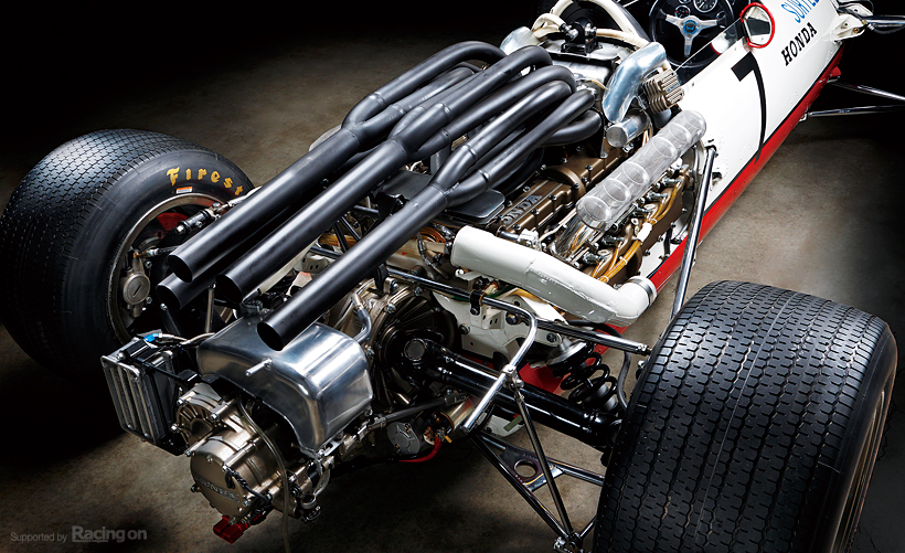

Something reverse flow like this maybe...
Kind of like that, but I had not thought of putting 2 of them together. Might be a packaging problem in a street car, lol.

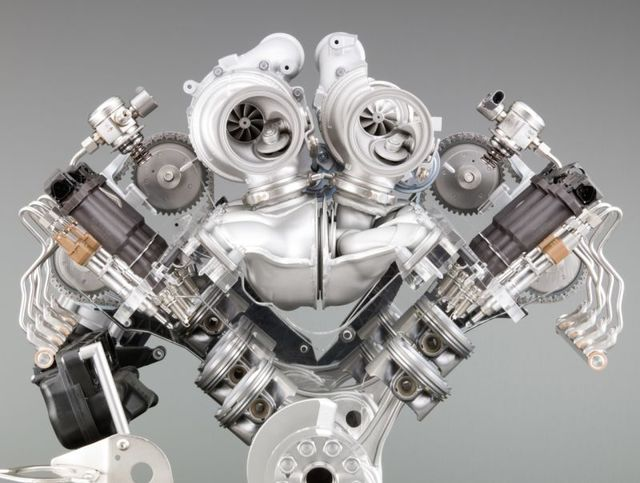

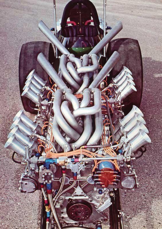

Reverse-flow-engines-are-my-new-obsession has several very cool pictures and some interesting information. A few samples...
