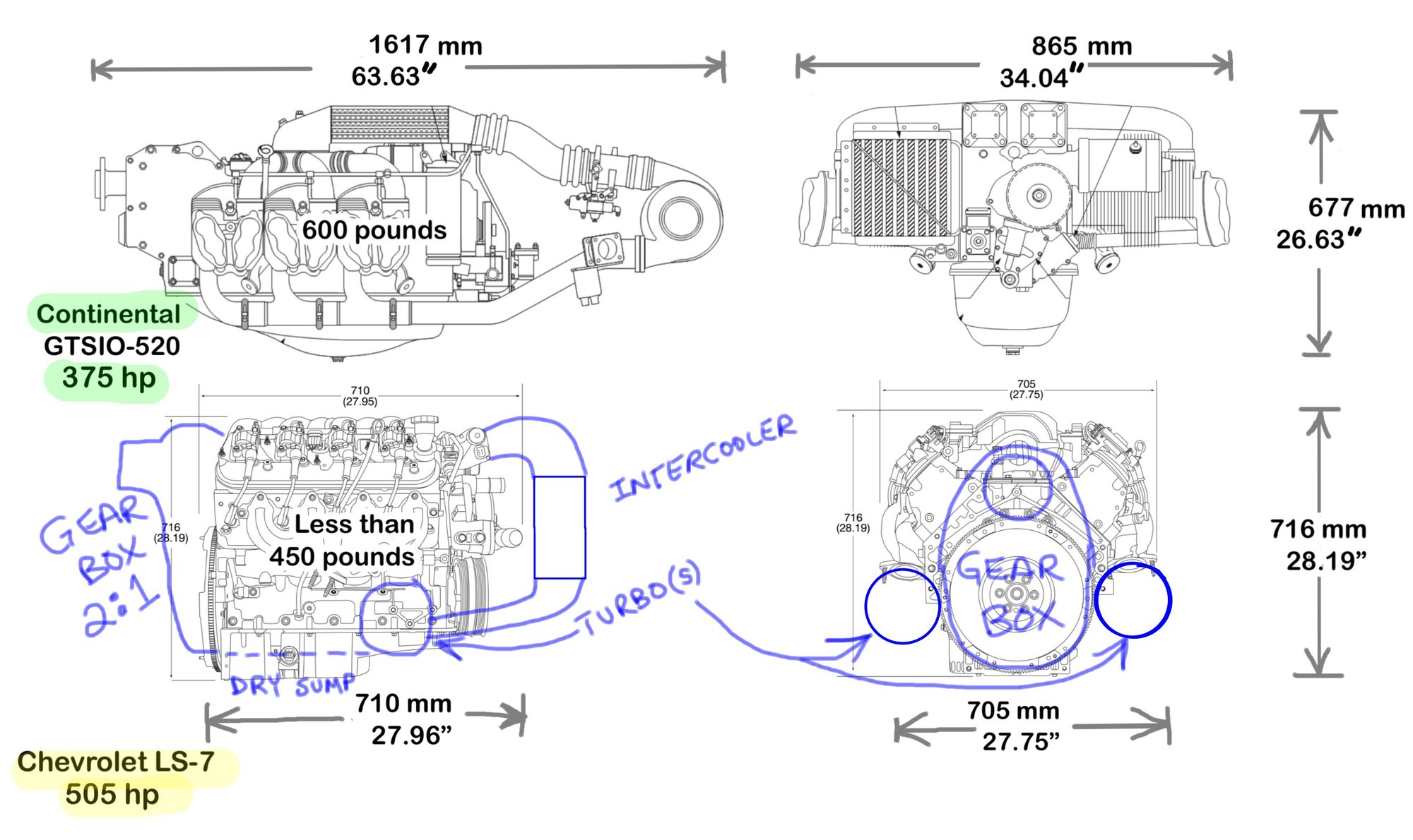

I’m working on an aircraft engine project, with the parameters listed below. I’d like some feedback on a SOHC modification to the LS engine. It would be quite similar to the LT6 and LT7 series of engines, with a “Finger Follower” under the cam.
The camshaft on each cylinder head would be gear driven.
This engine is for a propeller driven aircraft, with the following engine goals / aspirations:
1) 90 degree V-8 piston engine, spark ignition, 4.4” bore spacing
2) 336.7 inches3 up to 388.4 inches3 = 4.060” bore (103.57 inches2) x 3.25” up to 3.75” stroke
3) 500 hp @ 5000 RPM (or less)
4) 250 HP (50%) 325 HP (65%) @ 3800 RPM +/- 500 RPM
5) BSFC of 0.38 pounds fuel / HP / hr (about 15:1 AFR) at 50% to 65% power
6) Two turbochargers - when one turbo could seize or explode, the other can still work, plus electronic controlled wastegates
7) MAX altitude = 25,000 feet (about one third sea level ambient air pressure)
8) “Critical” altitude = 18,000 feet (one half ambient air pressure) - Maximum rated power available up to this altitude. The turbos would be at maximum “boost”
9) Intercooler(s)
10) SOHC
11) Gear driven items that “cannot fail”… cams, mechanical coolant pumps, mechanical fuel pumps, at least one small alternator for engine controls, prop govenor
12) Belt driven accessories - hydraulic pump, vacuum / air pump, air conditioning compressor, main alternators, any other accessories
13) reversible direction of output shaft (for counter-rotating propellers)
14) 2.2:1 reduction gear box with quill shaft
15) 650 pound target weight, OR LESS
16) Small, compact size

Number 16 is already well accounted for with the gen3 LQ9
Number 15 is your overweight solution in search of a problem.
2 valve pushrod LS motors are durable, efficient, lightweight and make plenty of power through your stated RPM range.
SOHC brings weight, parts count, and NO advantage to the party.

We don’t need to make “plenty of power”… we need to make 500 hp, and no more. The time limit at 500 hp is 5 minutes, or less. 95% of the time, the engine will run at 50-65% power.
I’m not sure why you think that the engine is overweight. It will be whatever a typical LS engine with an AL block and heads weighs. The target is 650 pounds (or less). You’d be surprised how quickly all the bits add up in weight.

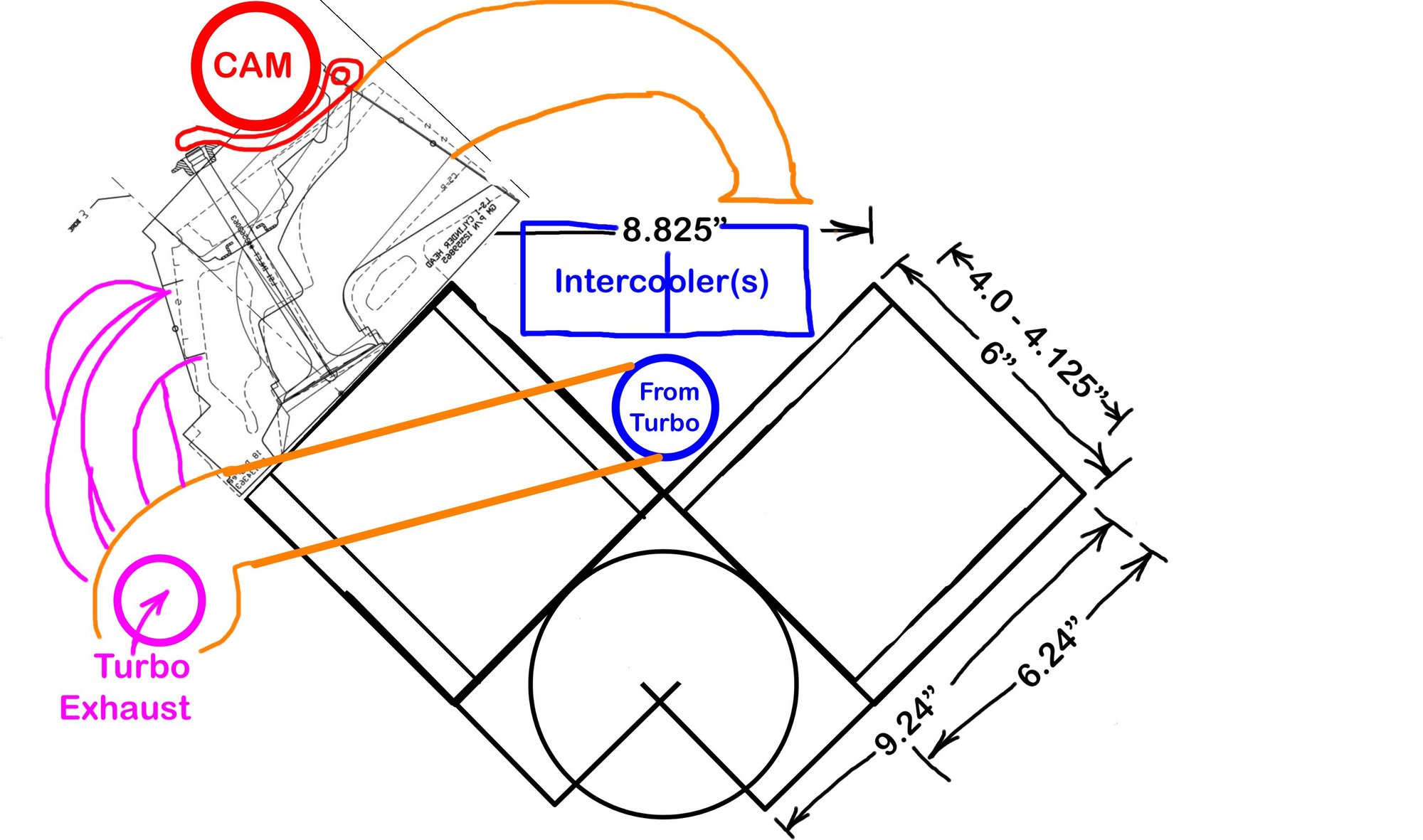

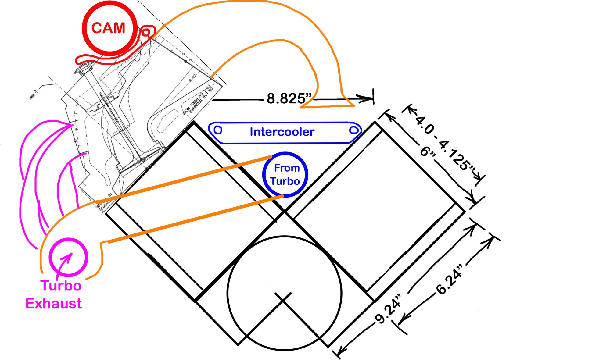

Also I dont think the V would give you enough room for what you’re wanting to do.
I didn’t spend much time looking, but I found an intercooler core size: 9.25"L x 3.5"x 3.5" in the first few minutes of looking. I could LITERALLY fit four of those in the V space.
https://www.siliconeintakes.com/fron...ler-p-209.html

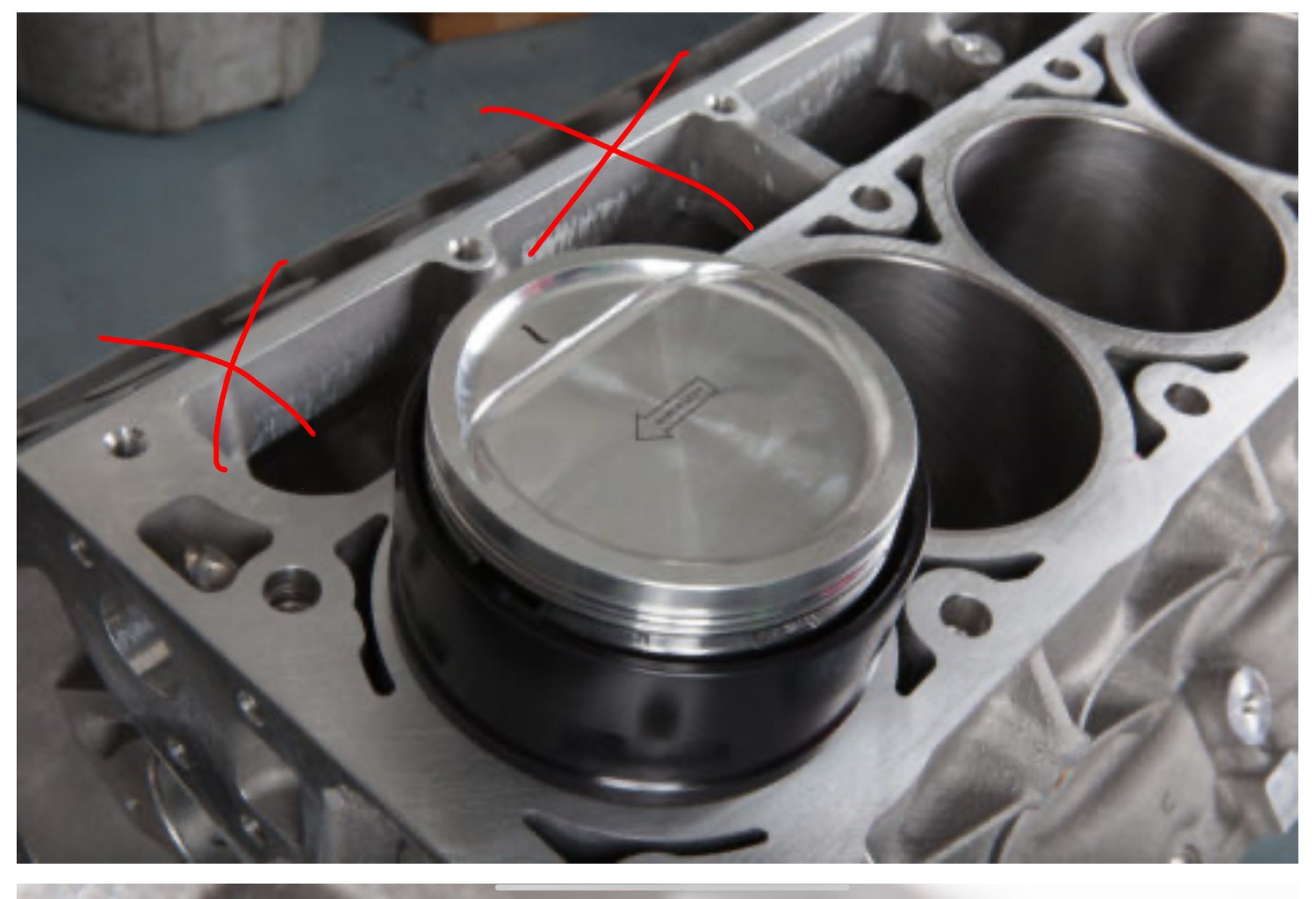

See attachment of all the metal that we don’t need with our SOHC:

Are you planning to make your own blocks, or plug the lifter oil passages in GM blocks?
Are you planning to make your own heads?
How will you get oil up to the cam bearings, lobes, and followers?
I really have nothing to offer, other than curiosity.

This SOHC concept is intended to lower the complexity AND parts count of the original LS design. Do you know what never fails, doesn’t cost anything, and weighs nothing in an engine? Stuff that isn’t there!!!
1) No camshaft chains, nylon gears, and some of the other stuff from GM
2) No lifters, no pushrods, no lifter guides (48 missing parts)… yes, these parts BREAK… always have, always will
3) Lots of aluminum not needed for lifter control. There is a surprising amount of AL used for support the lifters.
